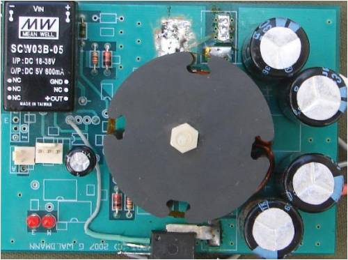

I posted a pic of a pcb last year on the MPPT thread. This pcb is what I have adapted for my latest design. This is only a boost type design at present.
A Windmill is not a devious machine. The power output is dependent on matching the load to the available energy extracted from the wind. The energy extracted is related to the wind energy at the blade optimum TSR.
The wind energy is known in relation to windspeed and it is a cubic relationship. I have essentially broken the graph up into many small sections and allocated a pulsewidth to each section. The increment component is the current, that selects the appropriate pulsewidth. An adjustment is made to the pulsewidth proportional to the load voltage. This allows the transformer action of the inductor to better track the windmill generated voltage to load voltage ratio.
I am using a formulae to calculate the increment steps at present. As long as the windmill is never overloaded, a better than 90% matching can be obtained. The limiting factor is the integer maths and PWM output increments available. This is why the analogue solution still gives a slightly better loading, but the digital solution is far simpler to set up.
If the windmill is overloaded, then the same situation occurs like if the stator is mismatched. The blades will require more wind to increase shaft power.
I intend making another test board. At present my only testing is on the power supply, as there is little wind. I am expecting gale force wind on Wednesday. Some windmill testing can come after that. Gordon.

Here is a photo of my 8-28V, 15A boost maximizer, top side, PCB. The bottom side is published on the original MPPT thread.
The double sided PTH PCB has the input and output filter caps,[each 2x3300uF/35V], the SMD Mosfet switching device,[160A/60V], the SMD shottky diodes,[2x20A/60V], potcore inductor, 5V & 12V power supplies, Alegro Hall effect current sensor, SMD picaxe 08M, buffer and SMD mosfet driver, voltage sensing divider, indicator, etc.
I have had to spend a fair bit of time reprogramming in situ, trying the various mods as the mill was flying. It is highly probable that my code will perform badly without mods on another windmill. I will test on my F&P mill before I am prepared to release it. This code on my windmill does load close to a cubic power curve, until furling starts. I am planning to run my F&P mill as a boost arrangement as well. If the mods for my F&P are minimal, the unit will probably work the same on any windmill that had a high cutin speed. .. .. Gordon.
