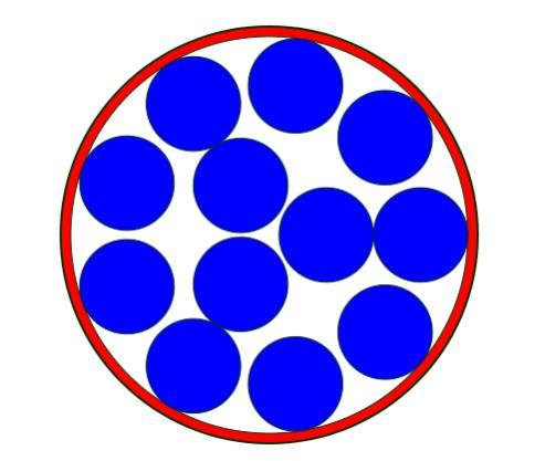

There is a curious mathematical property of circles that may come in handy knowing, when planning how many turns per layer will fit on each layer, particularly for a multilayered secondary.
As you add layers, the hole size obviously becomes smaller, and each additional layer has to fit into a rapidly shrinking circumference.
If everything is perfect, each additional layer will have room for exactly six less turns than the layer directly underneath.
If planning to wind on four secondary layers, the fourth inner layer will only have room for 24 turns less than the first layer.
Amazingly this odd effect is independent of both toroid hole size or wire diameter.
Here is a fairly dramatic picture to illustrate this with huge wire.
If nine turns will fit onto the first layer, six less turns than that are all that is going to fit onto a second layer.
With very fine wire. if 180 turns would just fit onto a first layer, expect to have room for only 174 turns on the second layer, and 168 turns on a third layer, and so on.
Prove it yourself with a bag of small washers arranged around inside the rim of something like a large paint can.

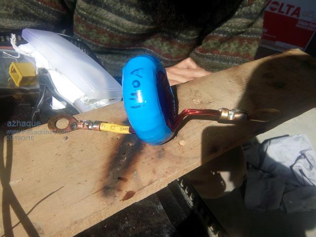

My question is therefore as follows.
Since I already have the E-I transfo built, what are the design parameters of the choke that must be added in series with the E-I core to reduce the no load current.

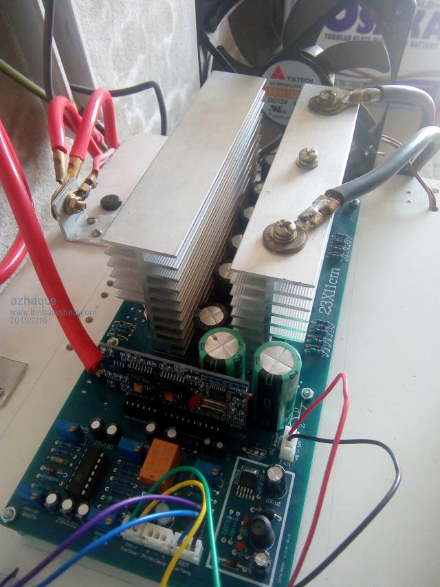

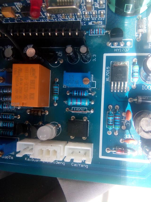

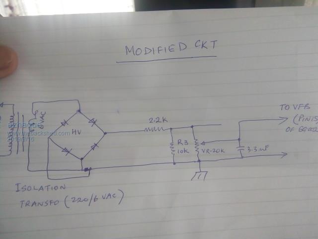

A bit of background. I have used a Chinese inverter board for designing my inverter. The design notes on the aliexpress website indicate that an E-I transformer would not need a series inductance choke. Now after construction of the inverter I have found that a choke is NECESSARY. I am now trying to read up on the theory of why a choke is necessary for reducing no-load current. Maybe ClockmanFr or Warpspeed or others can dilate this point further.
Additionally what is the best and most cost effective method to build such a choke. Will it be iron-cored or ferrite or air? My engineering sense tells me that Iron is out because at 150KHz or so, Iron would probably be useless. The one that is being marketed by the Chinese inverterboard maker is ferrite and its inductance is 47uH. How is this value calculated, is not mentioned on the page.
I ask these questions because I would like to add a spreadsheet for the choke design, into the transformer design excel spreadsheet. This would make the SS much more wholesome and useful for the backsheders like us.

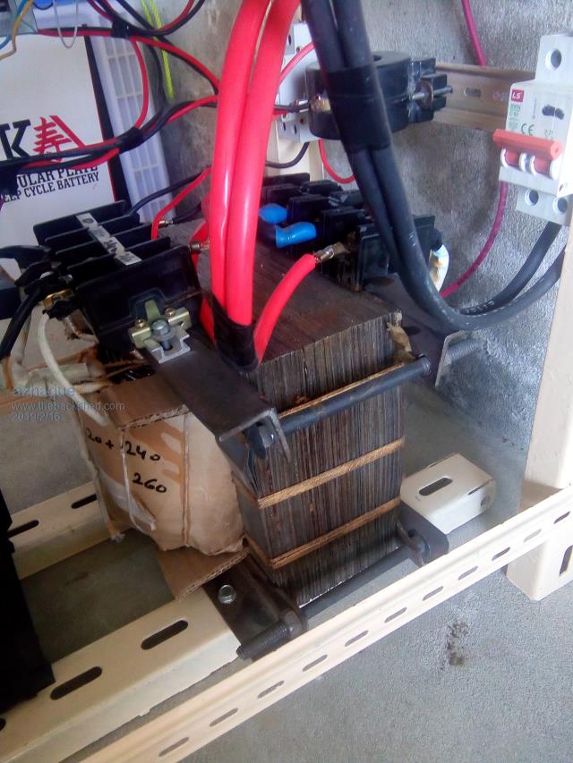

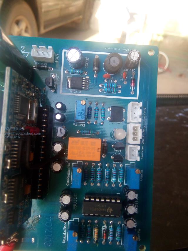

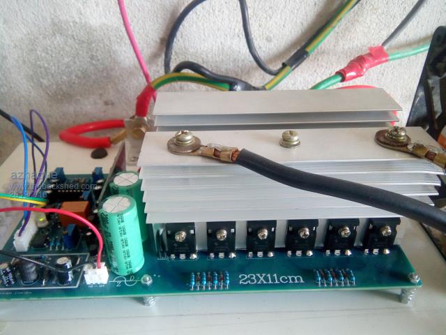

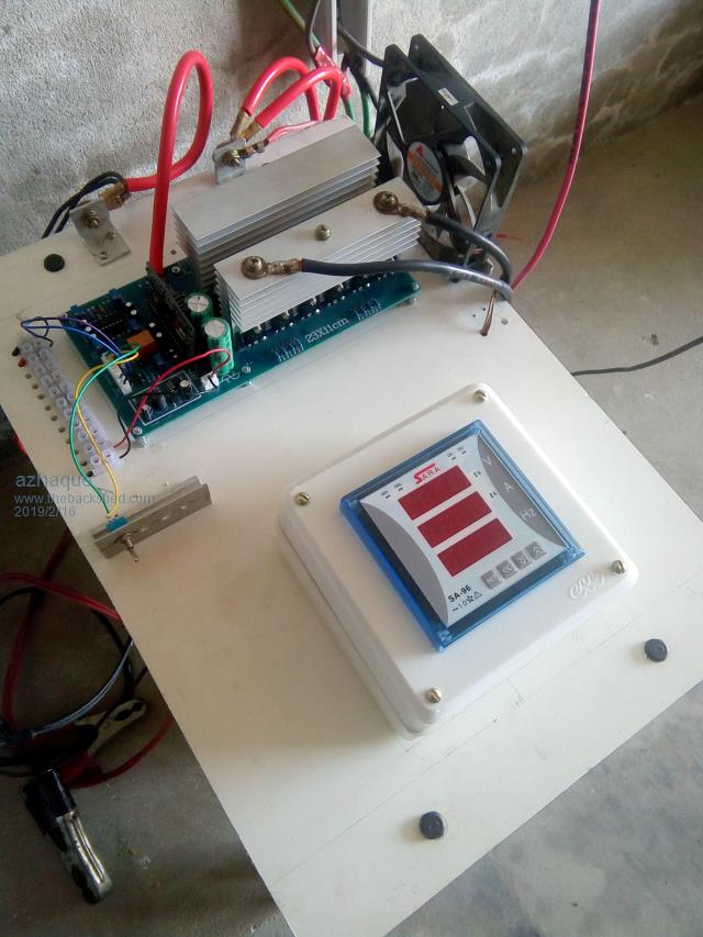

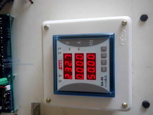

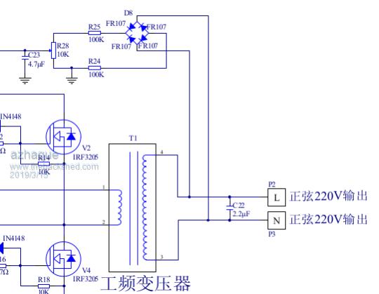

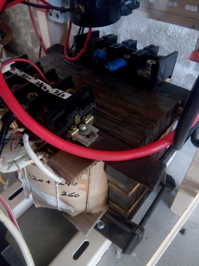

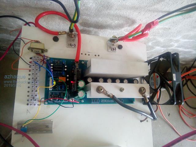

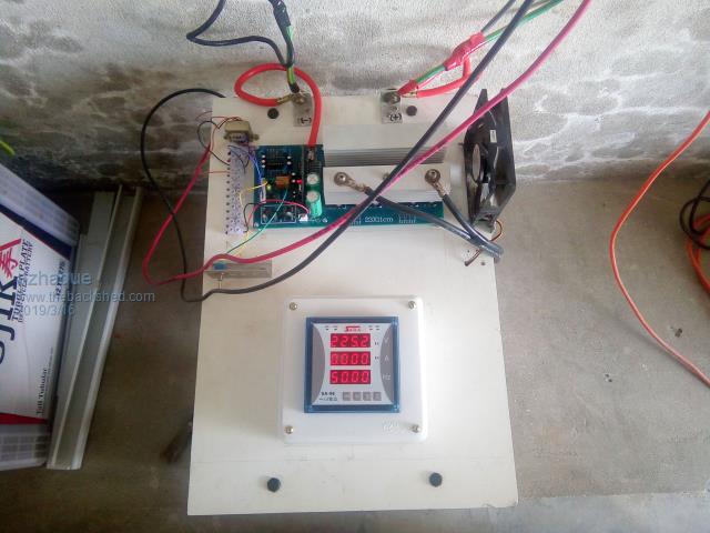

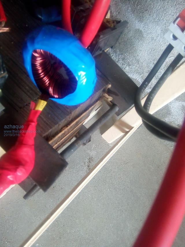

There is enuff in the above posts to take a few hours to digest. Thanks Warpspeed, Clockman et. all. Will continue on the technical aspects later. So this session for uploading video and photos only.

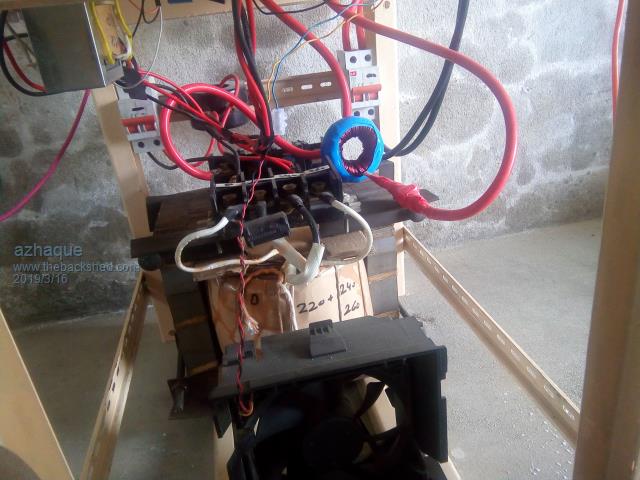

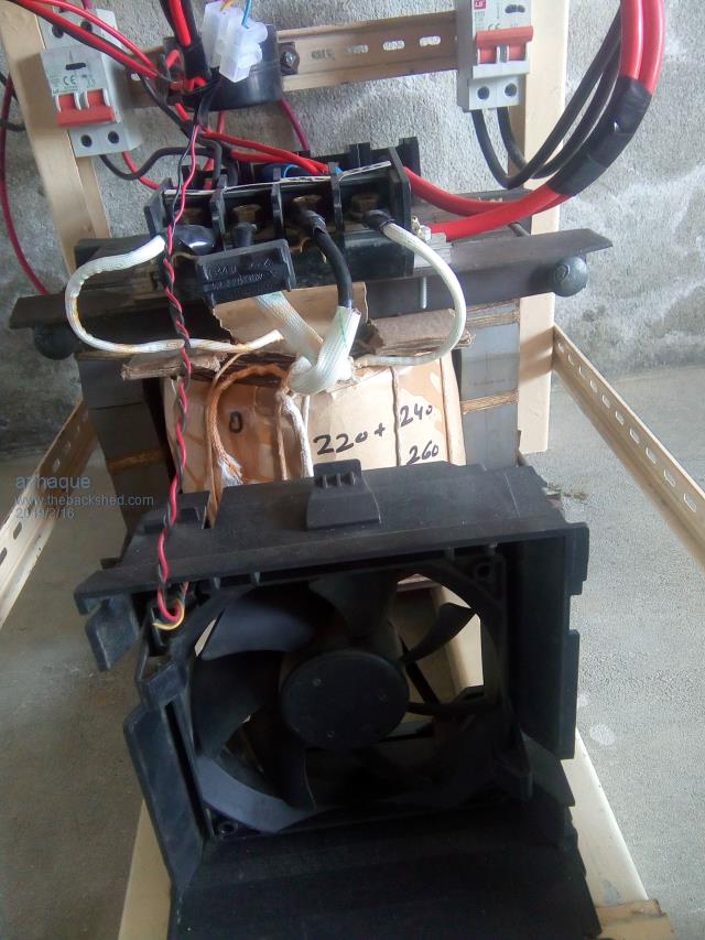

Youtube video of first electrons of homebrewed inverter .
The top platform with the inverter board and instrumentation.
The transformer under the top platform.
The Chinese inverter board
Volts, Amps and Hz.
Inverter Board- Side view
Transformer Cooling Fan
Transformer- Another view
