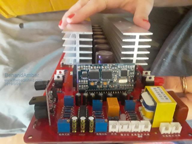

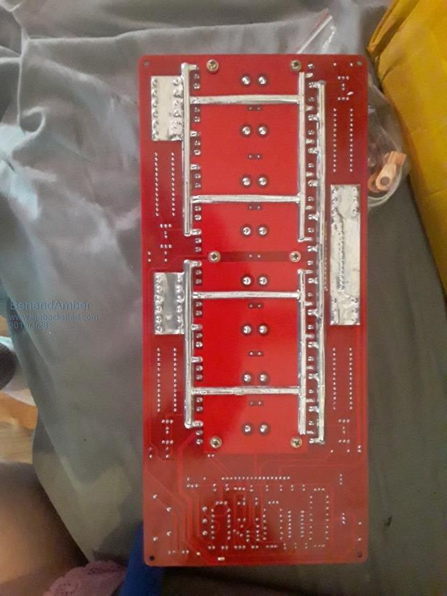

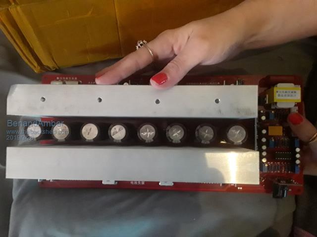

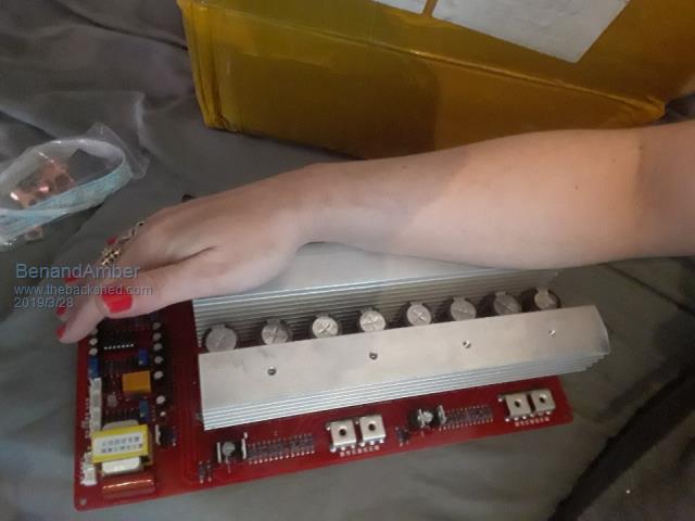

This thing is big and heavy it was under $180 shipped
Not what I was expecting it's very heavy and seems to be very well made but the experts on hear will most likely chimed in chime in and let us all know the quality of build
It came very well Packed
The outside of box was destroyed buy shipping and the only damage was that one little Bend
This is the esg002 that came in it and the original settings
24 hy4008Edited by BenandAmber 2019-03-29
gadgetjack
Joined: 15/07/2016
Posts: 240
Posted: 08:36pm 27 Mar 2019
That is the bigger brother of the board I got. Mine is 3000 watt and yours is 5000 watt. I have mine running right now. It does a good job if you don't go crazy with the load. Pick a good fan for it.

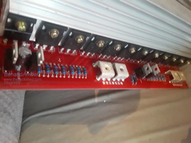

  BenandAmber said
I plan on taking the 393 chip off and disabling all current feedback
And adding zener diodes like poida mentioned on the little Chinese inverter board post
I think that board has a bunch of resistance links soldered to the pcb between two of the large terminals, these are used for current overload protection circuitry on the main board, so I wouldn't go chopping things off to hastily as you don't know how they have wired this up. Similarly if the drivers are running off 12 volts supply then adding extra zener's isn't required with the totem pole drivers fitted to that board.
Mike

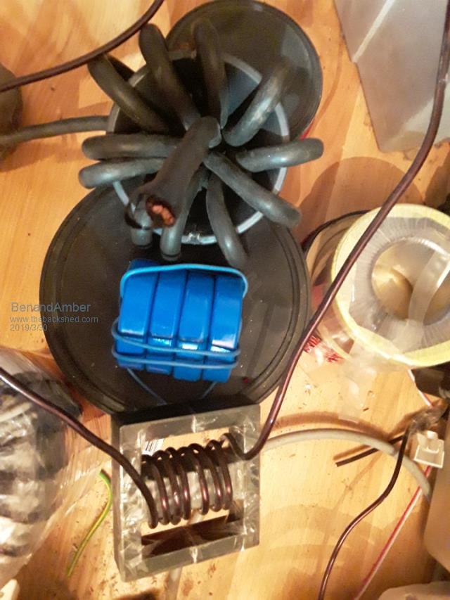

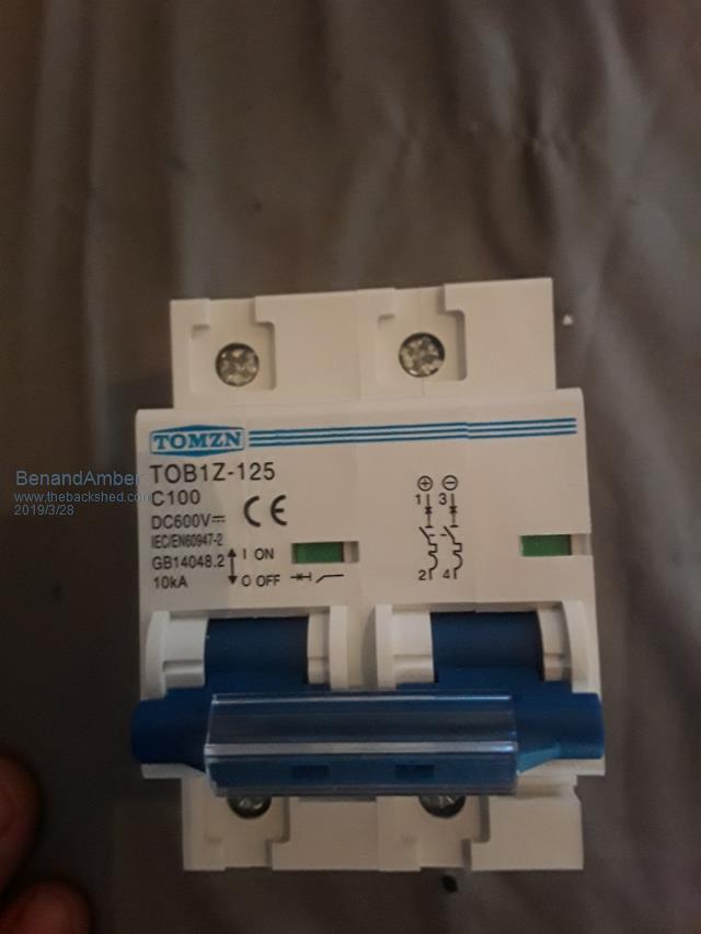

We are looking for some advice about what kind of filter should be on this board the manufacturer recommends these sendust torid core we allso have a E80 ecore 87 material we are going to be using this dc 100 amp breaker
I also have this one made from a ferrite off of a old style television tube we have a inductance meter to check Henry

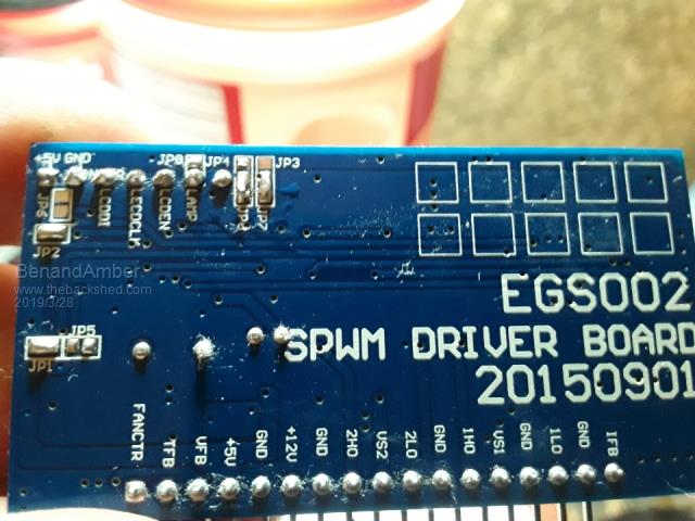

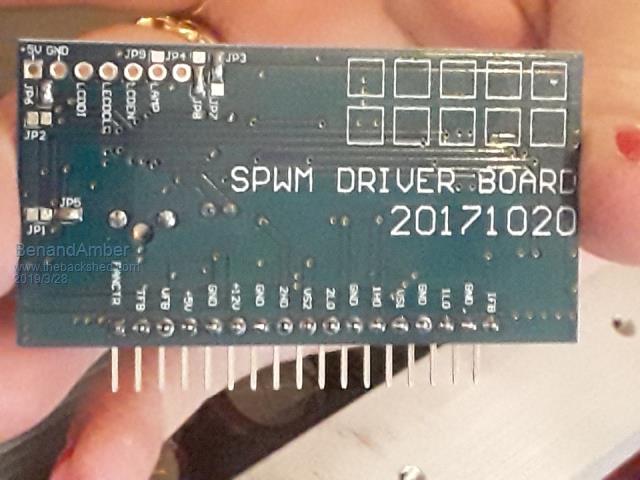

Sorry everyone I have several of these oo2 boards
I posted a pic of the wrong one up above just the back though the front one is the right one
this is the one that came with the board
Notice that this does not have the little black wire soldered on
maybe they fixed this problem in all the pictures they have a black wire soldered on the front of the card going down to the board
I am not no expert by any means but this
just seems very high-quality to me it's heavy it feels right in your hand it just looks like quality to me
It's big the APC 3000 watt boards I have looked small compared to this one all of the solder points look perfect to me
I wasn't expecting something this heavy and this high quality
I may be speaking too soon and it might blow up the second I hook it up but me and Amber are very impressed with it so far
I think the dead time is set for 500 is this a good thing if I remember correctly everybody says set them to 300
If anyone feels like explaining the cause and effect of the Dead time I would like to learn about it
thank you everybody for your timeEdited by BenandAmber 2019-03-29

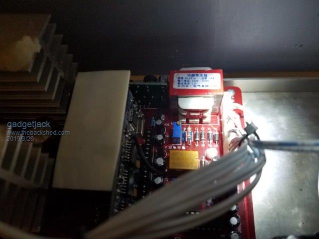

gadgetjack
Joined: 15/07/2016
Posts: 240
Posted: 04:15pm 28 Mar 2019
I changed the jumper on the small board for 60 hz. I added the 2.7k resistor shown in the picture to bring the feedback into the 120 v range . I hope the picture is viewable.
BenandAmber
Joined: 16/02/2019
Posts: 961
Posted: 05:35pm 28 Mar 2019
Gadgetjack
thanks for your post and your pic
I will see if mine is the same
If so you have saved me a bunch of guessing I appreciate it
mine does not have the little black wire on little board what is that wire for

gadgetjack
Joined: 15/07/2016
Posts: 240
Posted: 05:17am 29 Mar 2019
I got my inductor from an old Xantrex inverter I parted out. Not sure what the black wire was for , never traced it out to tell you the truth. It just worked so I left it at that. Best of luck with yours.
https://www.aliexpress.com/item/Free-shipping-1pcs-1800W-5500W-DC12V-24V-36V-48V-to-AC-220V-pure-sine-inverter-board/326 37730780.html?spm=a2g0s.9042311.0.0.4pvcs8
EGS002 driver board jumper Description:
JP1: When JP1 link, JP5 is disconnected, 60Hz output;
JP5: When JP5 link, JP1 is disconnected, 50Hz output;
JP2: When JP2 link, JP6 is disconnected, 3 seconds soft start;
JP6: When JP6 link, JP2 is disconnected, close the soft start.
JP1 must be jumped and JP5 disconnected. This will make it 60 Hz.

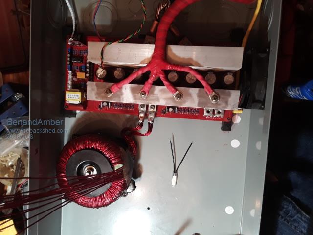

Trying to figure out the best placement for everything
looks like I'm going to have to buy a set of crimpers to crimp new ends on the wires they're too long or may be solder them on
The wires are also ginormous two wires for each and still 1/2 inch across
I don't know which is the best way solder or crimp
Edited by BenandAmber 2019-03-31
renewableMark
Joined: 09/12/2017
Posts: 1679
Posted: 01:43am 30 Mar 2019
Hydraulic crimpers are fantastic, very cheap these days.
Like this with 4-70mm sets of dies should do you fine.

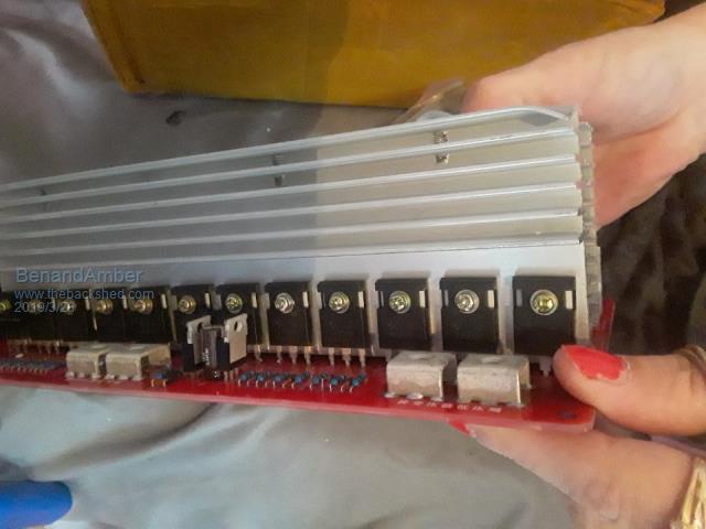

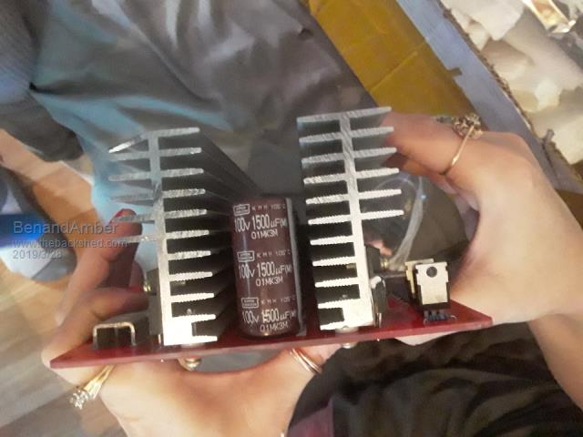

Try and mount that power board so the heatsink is vertical, that way the natural rise of heat will assist you. Fit the fan close below. Be aware that the air will take the path of lowest resistance, you may need some kind of a shrowd to direct air where you want it. No point it blowing all over the place, it needs to go through the fins to cool them and the caps.Edited by renewableMark 2019-03-31

I have three choices for inductor filter
The one on the left is the ferrite off the back of an old television tube
The one in the center is 4 sendust toroid
The one on the right is a e80 core
I don't have any idea how I'm going to get enough turns on center one or the right one and don't know if the left one will work I've never heard anybody using this type of material Edited by BenandAmber 2019-03-31
