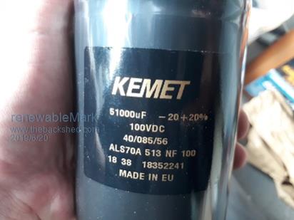

These are the caps I got.
Edited by renewableMark 2019-06-21
Cheers Caveman Mark
Off grid eastern Melb
Posted: 02:36am 20 Jun 2019
Here is the data sheet:
https://pdf1.alldatasheet.com/datasheet-pdf/view/957108/KEMET/ALS70A513NF100.html
About four of those might be a good start, with the excellent Klaus type of layout.

Posted: 09:52am 20 Jun 2019
  renewableMark said   These[/URL] are the caps I got.
Good buy Mark and just a little more expensive than the ones I got.
Beware, the terminal screws might be an American gauge thread (mine were) and they also were too short for 6mm bus bars. Fortunately I had some gauge screws from a junked Yankee computer that fitted.
The thread looks like 5mm metric, try a M5 screw by hand, if it does not go in all the way *easily* don't force it, use the correct screw.
These caps are too expensive to wreck the terminals .
The data sheet might tell you what type screws - I did not look there.

Yeah, if you look down the page, it has related parts, 5mm screw is listed.
Thanks for the heads up though, be nasty to stuff them up, they'll need a good connection.
Cheers Caveman Mark
Posted: 02:43pm 20 Jun 2019
Kemet are European, so 5mm for certain.
But beware, the terminal posts are aluminium and the internal threads fairly fragile.
