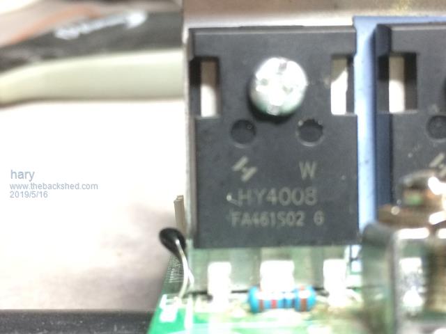

My Little China inverter board arrived today :
As you can see, it is already equipped with HY4008 MOSFET !
But I think there is a bridge of solder that souldn't be there :
2019-05-16_072935_IMG_2231.pdf

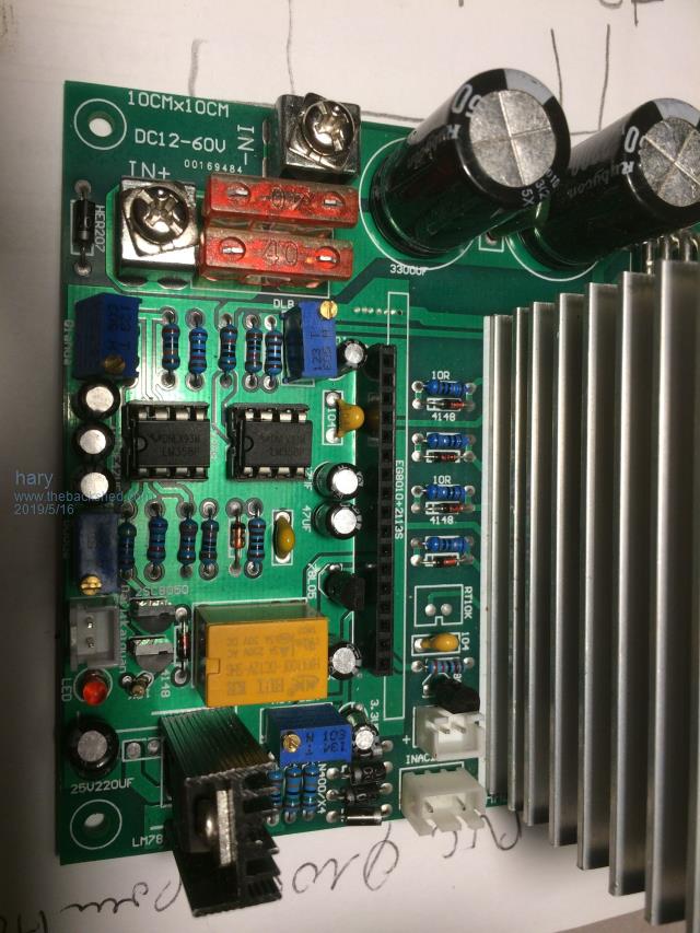

On the EGS002 board, JP2, JP5, JP7 and JP8 are jumped, so the board is ready for :
50Hz,
Soft Start ON,
dead time to minimum 300ns
LCD backlight off.
I just wonder why they configure the board with minimum DEAD TIME. Shouldn't it be configured at the maximum or at least at a middle value to be on the safe side ?
The board has R4 resistor but no C19 capacitor !
Of course, as poida advises, I'll remove R4 and U4 (LM358)
I'm still waiting for my TVS diode to make the modification before plugging it in !
On the power board, there are 3 connector and 4 potentiometer.
Bottom right connector is for 220V output feedback with its bottom adjustable potentiometer,
What are they for ? but I have no clue about the 2 other connector and 3 other potentiometers.

That solder bridge looks very dodgy. I would clear it away and look at the underlying mask.

These boards have potentiometers to allow the setting of low voltage cutoff,
low speed over current shutdown (very problematic)
high speed over current shutdown (same)
and the AC output setting.
The connectors provide you to attach a remote on/off switch, a 2 colour LED to show standby/Running indication, a 12V drive for a cooling fan and the 240V AC voltage feedback.Edited by poida 2019-05-17

  poida said   That solder bridge looks very dodgy. I would clear it away and look at the underlying mask.
The solder bridges pin 1 and 2 off one of the MOSFET and underlying mask tells it has something to do with the MOSFET gate pull down resistor that is short circuited to drain.
So, I will clear that up.
1 => OK
2 & 3 => No more problem as you advised to suppress EGS002's C19, R4 and U4 (LM258)
4 => OK
One is 3 pin, but only 2 available, and marked "INAC220V" that must bee the 230V feedback.
one is 2 pin and marked "FS12V" might go for Fan Start ?
And a third one with only 2 pin with no understanding marking !
So only 3 connector, not 4 as you suggest.
For a 2 colour LED, I think a 3 pin connector would be needed !
Thanks a lot for all these details !Edited by hary 2019-05-17

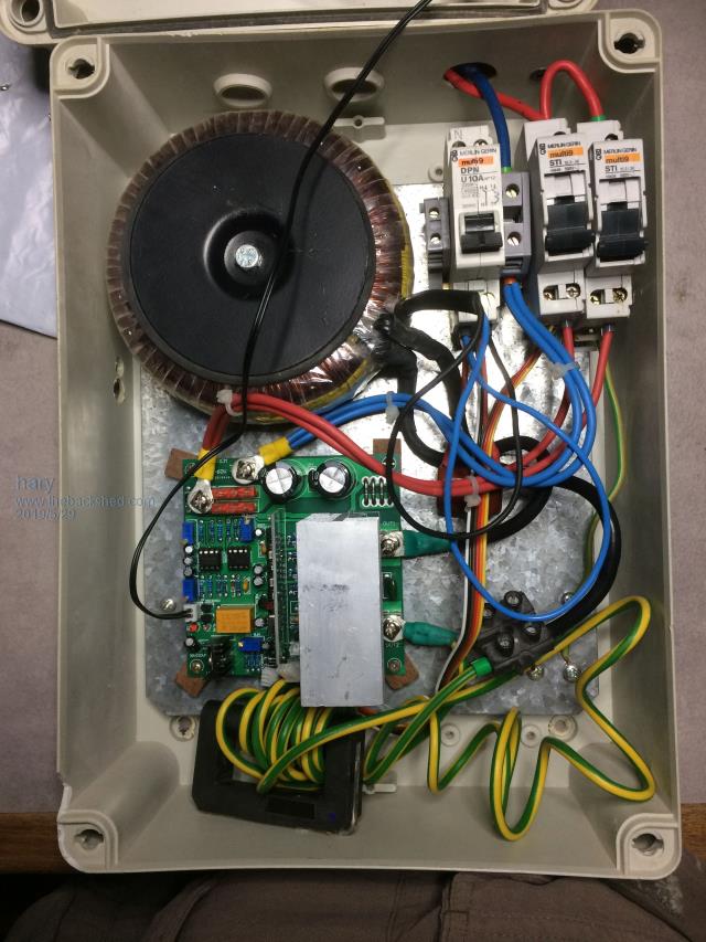

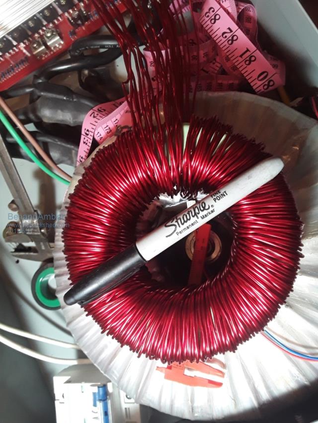

hary
Joined: 15/04/2019
Location: France
Posts: 89
Posted: 05:51am 16 May 2019

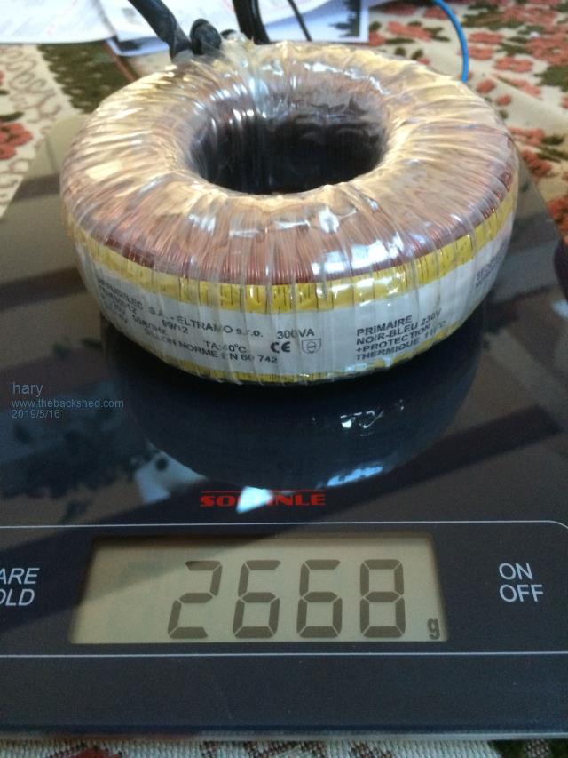

  BenandAmber said   Do you have your Transformer already if so can you post pictures
Here it is :
I'm expecting 200VA continuous, 1000VA peak. It's meant for the fridge !

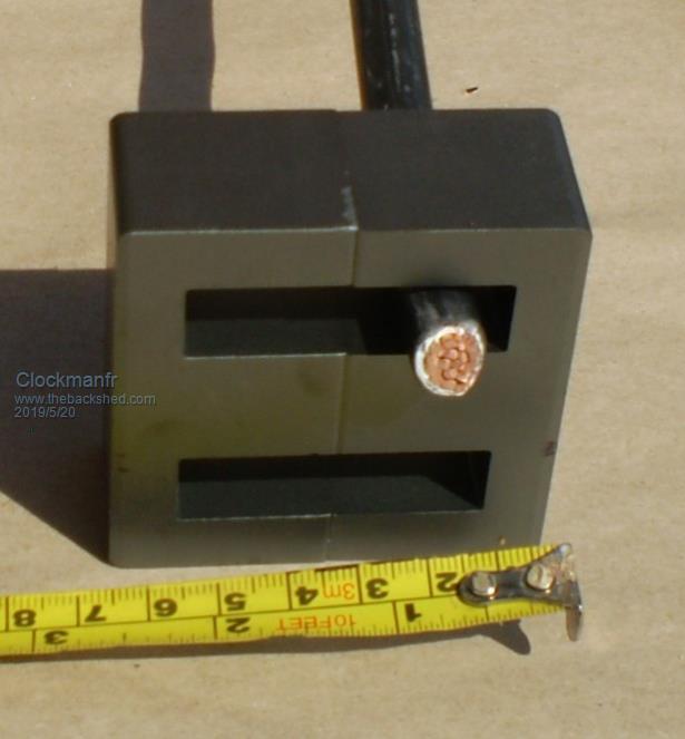

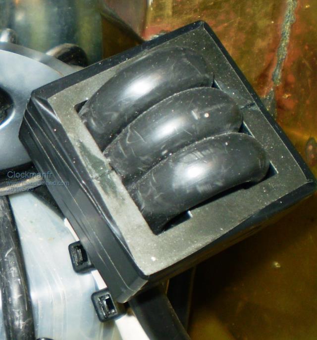

I'm thinking right now that I've seen some people adding what they call a "choke" in series with the low voltage circuit of the transformer.
Should I get one myself ? I don't really understand what it's meant for ?
poida
Joined: 02/02/2017
Posts: 1510
Posted: 03:44am 17 May 2019
  hary said   I'm thinking right now that I've seen some people adding what they call a "choke" in series with the low voltage circuit of the transformer.

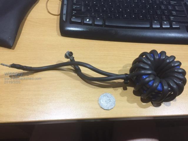

A choke is an inductor, used to reduce to a small amount the high frequency energy
flowing through the primary winding.
These types of inverters, including most of the home made ones here, the Chinese inverter boards and the Powerjack LF types all use pulse width modulation to produce
the 50 or 60Hz AC on the primary winding.
Most times, the frequency of the pulses is about 20kHz (19 - 23kHz depending on the inverter)
This means the DC supply is being switched into & switched out of the primary winding
about 20,000 times a second, causing huge amounts of high frequency energy to be produced. This HF stuff is a problem.
The solution is the choke. It can be sized such that it does not conduct much HF energy at all, but lets through the 50 or 60Hz with very little power loss.
This is a good one, made by Wiseguy. He used a different core type.
I make mine using a $20 ferrite core and a bit of wire, enough to put about 8 turns around the inner core. I used something like this
We need a choke that is about 50uH and can maintain that 50uH up well past the inverter's DC current draw when loaded, at least 1.5X
You put the choke in series with one of the primary winding terminals.

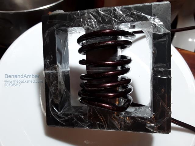

BenandAmber
Joined: 16/02/2019
Posts: 961
Posted: 03:53am 17 May 2019
This one works very well
This one is like poidas pic
But has 4 cores it instead of two
It works well but probably too big for yours
This one is ferrite material also but is 1 big core instead of 4
Was hoping somebody would comment on it I don't want to make a big mistake literally
At this point I would recommend the top one
I know it works very good
it has a slight hum but it isn't bad at all when you have the top on the inverterEdited by BenandAmber 2019-05-18

The choke acts as a shock absorber, taking the killer punch out of the huge current pulses of the PWM design.
I have examined the voltage across the primary winding terminals of my inverters and when I have a good enough choke installed, all I see is clean steps in the voltage.
If the choke is insufficient, I see spikes on the rising edges of these step changes.
The step changes of course are due to the PWM, switching in a pulse of DC supply, which the choke absorbs, converting it to the smooth and small voltage step presented to the primary winding. Have a look here when I examine the choke's effect
Often, this discussion leads to the question "how best to build a choke tester"
In your case, with the 1000W inverter board, the inductor Ben & Amber showed at the top of here will be easy to build and work fine. I use 6mm2 PVC insulated house Earth wire in mine. It's more flexible to work with.
Sometimes it's helpful to think of the necessary inductance as being 1/2 of a high power, low loss LC low pass filter. The filter's job is to remove the 23kHz PWM, and it's higher overtones completely, letting 50 or 60Hz through with minimal loss.
The capacitor is positioned across the AC output winding. The inductor is placed..
When you put it on the secondary, there appears a capacitance across the primary, multiplied by the turns ratio.

My Personal observations on my OzInverter builds.
This below is from the New second edition workshop manual of the 6kW OzInverter build process.
The new book is a complete and utter new re-write, with absolutely everything about everything, 92 pages and 242 colour photographs and block diagrams, its at the printers at this very moment.
Toroid ferrite Ecore choke. For further information see the technical chapter.
A = 65mm (2.56") (Length) B = 45mm (1.75")
C = 32.5mm (1.28") (Height) D = 22mm (0.87")
E = 20mm (0.79") F = 27mm (1.06") (Width)
“The ecore will drop your idle current and at the same time take an enormous amount of heat out of the transformer due to the new efficiency.... other wise it will absord hundreds or watts for nothing but heat you don't want. ………..oztules”
The ferrite Ecore is very important as it reduces inverter idle current use, ie, the inverter is not using excess power while awaiting use when running, like night time when the household is asleep. With this 6kW OzInverter the running, ilde, power use is down to 30 to 40 watts.
The ferrite core is commercially available as ‘E6527 Ferroxcube E65 E EE Ferrite Cores’ , I have found this size to be the most efficient and quite. I have experimented with bigger cores with 70mm2, but then the flexible cable needs to be wound really tight or the Ecore Choke sounds like a Banshee on speed. The cores comes in two half’s, but those internal edges are very sharp so I use a fine needle file to gently round the corners.
I have found this particular size hits a sweet spot. You could widen the core gap but then at high power other problems arise.
Edited by Clockmanfr 2019-05-20

Clockmanfr, you say :"E6527 Ferroxcube E65 E EE Ferrite Cores"
But is this the correct core for all kind of inverter ? The 6kW and the one I'm intending to make, so 200W continuous, 1000W surge ?
Plus haw do we source core like that ? what are the data we're looking for ?
From what I understood, the core modify the relative magnetic permeability compared to an air core inductance.
So we should source a core with a specific permeability, I guess...
Edited by hary 2019-05-21

Clockmanfr
Joined: 23/10/2015
Location: France
Posts: 437
Posted: 08:24pm 19 May 2019
Hi Hary.
The ecore is available from this guy in Sofia, Bulgaria , he will send to most countries ........
https://www.ebay.co.uk/itm/E6527-Ferroxcube-E65-E-EE-Ferrite-Cores-bobbin-Power-transformer-AL-8600- set/370597734866?epid=1574393580&hash=item564958a9d2:g:9jMAAOSwa1hb6rmx
We have found this particular size of Ecore to be about correct for the 22kg core of the toroid with the 6kW OzInverter on 48v. On a smaller 2000w it may be overkill and might be excessive.
When winding the Ecore you need a minimum of 3 complete winds around the centre lump of ferrite. But as I said the windings need to be tight.
The primary on a 6Kw Ozinverter is normally 15 turns of 50mm/2, so we also wind the Ecore with the flexible marine/welder type 50mm/2 cable, and its a snug fit.
Edited by Clockmanfr 2019-05-21
