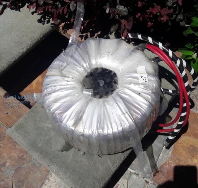

This is going to be my first inverter build. I'm going big or going home. I want to have 220v and 120v output on the toroid. I please need some help with the calculations for modifying/rewinding the toroid. I have the datasheet for the toroid but not for the core.
2019-07-13_130146_9540.pdf
Posted: 03:10am 13 Jul 2019
As it is now, no load current (at 240v) is 505mA or 121 watts.
That is is 2.9 Kwh per day loss just in idling power.
What are you trying to do exactly ?

I want to make an inverter to power my house. So I need two 120v legs with a neutral so I can get 220v and 110v
Do you think I can rewind it to get lower losses?Edited by kentfielddude 2019-07-14

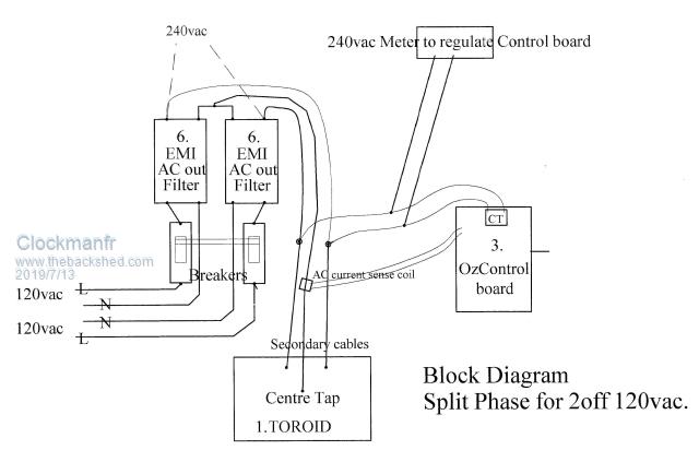

Hi kent,
I have built 8kW Ozinverters where the toroid is about 32Kg of bare core and fully wound toroid at about 50Kg.
6kW running and your bare core wants to be about 18kg to 22kg. Its all about mass in the core for long term power pulling, that's if your batteries can handle that drain.
After many years of running, I do not recommend the 8kW as the 6kW can cope with everything I throw at it. As Warpspeed says the bigger the core the more power from your batteries is wasted just idling away. In general 20w to 35w for the 6kW Ozinverter and 40w to 80w for the my 8kW OzInverter.
Above a 8kW toroid the weights become serious and assistance is required just to turn the toroid with out damaging it, enamel/insulation, mylar, joints etc.
Toroid/Inverter ratings in the real world.,.... When I mean 6kW I mean 6kW all day if need be, (watch your batteries) with good cooling, runs happy at 15kW for some time, fantastic surges to 50kW, according to Oztules, I have not tested to that as I am a chicken!
I once bought a well known make of top brand Inverter that said it was 6kW, in real life it would run at 4.5kW, at 6kW it would run for maybe 10 minutes before overheating and auto shut down.
Below block diagram of a split phase for 120vac and 120vac. please ensure that your breaker is linked and shuts down the other breaker at the same time.

  kentfielddude said   I want to make an inverter to power my house. So I need two 120v legs with a neutral so I can get 220v and 110v
Yes you possibly can.
Lowering the flux density will reduce idling losses, but it requires more turns to do that.
If it was just for 220v only, adding some extra turns to the secondary would be fairly easy. But you will require an exact centre tap for 110v/110v.
That requires a complete removal of the secondary so a known number of turns tapped in the middle can be wound back on.
How easy that is going to be, depends on how it has been wound. If the secondary is one single winding of massively thick wire its going to be a real problem. If there are multiple thinner strands wound in parallel it will be much easier, and the extra total wire length will be an advantage.

The actual windings themselves may be multiple strands, the way most of the grid tie inverters toroids are wound.
What I am thinking, is that the secondary may be for instance four strands.
That could be rewound as three strands with 33% extra turns with a centre tap using the original wire.
That would create the extra turns without taking up any more space on the core.
Max continuous rated power would reduce to 3/4, but 7.5Kw continuous is still a lot.
As Clockman says, it will easily do multiples of 7.5Kw for short bursts.
As it now is, the idling current is supposed to be 504mA.
Try running it at 3/4 of that voltage (180v) off a variac, and see by how much the idling current falls. I would expect it might drop to one half or even less.
The massive turn on current surge will greatly reduce as well.Edited by Warpspeed 2019-07-15

May I suggest that before you do the 110V testing on the 240V winding, first add about 20 turns test winding using any type of insulated wire you have on hand (magnet wire, lamp cord, speaker wires, etc.).
Connect this test winding in series (in-phase) with the 90v winding. Connect the 240v to the 110v source. Measure the voltage across the 90v winding. My guess is it will be around 41 vac and together with the test winding, it should be higher than 41vac when connected in-phase.
If it is higher than 50vac then you can disconnect the 110v source from the 240v winding and connect it across these two (90v + test) windings. Since you know the test winding number of turns and can measure the voltage across it, you can now figure out the turns/volt or volts/turn of this transformer.
With an AC ammeter you can now measure and calculate idle power loss at this test condition. And if you add more turns to the test winding and re-measure/calculate, you can figure out what turns/volt is needed to lower idle power loss. Not sure if it can be made lower than the specified core loss.
