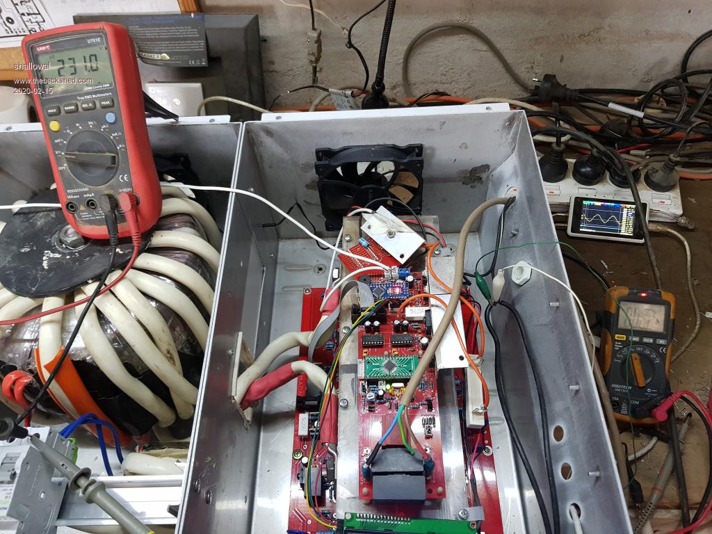

Posted: 01:18am 15 Feb 2020
Well, Whaddya know. It actually works!!!.
I connected a 60w light bulb OK and the configuration is just 4 FET's and no capacitors.
Woohoo!!!
Allan

Posted: 01:27am 15 Feb 2020
Excellent results Allan
Before you start adding the big electrolytic capacitors and more mofets, I strongly recommend you fit a choke in series with the primary to reduce the stresses on the mosfets.  Do you still have the original iron cored Inspire chokes that came with those stainless steel boxes ?

  Warpspeed said  Excellent results Allan

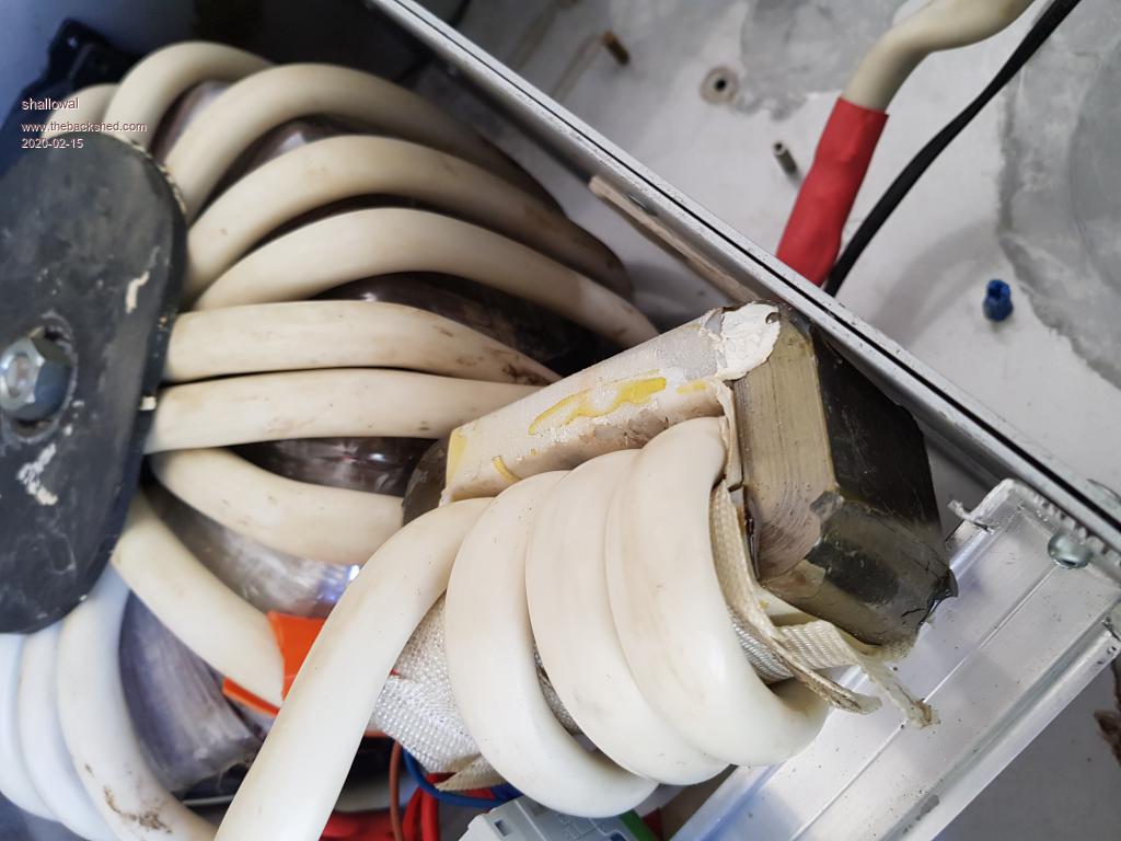

I have three turns around one of the Aerosharp chokes in series with the toroid on the high frequency side already. I'll take a picture.
Allan

Posted: 02:02am 15 Feb 2020
Or, does that count as 4 turns?

Posted: 03:51am 15 Feb 2020
  shallowal said  Or, does that count as 4 turns?
Allan
Yes its four turns. You can get away with using thinner wire on the choke, because the wire length in the choke is very short. The transformer primary needs the thicker wire to reduce losses and heating.
It would be better with more turns, and if you can stack two sets of choke cores, even better still. Its a case of more is always better. A 1.5mm to 2.0mm gap spacer might be about right.
There is no substitute for testing a choke, but my gut tells me that should come pretty close.

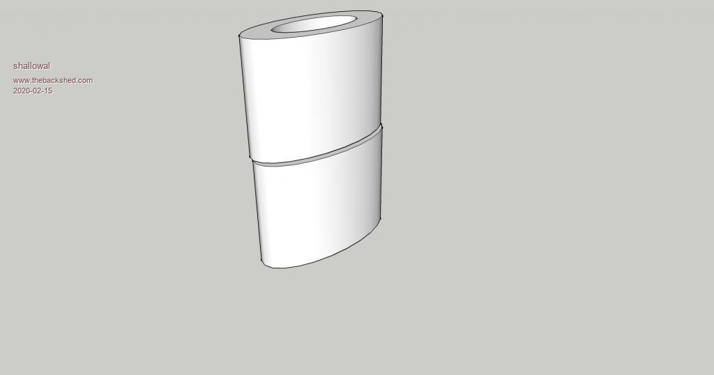

Posted: 05:47am 15 Feb 2020
Do you mean stacked on top of each other with a 2mm gap and then the wire wrapped around the combined toroid?.
Allan

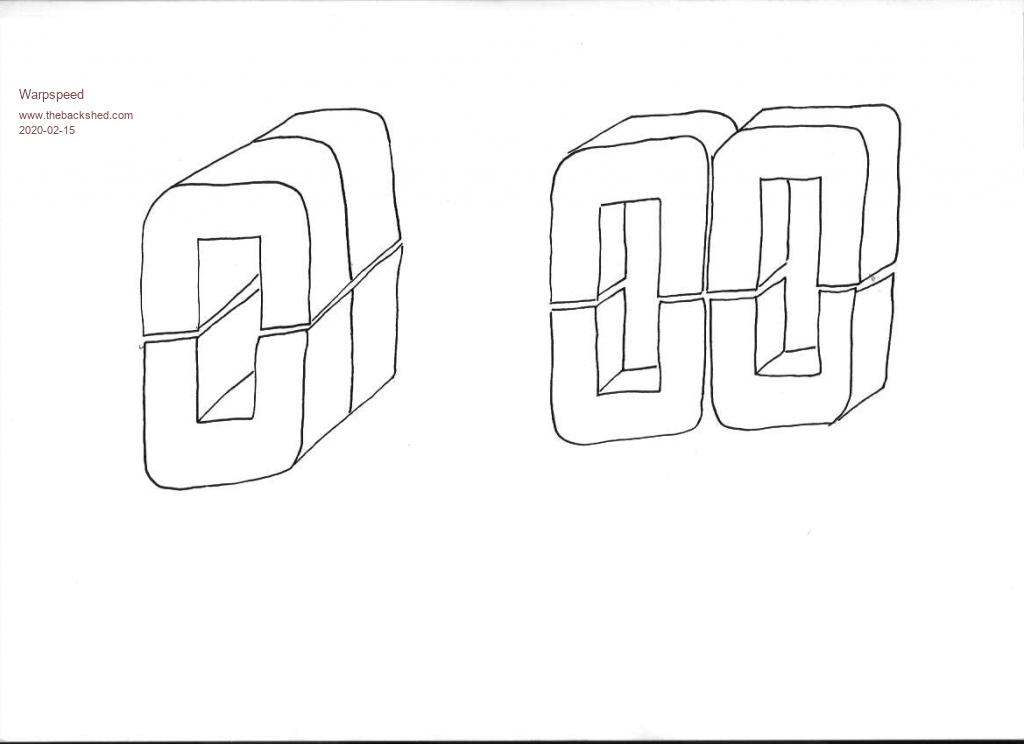

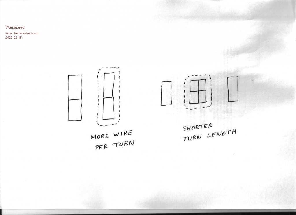

Posted: 07:40am 15 Feb 2020
There are a two different ways to stack two pairs of U cores:
Both work and will have the same characteristics with the same air gap, but there is one notable difference.
The mean length of turn is different. The cores themselves are not rectangular in cross section, and if you stack two end to end the length of copper wire per turn is longer.
If you stack two cores side by side, the core cross section in the middle becomes rectangular, or almost rectangular, creating a shorter turn length.
This is all more theoretical than practical for our purposes, so in your case, do whichever way seems easiest and most natural.
If I remember correctly, the combined window area of two Aerosharp cores produces a hole 70mm x 20mm.  In theory 14 turns of 10mm outside diameter round wire should fit through that, and it is possible, but only just. Twelve turns might be a more realistic expectation.
10mm over the plastic with about 8mm diameter of copper is 4mm x 4mm x 3.142 = 50mm squared. that will run warm at 100 amps dc, but will work very well.
About a 1.5mm to 2mm spacer should put you in the 150uH and 150 amps just before saturation range.
Edited 2020-02-15 17:45 by Warpspeed
