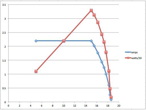

I have a simulation of a solar panel working well.
It uses the buck converter running some custom code.
The code runs in constant current mode, but with a twist.
It is CC from 0 to 15V output, and then when the output volts
rise from 15 to 18V, the output current is reduced proportionally.
This gives the sort of power verses voltage curve I need to
test MPPT code.
The data is from the constant DC load I built years ago.
I dial up a current and observe the voltage...
volts amps watts/10
18.6 0.09 0.1674
18.4 0.26 0.4784
18.2 0.61 1.1102
17.7 1.01 1.7877
17.3 1.25 2.1625
16.9 1.44 2.4336
16.2 1.77 2.8674
15.5 2.02 3.131
15 2.2 3.3
10 2.2 2.2
5 2.2 1.1
which looks like this when graphed. X axis is volts, Y is amps (and watts/10)
Beaut. Now I have something to test the MPPT buck converter against.
If my MPPT code can't find that peak then something is very wrong.

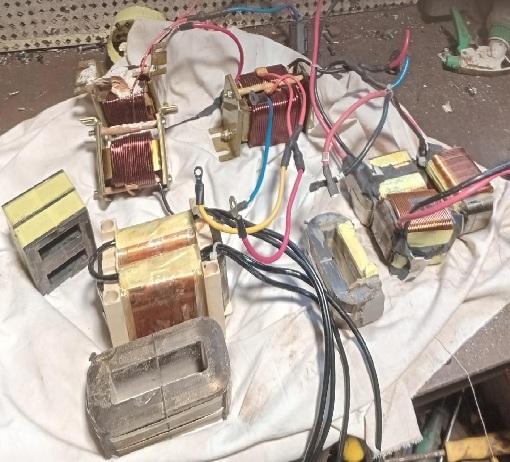

I will be following this topic with great interest, last weekend I did the winding of my 3 inductors. One step closer of hanging the controller against the wall.
I will be happy to help you anyway I can.

  Quote  I need to be able to simulate a solar panel. How?
No idea actually.
You need a variable voltage dc bench power supply and a series resistor of your choice.
Couple up your buck converter to that along with some type of convenient low impedance load to dissipate the anticipated power.
You will be drawing maximum power from the source when you pull the voltage down to exactly half of what it is unloaded.
By changing the value of your series resistor over a wide range, if the software "brain" always loads it down to half the open circuit source voltage, with a combination of different source voltages and series test resistor values, your algorithm works fine at finding max power transfer.
The idea is that max power transfer always occurs when a load impedance is perfectly matched to the source impedance. That will always pull the voltage down to exactly half, because its really just two equal resistors in series, source and load.
The source impedance will be your series test resistor, plus whatever internal impedance the dc power supply has.  The load impedance will be your buck converter and actual final dissipative load in series with it.
Turn on the power and watch your software creep towards loading down the source voltage to EXACTLY half the open circuit voltage. That operating point equates with max power transfer.
Now solar panels are odd things, they are very non linear source, a charging battery makes up a complex non linear load as well.
If your algorithm can truly seek out and lock onto the power peak, it will aso work on something much more predictable such as a voltage source of known impedance.
So you really don't need to duplicate crazy solar panels and batteries for a valid test of your software.
