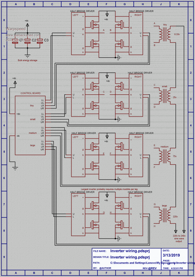

Also, I couldn't find a diagram of how the transformers connect together. Are the secondaries in series?
Posted: 08:53am 18 Jul 2020
The primary windings of all four transformers are wound for whatever will be the minimum dc voltage the inverter will ever see. It will then work from that minimum input voltage up to twice that voltage.
The secondary voltages will be 225v for the largest transformer, 75v for the second largest, 25v for the third largest and 8.33v for the smallest. The secondary voltages must go up in EXACT steps of three, and that is important.
Secondaries are connected directly in series so secondary currents will be equal to the inverter rated current. Five Kw = 230v x 22 amps for example.
Now at the minimum rated dc input voltage, if all the inverters switch on in the same direction, a voltage peak of 225 + 75 + 25 + 8.33 = 333.33v is possible.
That would create a 235.7v rms sine wave at minimum dc input.
Anything above minimum dc input, the voltage regulation kicks in, and the actual ac output voltage can be tweaked with a potentiometer.
Here is the complete wiring diagram.
As you can see, the secondaries are just connected in series, its that simple.

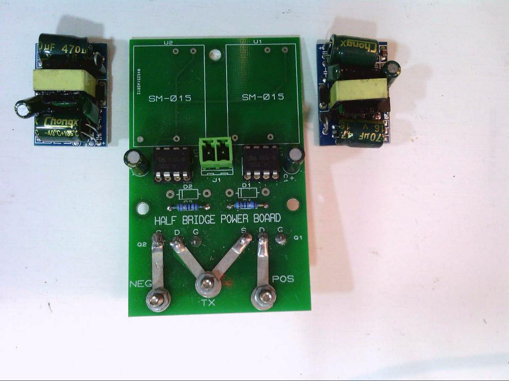

What half bridge driver do you use?

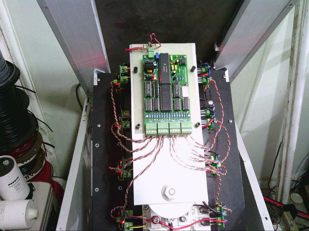

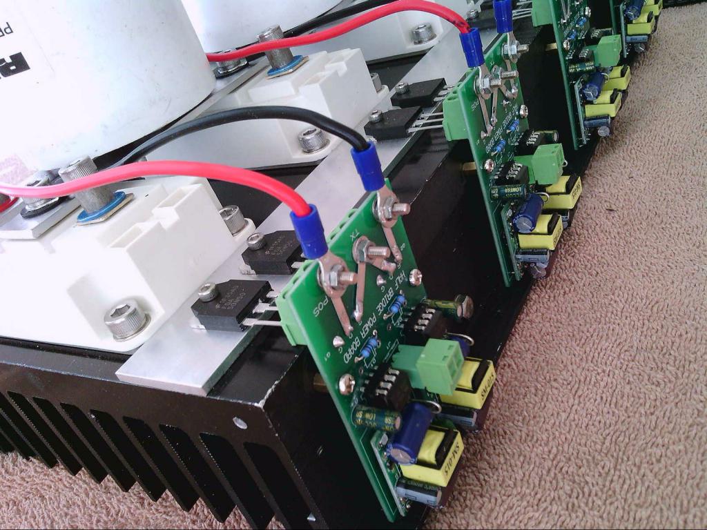

Posted: 05:19am 19 Jul 2020
Pretty basic, I used eight of these same boards.

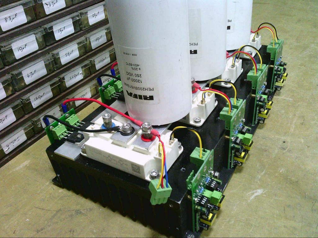

Posted: 05:39am 19 Jul 2020
Four of these driver boards run the two smaller inverters that just use individual 50 amp 600 volt IGBTs or mosfets.
Four more driver boards run the two larger inverters that use 200 amp 1200 volt half bridge IGBT power blocks.

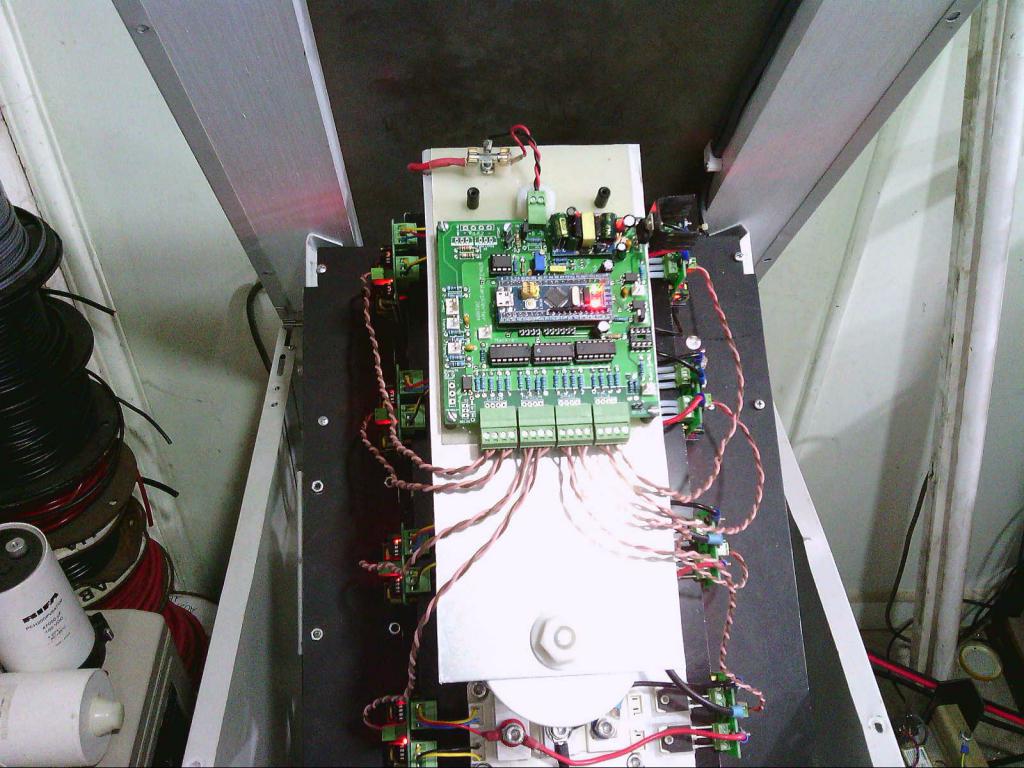

The control board (either type) sits on top of the electrolytics.
This is my very simple basic "dumb" non microprocessor board.
This is Mike's "smart" Nano board, it has a lot of extra features, and plugs straight in.

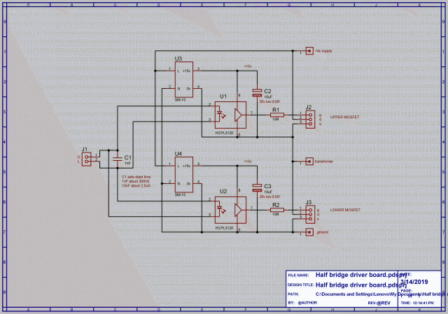

Posted: 08:21am 19 Jul 2020
No don't common anything !
I just realised the schematic does not correspond exactly to the board. The inverse diodes across the gate resistors are no longer required, and the component designators are wrong. But the schematic is correct in concept.
The board pictured was the first batch that I am still using in my own inverter.
The schematic is for the latest version boards that I am providing to others as Gerber files.
Those SM-15 modules are actually the isolated 15v dc power supplies.
Twelve volt versions are still readily available, but the 15v ones seem to have become extinct for some strange reason.
https://www.ebay.com.au/itm/AC-DC-Power-Supply-Buck-Converter-Step-Down-Module-5V-12V-9V-24V-New/182287599227?hash=item2a7130067b:g:u6MAAOSwLnBX4S3O
These are the guts out of common dc plug packs, made by the million in China. They operate from about 40v dc input up to 400v dc input or more, are voltage regulated, current limited, and fully galvanically isolated, and cost about $2.00 each.
The isolation feature is VITAL for both noise immunity and isolating any blow ups to just the gate driver for a particular IGBT.
If you start commoning up dc power supplies, one IGBT blows, and that will very likely propagate right around the system causing catastrophic damage.
Likewise the opto isolators provide very high noise immunity, dead time, fool proof cross conduction protection, and also prevent a blow up from getting back into the control board, as well as providing an efficient undervoltage shutdown feature.
The circuit looks very basic, almost primitive, but there are a lot of very worthwhile features contained in so few components that may not be immediately obvious at first glance.

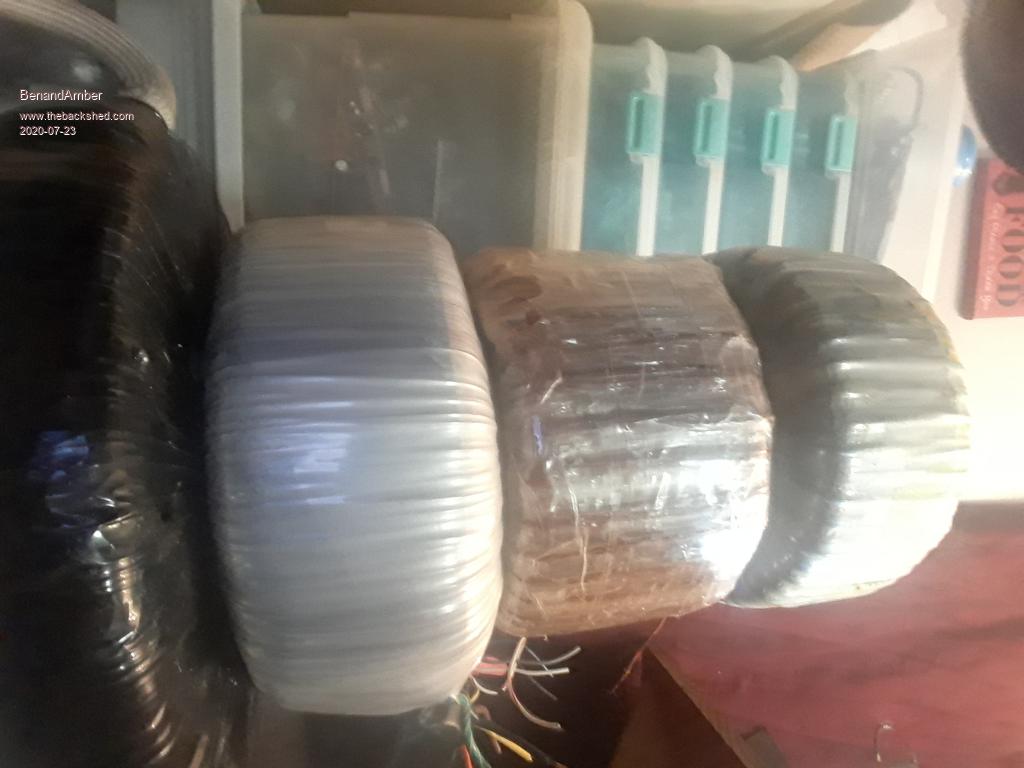

BenandAmber
Joined: 16/02/2019
Posts: 961
Posted: 04:42am 21 Jul 2020
Can you use Square and toroid Transformers together Warpspeed?
If so it there anything you would suggest?
Haxby
Joined: 07/07/2008
Posts: 427
Posted: 04:58am 21 Jul 2020

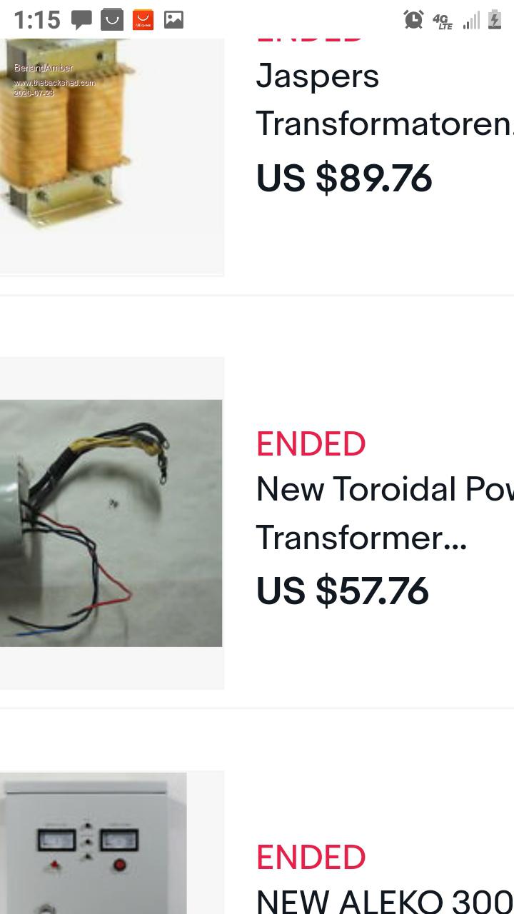

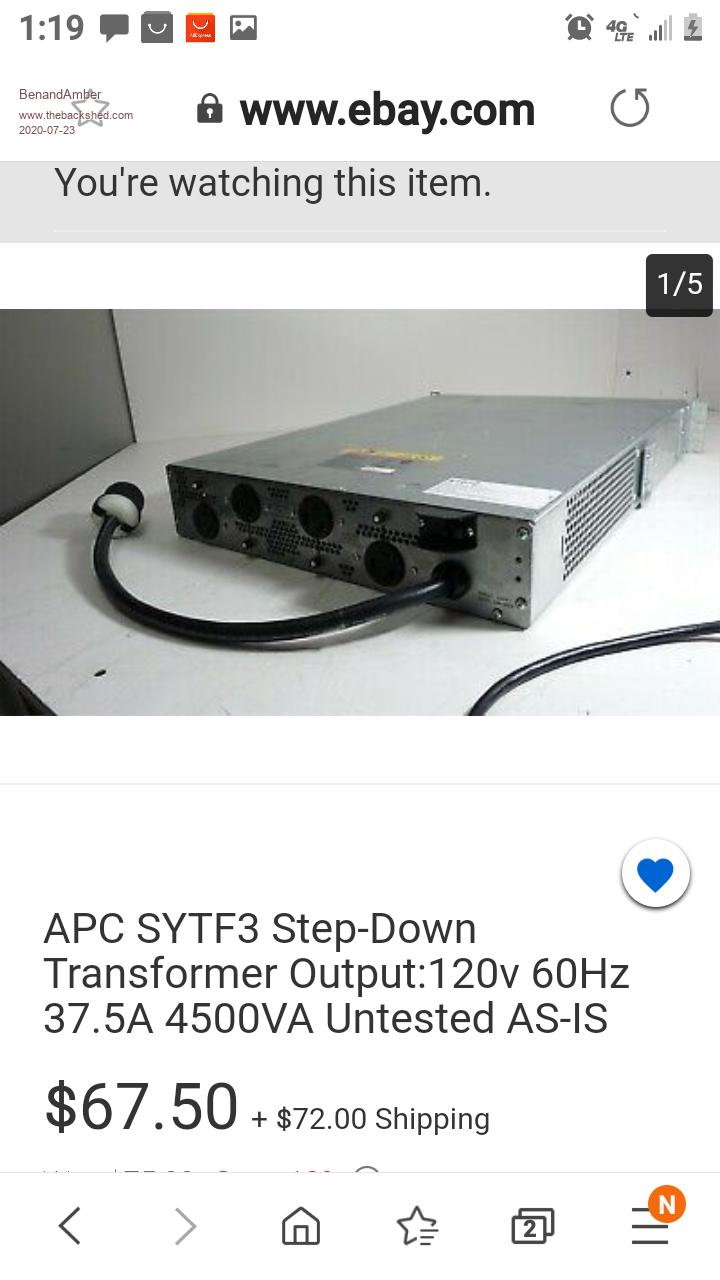

OK I have put up a wanted ad on facebook marketplace for Aero-Sharp inverters, with an offer to buy them for $100 dead or alive. Looks like I will already have one by the weekend!
I guess I should try to get 3 x 3kw toroids, and maybe a 1.5kw with the reasoning:
2x toroids for the large transformer
1x toroid for the medium transformer
1x 1.5kw toroid for the small transformer
1x something else cobbled together for the tiny transformer
sound like a plan?
Murphy's friend
Joined: 04/10/2019
Posts: 678
Posted: 09:29am 21 Jul 2020
  Haxby said  OK I have put up a wanted ad on facebook marketplace for Aero-Sharp inverters, with an offer to buy them for $100 dead or alive. Looks like I will already have one by the weekend!
sound like a plan?
Good plan.
it would help to state the city you are in, I have 1 x 3KW fully working and 1 x 1.5KW plain core here. Shipping is not an option.
