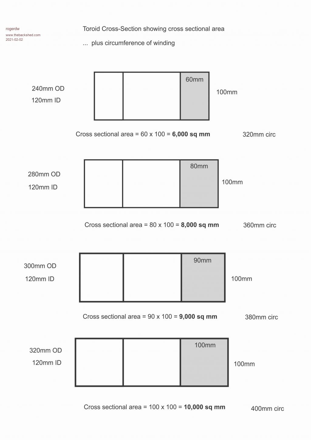

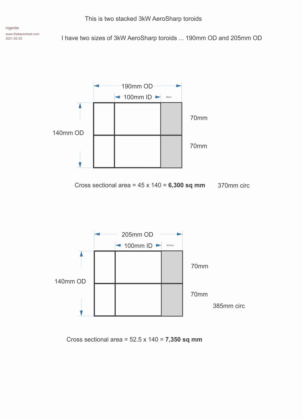

That's very helpful thanks Tony. I know it hasn't been proven yet but I have to make a start sooner or later  ...  and very handy to have some numbers to aim for.
I created a couple graphics showing the cross sectional area of 2 stacked 3kW Aero-Sharp toroids  ...  one pair at 190mm OD and another at 205mm OD
...  and the circumference of the winding area.
Then another graphic showing increasing diameters at 100mm high.
Cheers,  Roger

O/k, let's think about this logically.
We start with a 120mm hole, and if we allow for equal copper areas primary and secondary, the secondary should fill up the hole, leaving 70% of the original hole remaining (actually 0.7071 or root two).
So that we end up with a hole 84mm diameter after winding on the secondary.
We have 18mm + 18mm available for the secondary (120mm - 84mm = 36mm) and we are going to lose 5mm with our spacer. So 13mm depth of copper on the secondary.
If 1.8mm wire is used, six layers might be possible in practice.
1.8mm wire is 2.5mm squared. At four amps per mm/sq ten amps per layer. Wow !!
However many layers we can fit, the last final layer of the secondary will have a diameter of 84mm, and a circumference of roughly 263.9mm.  That is going to be our tightest secondary layer, so that sets the limit for all the preceding secondary layers.
With 1.8mm wire that would in a perfect world be about 146 turns. My guess is a genius may be able to get about 135 turns on max on the tightest last layer.
Anyhow, lets look at how many turns we actually need.
We go to our trusty Flux calculater :
https://daycounter.com/Calculators/Max-Flux-Density-Calculator.phtml
and plug in the numbers:
Secondary voltage 225v for the largest transformer.
Frequency .00005 Mhz (four zeros for 50Hz)
Number of turns by trial and error = 101 turns
Core cross section 10cm x 10cm = 100 cm square
Press the magic button and we get 10,035 Gauss  = 1.0035 Teslas our target flux density.
So five or six layers of 1.8 wire and 101 nominal turns will fit very easily.
We may need to go up or down a few turns to get the turns ratio exactly right, but 101 +/- a few turns would be our initial first guess.
In fact you could probably go down to a 110mm hole.
Should be capable of fifty amps easy for the whole inverter or around 11.75 Kw.
Maybe that is too big for you ?
If so, rinse and repeat with a smaller core, maybe 90mm x 90mm cross section ???
And fewer 10 amp layers.
But remember, a smaller core requires more turns, and the walls can quickly close in on you.
Smaller is always cheaper, and easier to work with.
If you go through this exercise a few times, with a bit of guessing about what will fit, being EXTREMELY conservative, its possible to come up with some numbers that look reasonable.

So I did rinse and repeat with gradually smaller toroids  ...  but that raised a few more questions.
#1 It sounds like it's important to be able to fit each secondary winding in (only) one layer  ...  and not have to have any turns from the first way around, end up on top of the first layer?
#2 I recall you saying elsewhere that it is important to spread the turns out evenly around the core
eg in your figures above with 5 or 6 layers of 101 turns  ...  the first layer could fit approx 170 turns  ...
...  but I should space the turns out so that 101 turns end up filling up all that layer  ...  keeping the ends far enough apart to prevent potential tension  ...   then put a layer or two of poly tape  ...  then repeat.

Posted: 05:52pm 02 Feb 2021
What limits us (and the final power rating) will be how many ten amp secondary windings we can fit onto the core in the available space. There are two main considerations, leakage inductance and winding insulation.  The "nicest" solution is to space each winding as evenly as possible right around the toroid, and layer the winding over the top of each other, with a suitable gap between the start and finish of each winding.
That produces the flattest windings, with the best insulation, or lowest voltage between adjacent turns on consecutive layers.  By spacing the turns evenly around the core, that gives us the best highest possible primary to secondary coupling.
If for example, the secondary were bunched up over only half the core circumference, the sneaky flux always finds the easiest path, and that might be through the air, instead of through the section of core with the secondary wound on it. By evenly spacing the turns it tends to reduce flux leakage, and improves voltage regulation at very high loads.
Yes indeed, the first layer has a huge circumference.
The second layer, due to the magic of circles, and geometric rules, will fit exactly six turns less than the first layer.
Third layer, twelve turns less than the first layer.
By the time we get to a sixth layer, it would be thirty six turns less, or about 134 turns perhaps.
So its an easy short cut to just assume or final layer will be very roughly where our minimum final allowable sized hole will be, about 70% of the original starting hole diameter.
Yup, say 10mm to 15mm between the start and finish of each layer. A very thin layer of insulation, then the next layer. Just keep going until you hit 70% of the original hole diameter.
As Mark says, once you have done this once, you will always think of how it could have been done better, or more easily. The next one will be much nicer and take far less time. Its well worth spending the time to think the whole thing right through, and dont be too ambitious. What you think will fit, never quite works out that well, but it does all get easier with a little practical experience to fall back upon.
  Quote  Should be capable of fifty amps easy for the whole inverter or around 11.75 Kw.
I am assuming that is with five secondary windings (not 6)  ...  and how did you come at the 11.75Kw for the whole inverter?
Yes, being conservative. The wire never goes on dead flat, it always bulges a bit, so how many ten amp layers you can fit depends on the final current rating.
Now the largest transformer needs to generate a 225 volt square wave on the secondary at the lowest dc input voltage, and if we assume five layers and 50 amps that would be 225 x 50 = 11.250 KVa for that transformer.
But the Warpverter has four transformers that TOGETHER create a nominal 235 volts rms.
225v + 75v + 25v + 8.3v = 333.3v peak.
333.3v peak x .7071 = 235.6v rms.
Our secondaries will each be capable of running at 50 amps rms current, to produce a 235v rms output voltage = 11.75 Kva from the completed Warpverter.

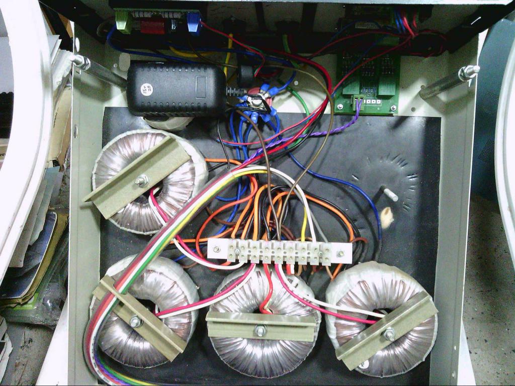

I used 300 watt commercial toroids in mine with 230v primaries.
Main transformer not needed because I was switching +/- 225v dc directly.
Then 3 x 300watt transformers = 900 watts
Then 1 x 300 watt transformer
And 1 x 100 watt transformer (removed for another project in the picture below)
I would not recommend anyone doing it this way.  Having no large transformer can send 225v dc to your house appliances if you have an inverter failure. That happened and did a lot of damage. Never again !!

Ok, so if I order a 300mm OD x 120mm ID x 100mm high for Tx #1  ...  that will give a cross sectional area of 90cm sq
...  and if I use 44V as my lowest voltage  ...
The online calculator gives 112T for the Secondary
112 x 44/225 = 21.9  ...  so 22T for the Primary
Tx #2  ...  a 3kW toroid  ...  cross sectional area of 36.75cm sq
The online calculator gives 92T for the Secondary
92 x 44/75 = 53.97  ...  so 54T for the Primary
Tx #3  ...  a 1.5kW toroid  ...  cross sectional area of 26.08cm sq
The online calculator gives 43T for the Secondary
43 x 44/25 = 75.68  ...
If drop to 42T for Sec  ...
42 x 44/25 =73.92  ...  so 74T for the Primary
I haven't fully unwound my #4 Tx so not sure of the dimensions yet.
I wasn't really aiming for ridiculous levels, but if I'm going to do this I'd rather do it just the once and do it well. It sounds like I should be able to fit 6 layers for each of the secondary's  ...  so that's 60 amps. Phew!!!
Am I on the right track Tony, or am I off in the scrub somewhere?
