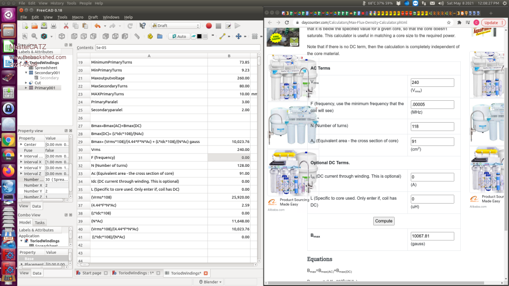

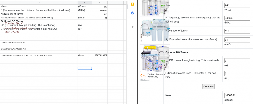

Bmax(DC)= (L*Idc*108)/(NAc)
what is L ?
not having much luck getting matching answers
using that webpage with your numbers
240Vrms 0.0005 mhz 240turns 4.8cm2 9384.38 gauss ?
and my CAD spreadsheets doing 10,135.14 gauss
if it was 9.1cm2 would you do 128 turns ? or 118 ?
just trying to work out where the variance is coming from my guess CAD is rounding up somewhere
yep cad rounding damn their goes that idea
(4.44*F*N*Ac) = 2.585856 not 2.59
Edited 2021-05-08 11:47 by MasterCATZ
Howdy MasterCATZ, sounds like a pretty gutsy machine needed. Good luck with it.
Not sure if you had a typo in your reply or you missed the detail  ...  but it is .00005 Mhz (four zeroes).
Cheers,  Roger

well their was that as well but did not affect the formula I just had to change to 91cm2
so the above question would be if you had 91cm2 how many turns would you do ?
I am leaning towards 128 as most seem to work it out from 260v ironically that is the number my rounded up cad gave me working with 240v
but working it out with 10,000 guass the turns seem higher ?
OzInverter with the 91cm2 did 80 Turns saying each turn was 3.25V?
back to being unsure who's maths to use?
Solder Seal Wire Connector Marine Grade Heat Shrink Wire would these be usable for joining wire in a transformer ?
if anyone knows how to stop freecad rounding I am all ears
google spreadsheet seemed to be closer still not a match
Edited 2021-05-08 12:48 by MasterCATZ

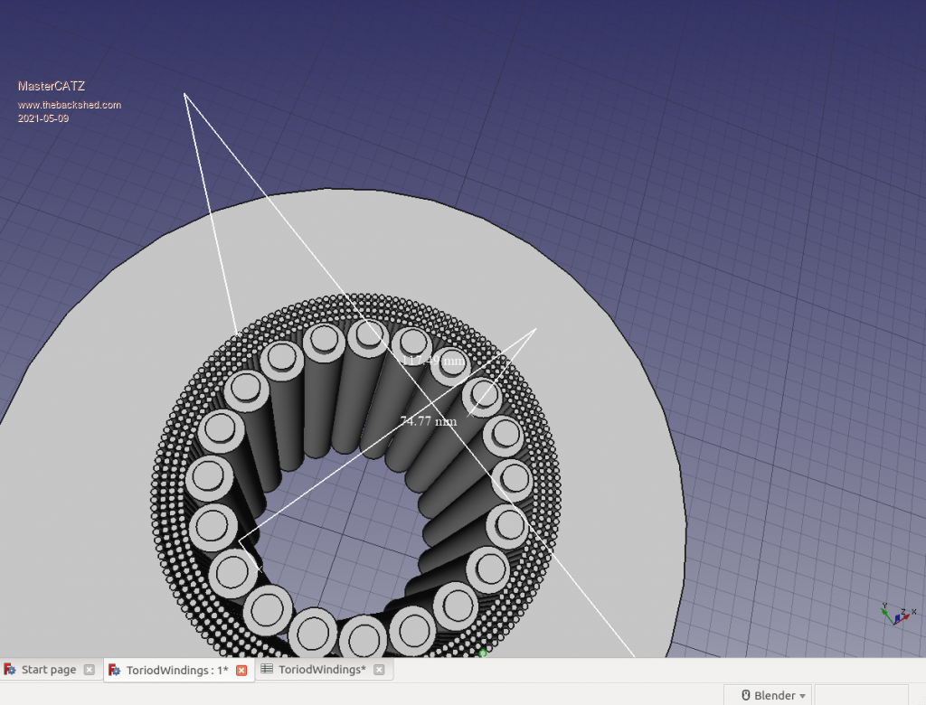

what is the math to find the amp / watt limits of a toroidal transformer based on kg / mm2 ? , it will be running in a hot shed
using the example I found of their OzInverter online (assuming v1) it said
"4off /4 in hand, 1.8mm diameter at 118 turns Secondary, and 50mm/2, 14 turns, Primary"
I am assuming that is 4x parallel Secondary 2.5mm2 = 10mm2 per wind = 1180mm2 ?
and I think that means they used 50mm2 14 turns for 700mm2? or is it 2x parallel for 1400mm2 ?  7.98mm dia ?
and would perfect world wire matching be 1180mm2 Primary / Secondary ?
or is the equal cross sectional areas of the hole including the voids ?
ie) 91.8mm diameter (external of secondary wire ) - 90mm diameter
(internal of hole )= 6 618.74 - 6 361.73 = 257.01mm2
and now I am wondering why that is smaller mm2 then 1180mm2  when I was working of each wires mm2
*edit* oh I see they would have to overlap only ~150 wires fit arround the core
97.2mm diameter (external of 4th secondary wire ) - 90mm diameter
(internal of hole )= 7 420.32 - 6 361.73 = 1058.59 hmm still a bit off
99.78 diameter (external of Primary wire )  - 91.8mm diameter (external of secondary wire ) = 7 819.46  - 6 618.74 = 1200.72 mm2 ?
sorry for the question I want to get started but I think it will be built before the book ever arrives ... especially with covid around
the other thing will be to sort out chokes , binding it tight seems to be the goal
how do you determine how many turns / wire thickness same as Primary?
and the final would be AC filter
Edited 2021-05-08 17:43 by MasterCATZ

I've been meaning to mention this calculator for winding toroids for some time  ..
Toroid Winding Calculator
Just bear in mind that where the calculator asks for wire RADIUS  ...  put in DIAMETER  ...  otherwise you may get a surprise when you go to wind it.
I did email them and let them know  ...  but had no response.
If I input the actual wire DIAMETER instead of the RADIUS  ...  the calculator is correct with number of turns and also very close to the actual length of wire I used as well.
My crude method for working out the likely number of turns that will fit in just one layer is to reduce the diameter of the hole by the diameter of the wire ...
...  work out the circumference of that circle  ...  then divide by the diameter of the wire.
In my experience that has worked out well enough for me to predict the result very accurately.
Cheers,  Roger

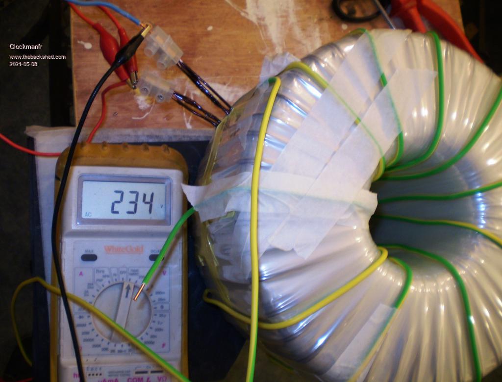

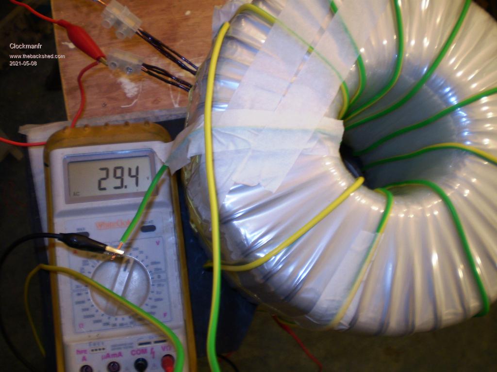

TESTING ...... Big OzInverter toroid test, just using a 2.5mm2 test primary wire. ....... 234vac going in the secondary's
80 turns, after the step up light bulb process .... and 29.4vac reading on the Primary. So our initial winding calculations are correct. Remember if in doubt a few more secondary windings will not hurt. See test procedure later in Chapter.
The two photographs below, show the 8kW BigOzInverter toroid under testing, but here it has a temporary primary
cable/wire. The 8kW BigOzInverter has a secondary of 80 turns and a primary of 10 turns.
Remember we want the primary to read between 28vac and 30vac, and the below photo shows 29.4vac, that's good.  1st pic shows 234vac going in.
I trust this helps explain, but all the details are fully explained in the 2nd Edition.

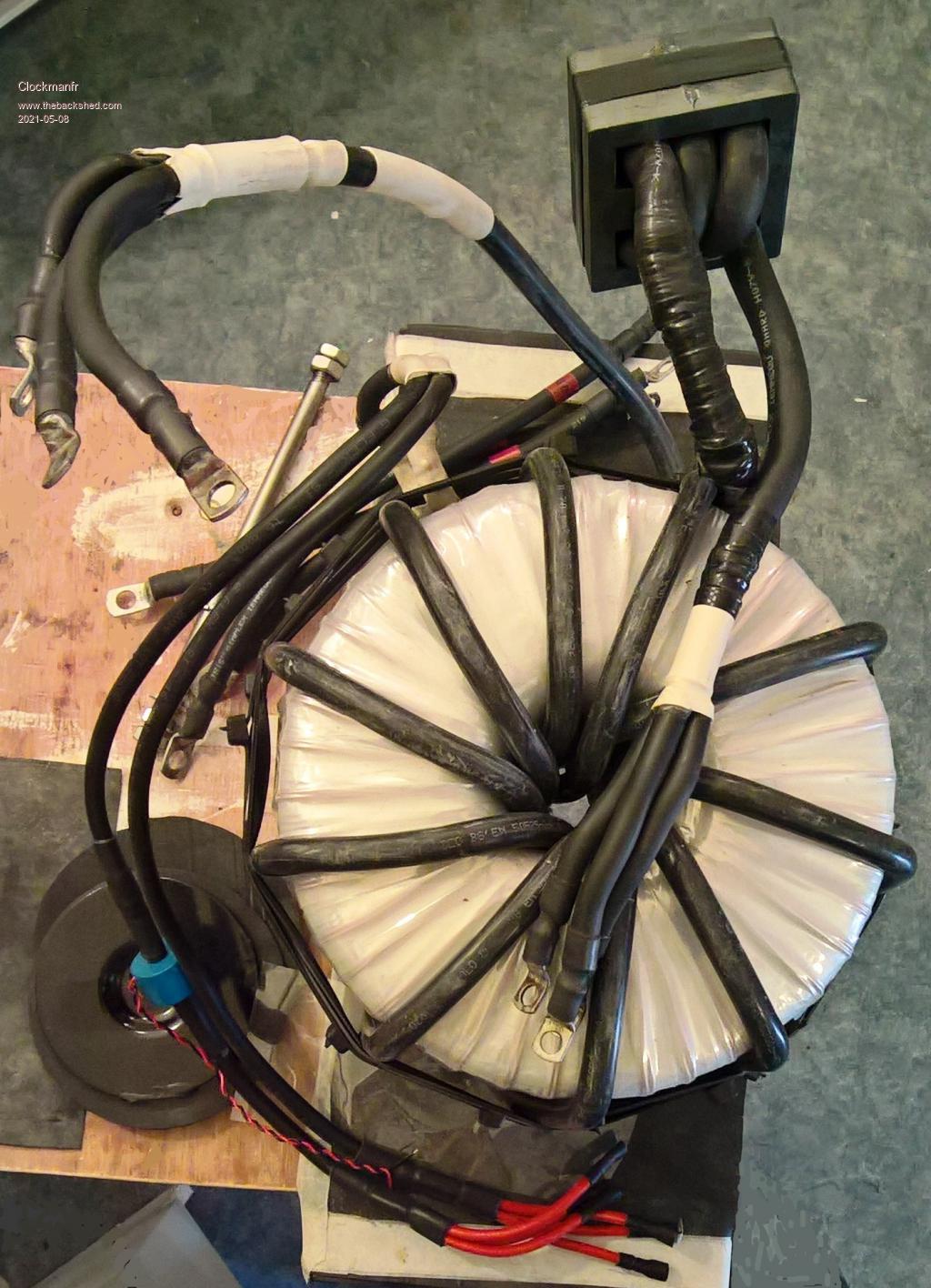

Here is the 8kW OzInverter toroid assembled.
Thats a 52kg lump.
