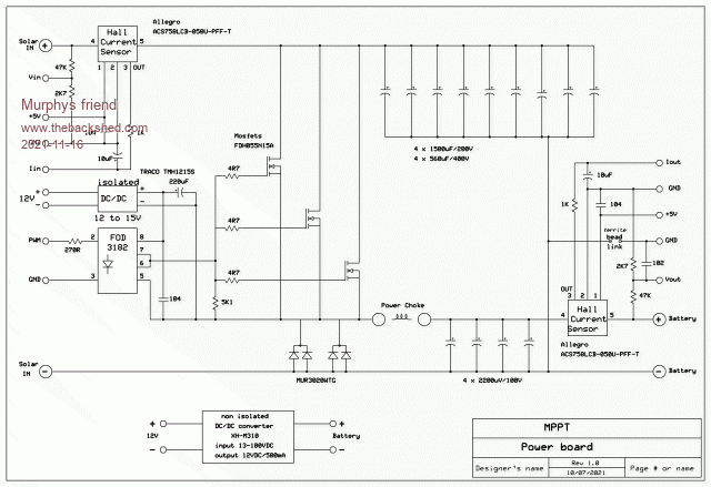

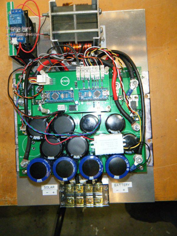

This project is based on Poida's & Wiseguys inputs to this forum. I did my own PCB to fit an existing (ex Victron energy)heatsink.
With help from a local programmer (Gaspo) I got the two nano's programmed. Nothing blew up when I powered it up but I ran into calibration issues, most likely due being last in class with regard to inputting data.
Anyway, I managed to set Vin and Vout no problem but do not quite get that "set the zeros for the two current sensors" part.

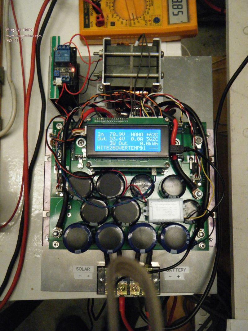

My build, no display fitted:
And powered up:
As it is not doing any MPPTing yet your input would be very much appreciated.

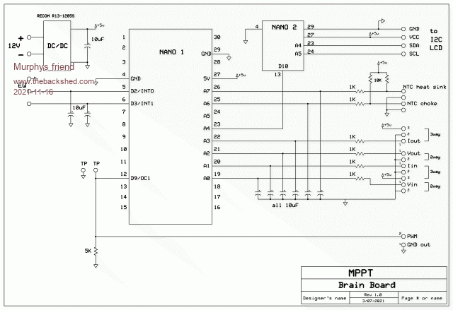

First line:
Input voltage, Input current and heatsink temp.
To see sensible values you need to calibrate the input voltage and current
and have a 10K NTC thermistor connected to the system.
And tell it which way the thermistor is connected - ground or 5V..
I need to know the firmware you are using.
Second line:
Output voltage or battery voltage, output current and inductor temperature.
Third line:
the output power. This is Vout x Iout. If either of these values are rubbish
then this power calculation will be rubbish.
And the accumulated energy. This is power (in Watts) x hours
Fourth line:
The operating STATE (one of MPPT, NIGHT, ABSORB, FLOAT,EQUALISE)
Then 2 digits counting up from zero to 60 (ie second counter) that is
showing when it will check again if Vin is high enough to be useful
and change mode from NIGHT to MPPT
The next number is the target voltage. This is what the code will want to
get the Battery or Vout terminal to.
Of course it will change depending on STATE (ABSORB or FLOAT)
I have and use a version that uses the inductor sensor input as a battery temperature
input and then adjust the target voltage to suit depending on the battery temp.
I do not care how hot the inductor gets, they feel no pain.
But I do care about overcharging the battery.
The next number is PWM width in 8MHz clocks, where 1 = minimum width
and 799 is FULL POWAH!!
NAN means uncalibrated or unconnected input.
Tell me which firmware you are using so I can get on the same page.

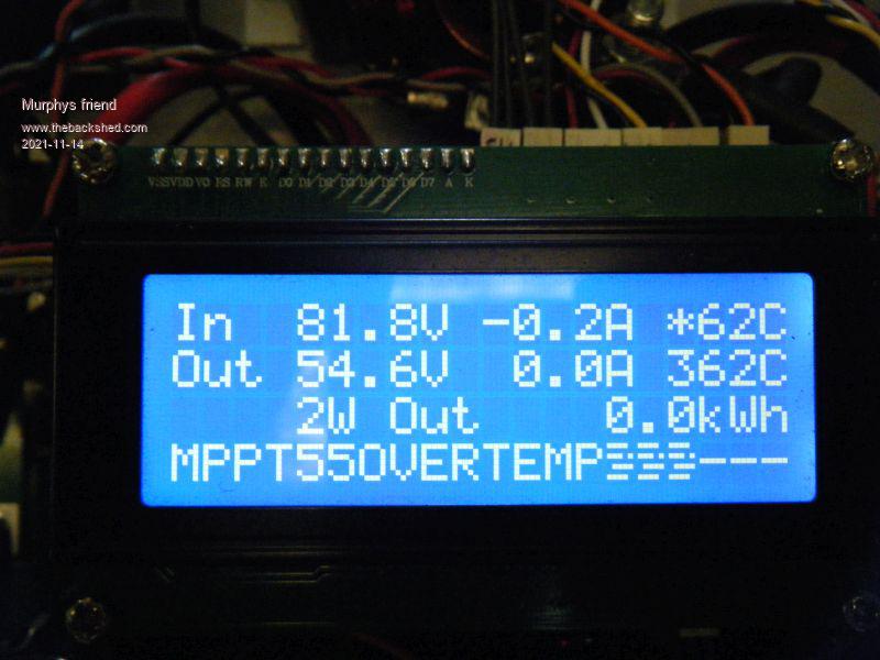

The display now reads this:
Could that overtemperature reading prevent it from mppting?
I do not have a battery temperature monitoring installed, these 200Ah lithium cells do not seem to get warm even with 100+ Amps charging them. All I need is the mppt to stop charging once the absorbing time has finished and the Voltage stays below 58V.
This home built MPPT is meant as a reserve unit to my other 2 charging methods (2KW back charging via inverter and a60A Outback MPPT charger)
gaspo
Joined: 25/06/2018
Posts: 67
Posted: 09:31am 14 Nov 2021
Is the first thermistor you are using 10K NTC? It seems to read too high: 62C.
If you are not using second thermistor input connect 10K resistor in its place, should then read ~25C.
Edited 2021-11-14 19:42 by gaspo

  gaspo said  Is the first thermistor you are using 10K NTC? It seems to read too high: 62C.
Thanks gaspo, good idea. I measured several "10K" thermistors I have here, they measure ~8KOhm at room temp.
I'll make some plug in 10K resistors tomorrow and see what that does - easy mod.

the message "OVERTEMP" means the code sees an over temperature condition and
has stopped mppt-ing.
Maybe get back into the menu and disable overtemp shutdown by setting
heat sink max temp to something large, 1000
I like putting a 10K on the thermistor input pins.
This will make them 25C and this will be so for both choices
of wiring...
The calculated temperatures are only gong to be close to reality
when you use 10K NTC thermistors
AND
you have correctly set the option in the menu
"3 - NTC 5V or GND         (= 1 if 5V, = 0 if GND) "
If your thermistors have one pin connected to ground, then
you choose 0
If you have one pin connected to 5V supply (high side of voltage divider)
then choose 1
The firmware needs to do different calculations of the voltage divider
depending on the position of the NTC thermisors in the circuit.

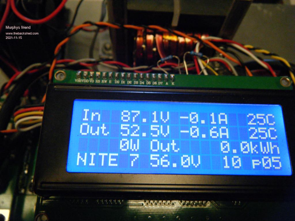

I now get this display (with 10K resistors fitted):
Unfortunately the nano has now decided to remain in the 'NITE' condition, any suggestion how to wake it up?
The voltages shown are what I measure at the terminals. No current since its asleep.
Thank you for your patience with my MPPT build.
poida
Joined: 02/02/2017
Posts: 1485
Posted: 05:57am 15 Nov 2021
have you set
M - Night power          (in Watts)
yet?
I have it as 5 Watts.
If it's not set yet, it might be NAN and so the mppt scan probably will
fail, and then no transition from NITE to MPPT/ABSORB

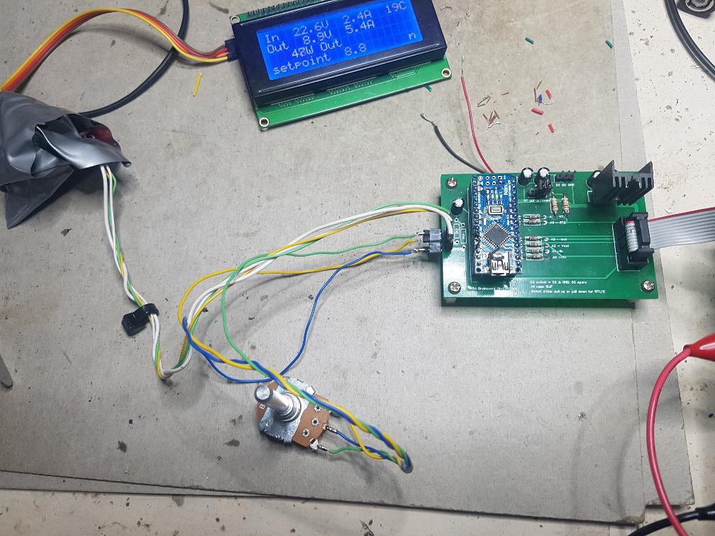

Maybe you could try running the buck converter firmware
on your power board.
This code will take the voltage present on A5 pin on the nano as the
drive for PWM width.
I have used this code very often (in particular, to characterise various inductors)
and it always works. It always drives the mppt board hardware well.
You will need some sort of load on the "battery+" and ground terminals.
I am wondering what exactly you have built and what signals are present.
the buck converter code is pretty simple.
It prints out on the nano serial console Vin, Vout, Iin, Iout
using manually set calibration factors in the code. Easy to adjust.
I have a potentiometer set up, with ground and 5V on both ends and
the wiper going to A5. The LCD is also active, showing this data.
The code will prove the hardware works.
The code takes the potentiometer setting as the required output voltage
and then adjusts PWM width to get it to be this value.
Current values are ignored. Just output voltage is to match the pot setting.

  poida said  the steady stream of narrow pulses is normal. It is the 1 clock wide PWM pulse.
I am wondering if both current sensors are showing correct values.
Should the input current sensor be wired backwards, increasing current will make
for negative power during the mppt scan.
Hmmmm. I followed wiseguys PCB layout for the Allegro sensors. Mine are oriented at 180 degrees to his though. From the specs I see pin 4 is the input for unipolar devices so solar IN goes to pin 4 of the Iin sensor and choke out goes to pin 4 of the Iout sensor.
I'll do some measurements tomorrow and enter them on my schematic so I can show them here.

I just fired up my mppt board (Wiseguy's PCB) using 050U type Allegro current sensors.
I use this code
buck_converter_WG_b4_nano_sserial_bb.ino.zip
The code's calibration is
 xVin = 0.1564;
 xVout = 0.102;
 xIin = 0.0792;
 xIout = 0.0792;
 tIin = 0.00;
 tIout = 0.00;
 oIin = 127;
 oIout = 127;
 octrip = 0;
Note the oIin and oIout values. These are 127.
This means the offset for zero current is 127 ADC counts or about
127/1023 x 5V or about 0.62 V
xIin = the scale factor for the input current sensor
In this case it's 0.0792
To get Amps, convert the input to the usual 0 to 1023 counts from the ADC
Let's say it's 300
to get amps we go (300 - 127) x 0.0792
This ends up being 13.7 Amps
You get the idea?
Same for the output current sensor.
It uses it's own scale factor xIout
and it's own offset oIout
In the case of my build using Wiseguy's PCB and 2 Allegro 050U type
50 Amp sensors I have offsets for the sensors that are the same.
And scale factors for both sensors that are the same.
It is running, with the pot set to 8.8V on the output and the device has got
8.9V on the output.
the buck converter code (like the zip file above) does not care at all about
input current or output current.
It just works at one thing, to make the output voltage = the pot setting.
This will be good to see if your current sensors are working as you expect.
Edited 2021-11-15 20:34 by poida
Murphy's friend
Joined: 04/10/2019
Posts: 678
Posted: 06:09am 16 Nov 2021
Thank you for that, I'm now almost sure its the  current sensor calibration that's holding me up.
I  get 'G' =119 and 'H' = 118 when I do the zero sensor part of your setting up instructions.
Unfortunately doing your suggested buck converter bit requires messing with programming and I have all left fingers when it comes to that. So I prefer to have somebody who knows doing that and I will ask if there is no *very* easy way to change that 119 ADC count to 127. Instructions for dummies anyone? .
I have an oscilloscope hooked to the PWM output of the nano and was watching the narrow clock pulses you described earlier. They actually change in width, occasionally, for a whole 60 second cycle they are wider.
But no current flowing in or out of the MPPT board.

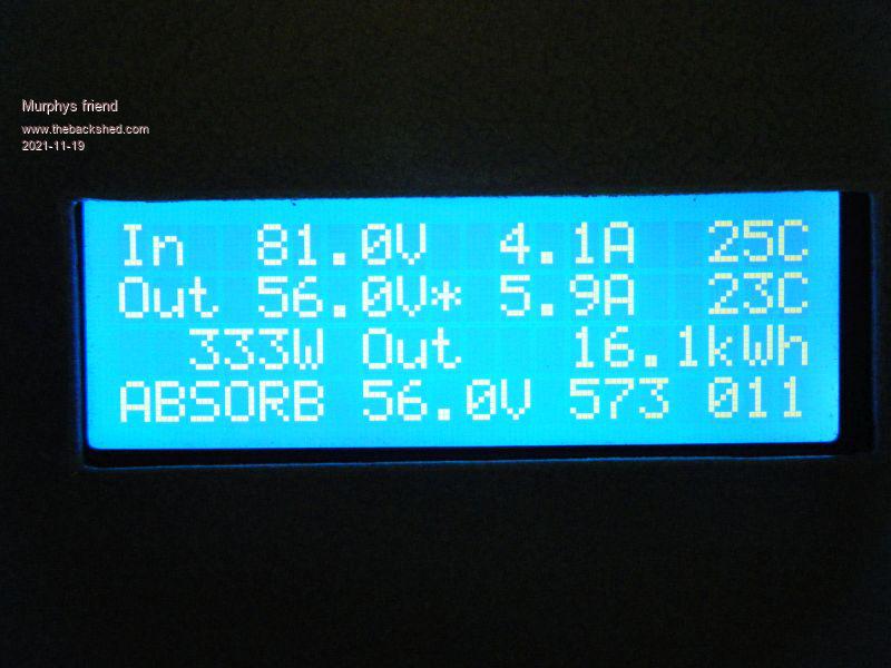

Murphy's friend
Joined: 04/10/2019
Posts: 678
Posted: 06:46am 16 Nov 2021
OK, While I have been sitting here watching that CRO trace something in the nano woke up and the pulse tops are  up to 50us wide at times. Output power shown is around 55W and 1A Iout which tallies with the battery voltage.
I ran the batteries down a bit before that to entice charging but that is quite poor at present. How much charge current could I expect with nearly full width PWM pulses?
I'll add my schematics below:

Posted: 07:00am 16 Nov 2021
Thank you for those very good suggestions.
I  did the 'E' and 'F' cal. amps set up with 8 Amps flowing through the allegro sensors in the right direction. I used the nano display to show that, did not think of measuring the sensor output voltage directly but will do that next.
Pin 6 @ 7 of the FOD3182 are linked by a PCB track.
I did look earlier at the mosfet gates and saw nothing, I just looked again and still nothing, what should I see there when its MPPT ing?
There is 15.9V at pins 5 to 8 of the FOD3182.
poida
Joined: 02/02/2017
Posts: 1485
Posted: 09:04am 16 Nov 2021
The Gate should show about 15V pulses compared to the FET's Source pins
which is the inductor connection.
You can not and must not use DC ground as a reference for the Gate pulse
measurement/probing.
If you do you will short the solar array input positive to ground
and bad things will happen.
Lucky you have a small hand held CRO so it can have it's ground lead
connected to the FET source pins (pin 3, right most pins)
and then see the voltage applied to the Gates.
These pulses should be nearly the same as the pulses coming out of the nano
only not 5V, but 15V
