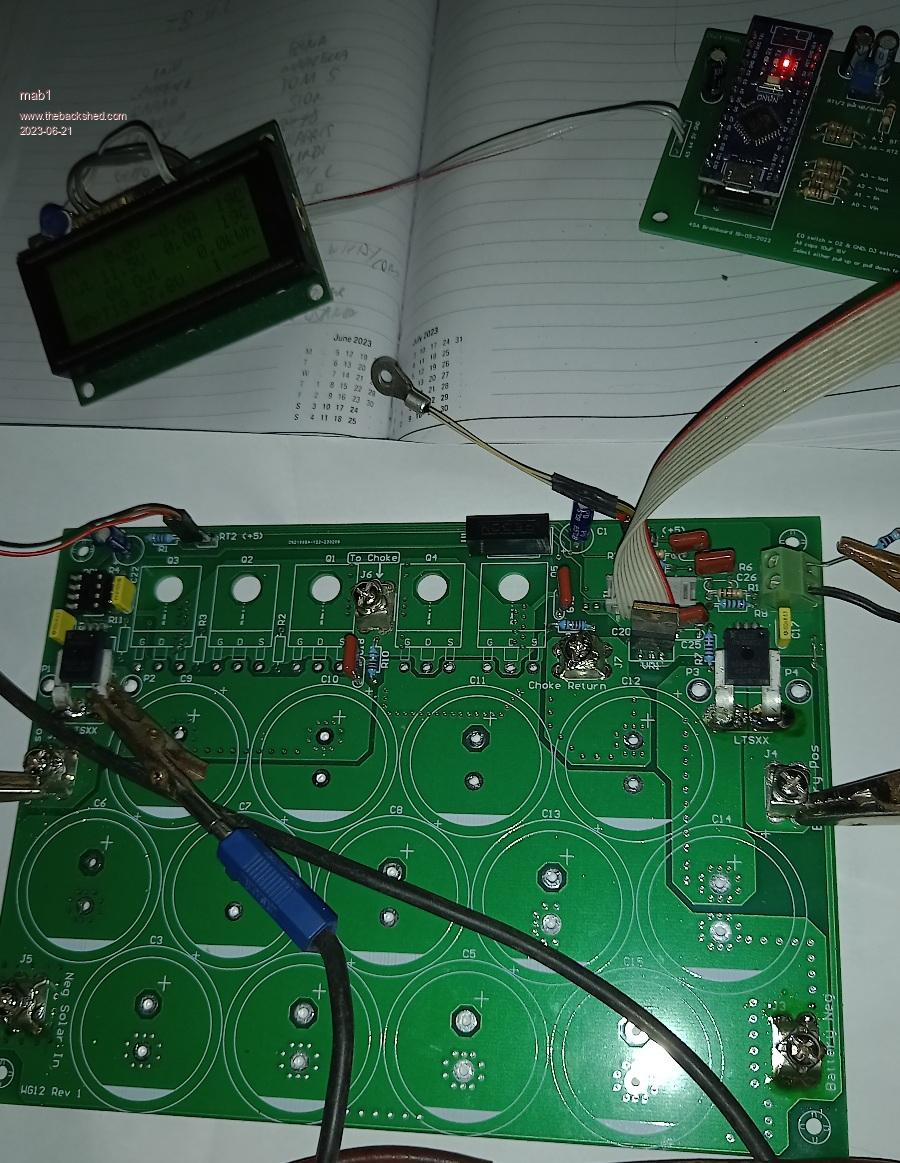

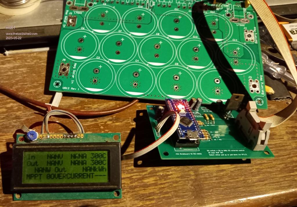

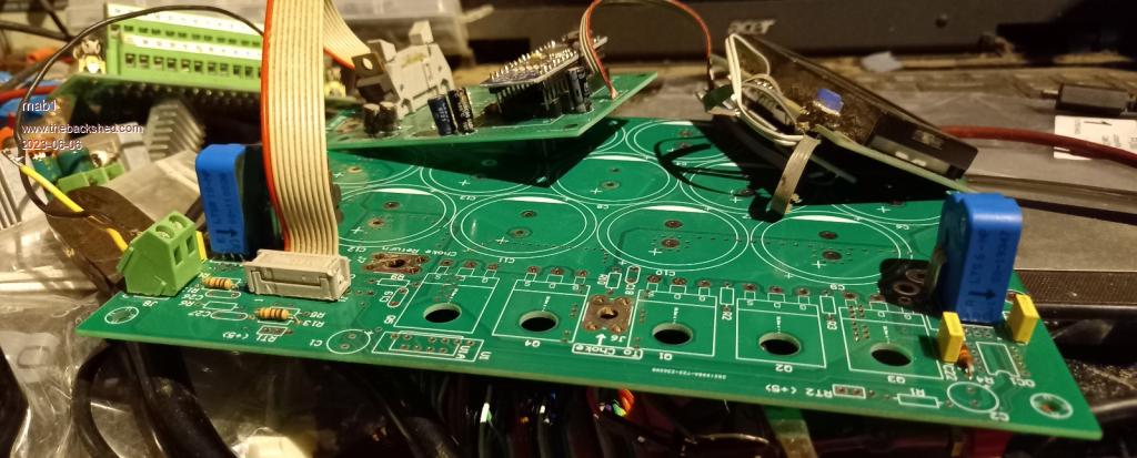

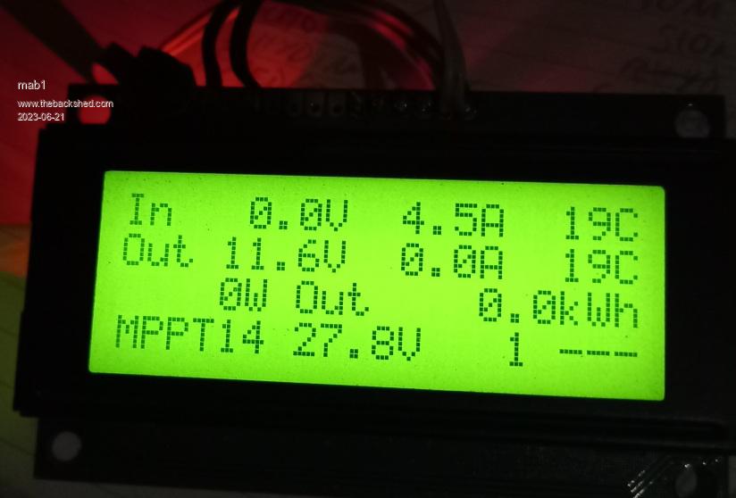

Thought I'd add mine as there seems to be a run of these builds developing - and i finally have a bit of progress to show.
As I've never done Arduino before i decided to start there:

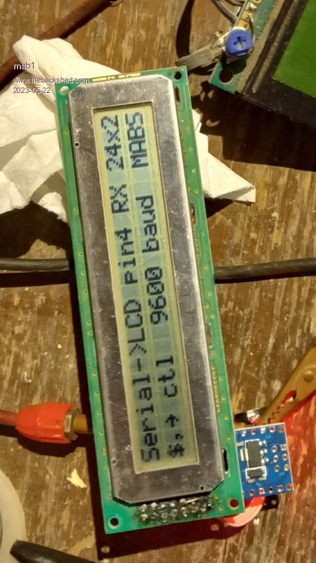

The pic of the 20x4 LCD didn't come out too well, but as i got a job lot of nanos i decided to convert this one too as it'll be a lot easier for a future project especially as it has a confusing 2x7 array of pins instead of the usual 14 or 16 pins in a row.

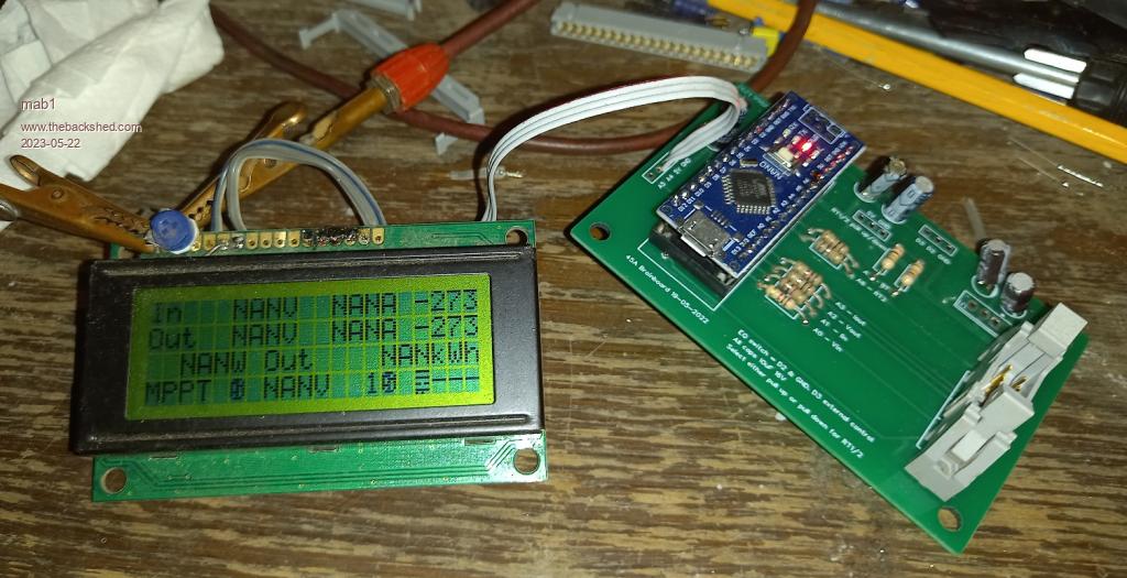

Here's the mppt 20x4 LCD actually receiving data from the mppt nano - although I'm not sure I've got the best version of the mppt code - as I'm moving to liion batteries i don't need absorb/equaliation/float voltages, but then i guess i can set them all the same in the code.
And here's the whole mppt as far as I've got it. I'm currently trying to salvage as may bits as possible from junk pcbs (managed to find two 7805s following my voltagr regulator question on the other thread). I expect to have to buy some bits but I've got an aerosharp inverter, and a santerno inverter both of which have lem current sensors and big caps. Surprisingly with all the junk here I can't find a single 1nF capacitor.

Mab1, great to see all this progress. The size of the heatsink will
let you run it at 45Amps or more if you got the panels and the load.
I am really happy to see the Arduino stuff was no problem too.
Once you've built the boards calibration is the final job to do
and it's not a huge issue. Just do one thing at a time..

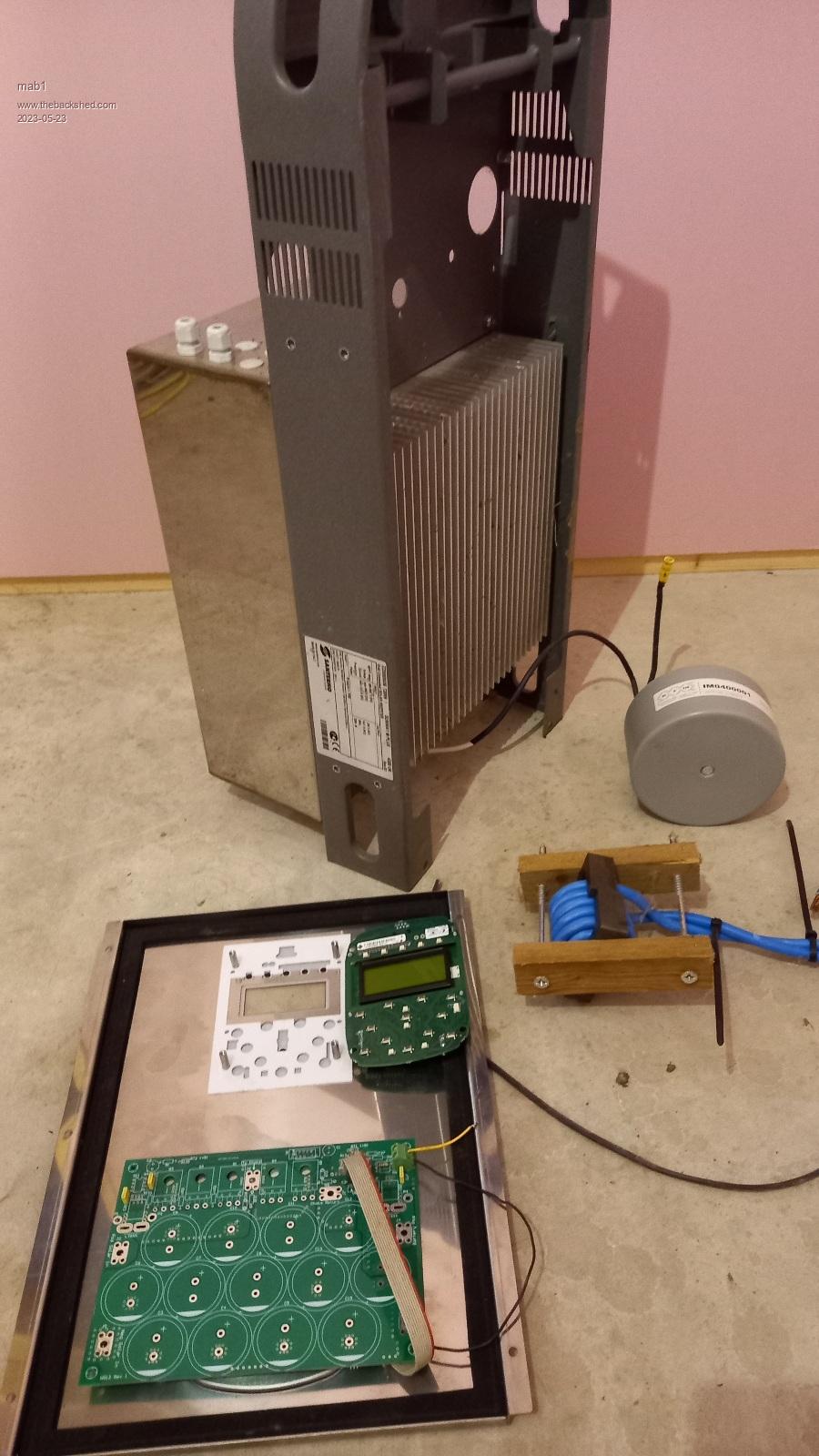

Talk of big heatsinks made me think of the case of the santerno inverter: i originally acquired two of them as donors for an inverter build (3.3kva toroidal transformers),  but as long as the powerjack keeps going that project's low priority. Looks like a good home for the mppt, although i might have to grind off the top bit where the toroidal tx and inductor were mounted.
It's a big stainless box with a massive heatsink, with a 20x4 lcd already mounted on the front face (why didn't i think of it before?!)
The round grey thing is a 5mH inductor that was in series with the 180v primary of the transformer, so must have been rated for 18A. Might be worth un-potting  and adapting it?
The ferrite Ecore inductor, wound with 11 turns 25mm2 blue wire is one i put together for the inverter build, but then read some more and realised it would saturate at ~40A or so IIRC (about 50uH as is), so it might be more suited to the mppt, but I'm not really ready to think about inductors yet - need to finish the mppt main board first. Only room in my head for one problem at a time

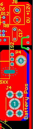

one thing to look at please Mab
the link between logic and control ground and noisy ground.
This must be made. If it's not there, we get the things that are happening.
See the Green line?
Wiseguy designed this with the intention of having a ferrite bead on the link
to help reduce the noise on the analog inputs into the nano.
In testing I found no improvement.
No link will give us the sort of results we are seeing now.

Hi poida,
Well, I hadn't made that link between the power ground and the logic/control ground, but whilst I'm reluctant to question the advice of The Master, Yoda,   , as i haven't fitted any of the power components - caps, fets, diodes - and was powering the board via the 12v input (i.e. no connection to battery or pv inputs), i didn't think the ground link could affect the current sensors.
I have made the link now and added the rest of the passive components on the logic/control side, but still cannot get an output voltage from either LEM.

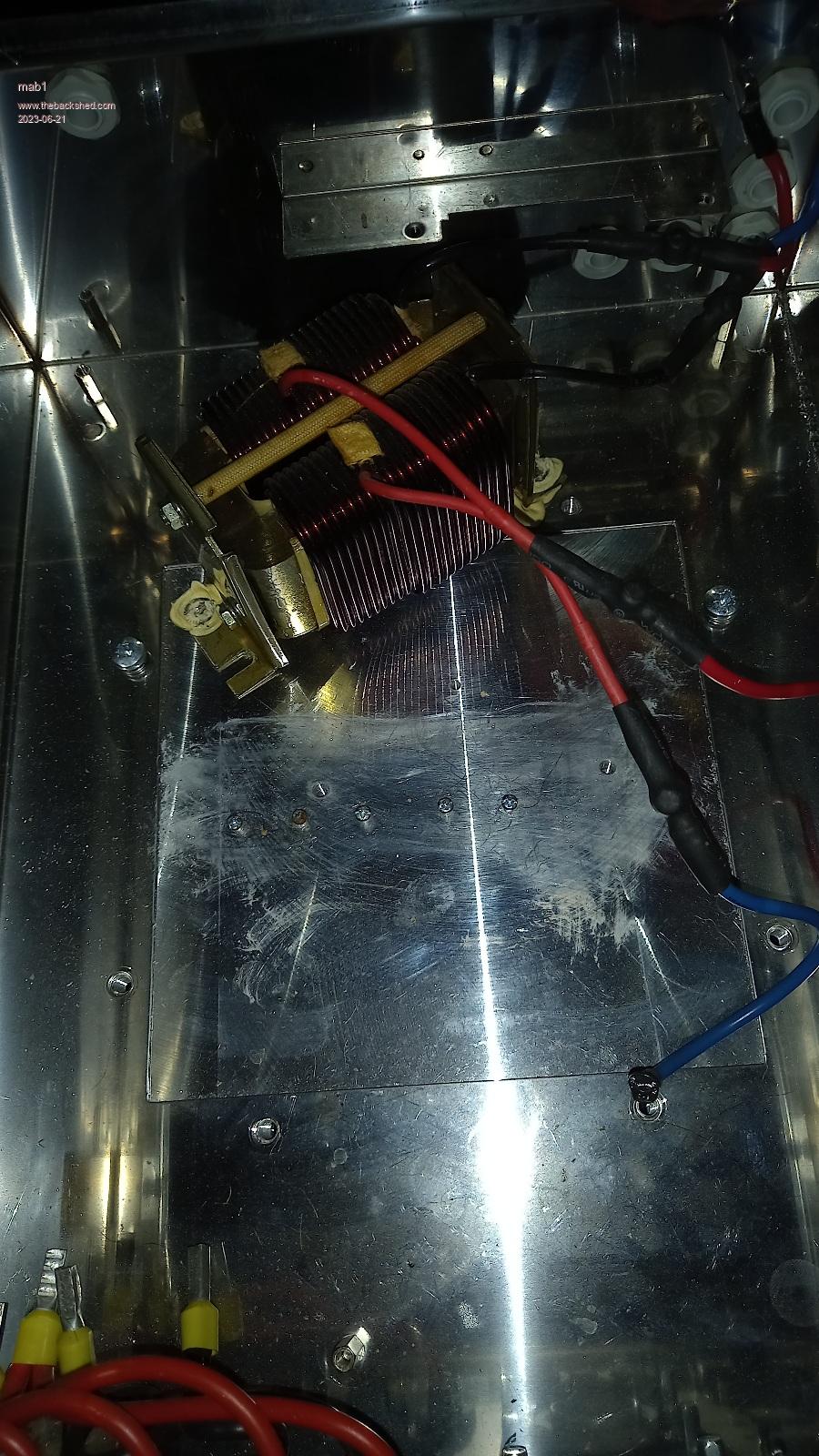

Also realised this lcd has a backlight    - but it draws 200mA! Makes the 7805 run hot.
I have drilled & tapped 5 holes in the heatsink for fets & diodes and i do have some of the recommended 150v fets and 200v schottky diodes ( and Fod3182 optos), but am now wondering if i should get some 200v fets as i would quite like to use one of these mppts on a 4-series array with a vmpp of about 140v. Also just realised I'm a bit short on insulation washers for to247   there's so much to think of when making orders.
That's the heatsink with 5 M3 screws and the monster inductor from the aerosharp - still got the whole inductor modding &  testing thing to look forward to.

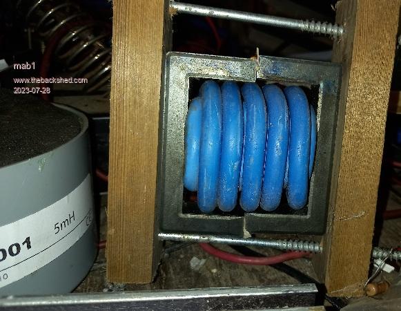

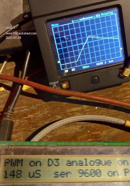

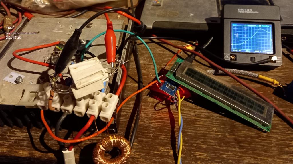

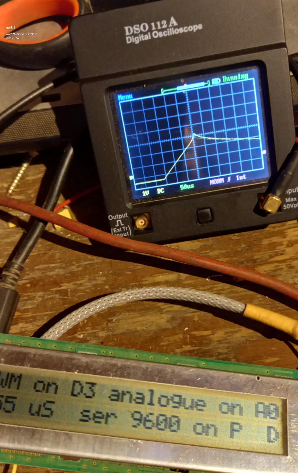

Ok, I've finally started looking at inductors: I've reprogrammed the nano with the 24x2 lcd to do pwm. It works from about 6uS up to 1023uS and runs at about 100Hz to allow the inductor current to fall.
Using an 06CN10L (60v 100A to220) mosfet along with one of the 200v schottkys that will be going into the MPPT unit.
Testing the inductor setup with a little torroidal inductor
Tried my big ferrite that i wound a while ago with 11 turns of 25mm2 . I originally made this with an inverter build in mind, but that was before i learned that it would saturate at too low a current to be useful.
Depending on wether i have 0.5mm or 1mm of cardboard in the gap it's either 55uH and 30A saturation or 42uH and 50A from memory (didn't write it down), but 25mm2 is overkill so I thought if i can get more turns of something smaller in there,  and a bigger gap it might work for the MPPT.
I want to run 4 panels in series, vmmp 130v, into a 24v battery. Using this online calculator:
http://schmidt-walter-schaltnetzteile.de/smps_e/abw_smps_e.html
i reckon i need 100uH and that would give me a ripple of 10A at 20kHz.

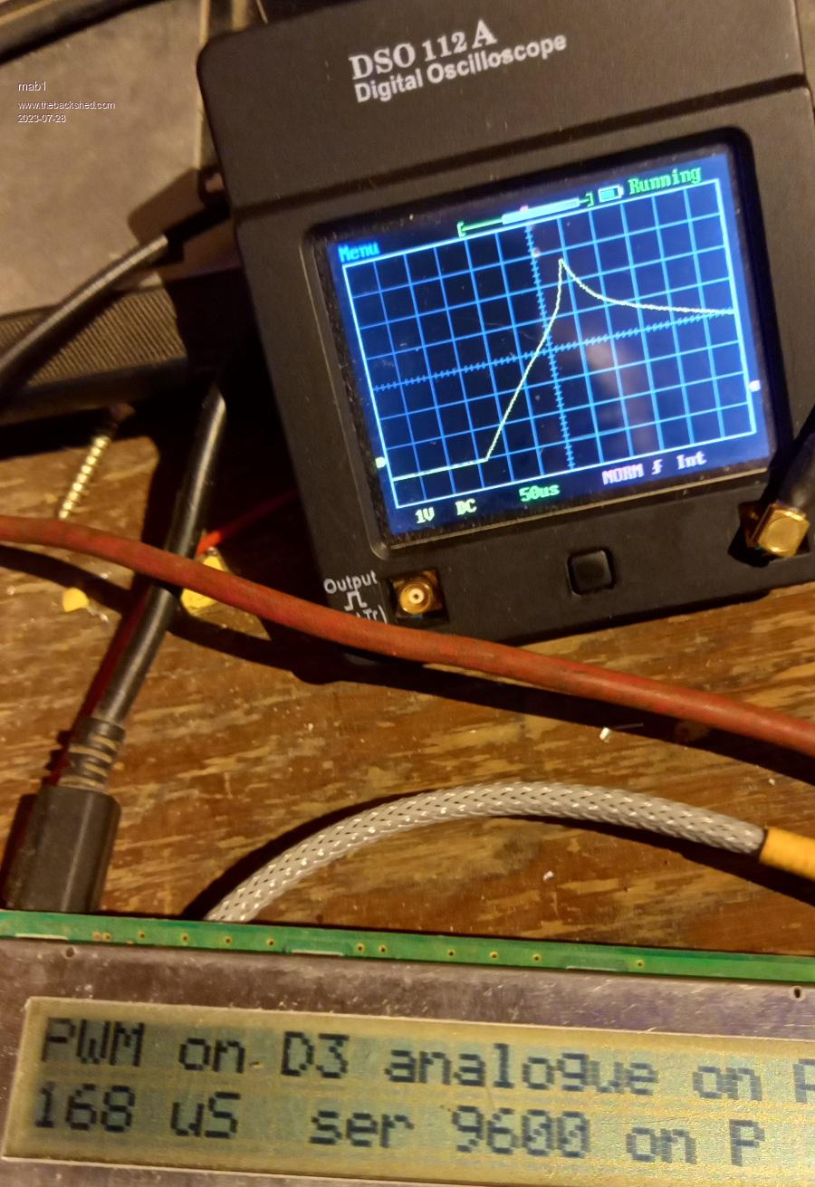

So, with 24turns of test wire i get these results:
1.5mm gap (three card layers)
Thats about 30A, and i calculate 145uH (scope reading 'current' using 0.1ohm shunt resistor; 30.5v supply).
2mm gap, 4 cards
35A, 121uH
2.5mm gap, 5 cards
40A, 106uH
Saturation peak
Turned back to below saturation
5 cards in the gap
Edited 2023-07-28 05:03 by mab1

So, some advice please, on the subject of building inductors:-

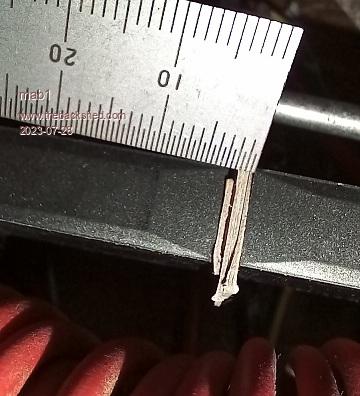

I'd like to make this ferrite work in this mppt, if possible, but to stay above 100uH and increase saturation to maybe >60A, i would need more turns of wire and a bigger gap.
1. How big can i reasonably go with the gap?
2. I seem to recall advice against big solid wire due to skin effect - if you have 7 strand household wire (like the blue 25mm2 above) does that count as 7 in hand? or as they are touching and not insulated from each other, do they work as one solid wire?
I need to decide what sort of wire to use as that determines how many turns and what wire size i can use.
3. What do you use as gap spacers? Even with the clamp screws tight it gets quite noisy at 50A. Or can i use card, but with epoxy or similar to glue it in the final form?
I do have a 2nd pair of these ferrite cores, so i could just double them up, but then I'd like to save those for the 2nd mppt if possible
Once you get over 1.5-2mm with ferrite cores I have found little difference as the gap gets larger. 20Khz is really too low for that type of core, would work better at approx 100 Khz or higher, see if the code allows a higher frequency near 40 Khz or more.
The multi-strand un-insulated wire acts as a single strand, you require multiple insulated strands; I use 0.56mm dia. multiple strands (each good 1 amp) for best efficiency, least heating.
Cut couple pieces scrap PCB material, 1.6mm standard thickness for your spacer, this wont compress as you clamp halves together.
Mike
