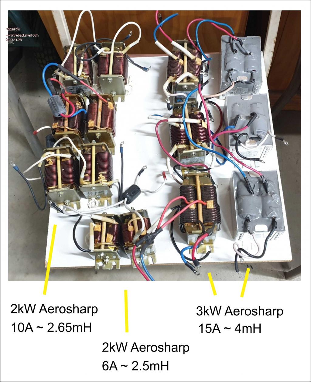

Hi guys,
I'm at a stage of building chokes/coils for some 150V 45A charge controllers and while I've scoured the thread to see what might be the best configuration, I'm not 100% sure which way to go yet. Classic sign of procrastination I'm afraid.
I noted Bryan's choke with the heavy rectangular wire  ...  and Klaus's efforts using Aerosharp cores. But then I noticed Klaus mentioned that his run hotter than the main heatsink. And then Noneya's ferrite cores as well.
I do have a large heap of different Aerosharp chokes lying around, so suspect that is the way I should go.
For any of you who have built these things, and with hindsight  ...  what would you recommend as the best configuration, gauge of wire, number of turns and approximate inductance to aim for. Thanks.

I ended up using one large Aerosharp core with 16 or so turns.
2 x 4.5mm2 for the winding.
I have no problems with heat or loss of efficiency
The 2 mppt controllers in service have delivered 10 MW.hr in total.
I am happy to say they have not needed to be rebooted or reset
in this time.

Bryan, I am referring to the choke needed for the MPPT charge controller and not for an inverter. Sorry I probably wasn't all that clear.
Thanks for the reminder of that discussion Aaron, I had forgotton that section for some reason. It's too easy to get fixated on one area and not check everything else (well for me anyway).
And thanks Poida for those details, very helpful. Amazing track record and I just hope mine reach that milestone eventually.
I was trying to avoid having to spend a heap on ferrite formers, especially seeing I want to build 4 chokes eventually  ...  and I have a heap of Aerosharp chokes already, so will be handy to be able to use them. I reckon that's the way I will go for now.

For an indication for the inductance value, try this calculator:
https://daycounter.com/Calculators/Switching-Converter-Calculator.phtml
You can use 20% for inductor ripple, this is a good starting point. I personally use 3-4A/mm², I like stranded wire because it's easier to bend. But skin effect will only occur due to the ripple current, so if the inductance is high enough there is really no need for stranded wire. But there is no need to go nuts with the inductance.
If your not seeking for max efficiency just use what you have, otherwise use ferrite or sendust to make very efficient inductors with.
