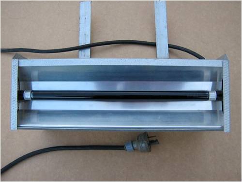

Sunlight exposure will also work and some fluros to at close proximity will work to some degree (if you can wait an half hour or more)
I used an old bug zapper uv fluro I had found in council road kill rubbish for a long time (15-20 min exposure)
Since trying UV leds have not used the zapper fluro again.

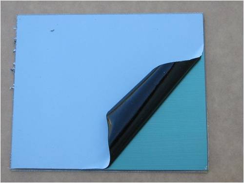

Remove the plastic film covering the board. This will expose the green uv sensitive film on the board.
Try to do this under low light levels and preferably with a incandescent light as this has no real UV light spectrum. (fluros do)

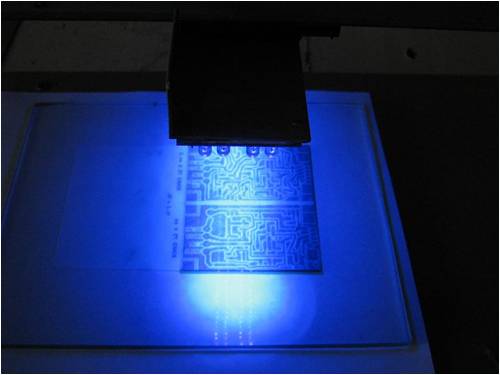

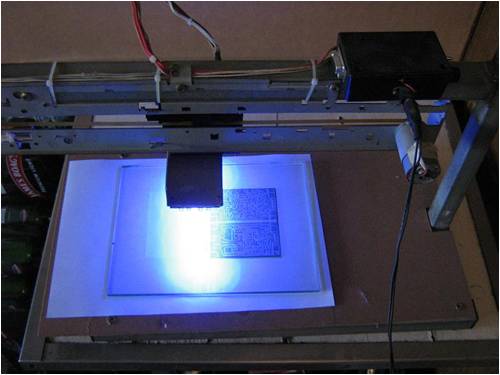

Start the uv light exposure.

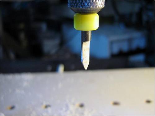

I find 10 passes (5 ups and backs) of the uv leds travelling at 300mm/min (slow) at a height of 100mm from the circuit board gives a good print.
If the leds are used stationary than exposure time is 10 times less, as the leds only cover a strip as they travel up and back along the board.
My uv light scanner was made from the carriage section gutted from an old inkjet printer and Uv led clusters. ( 2 rows of single leds work just as well)
It is important to have the leds start off the board and travel the length of the board and off the other end before they reverse and return, otherwise the ends where it stops and reverses will get double exposure and wont develop uniform.
Once the exposure is started, wait till its completed 10 passes and has switched itself off.

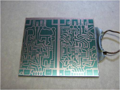

Remove the pcb and attach a piece of electrical tape to the backside of pcb with one end wrapped back around some plastic coated wire for a handle to hold/hang it from.
(Not such a good method for double sided boards. Works well on single sided.)
Place the pcb in the caustic solution and gently keep it moving in the solution.
The image will start to appear this may be quick or slow depending on the strength and the temperature of the caustic solution.
You will need to ensure all the green coating between the tracks has developed away as a light hard to see film remaining will make for a poor etch.
I find that a fine line along the edge on the artwork can give a good indication when over developing is happening, as this line will tend to be noticed to disappear first.
Rinse the board and inspect a few times during developing and you will soon see when it has developed fully.

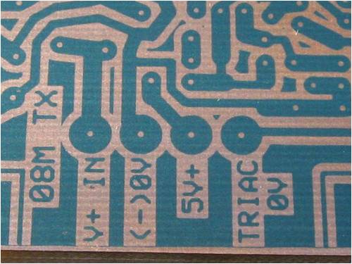

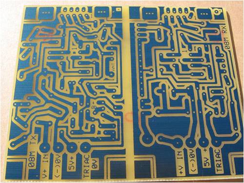

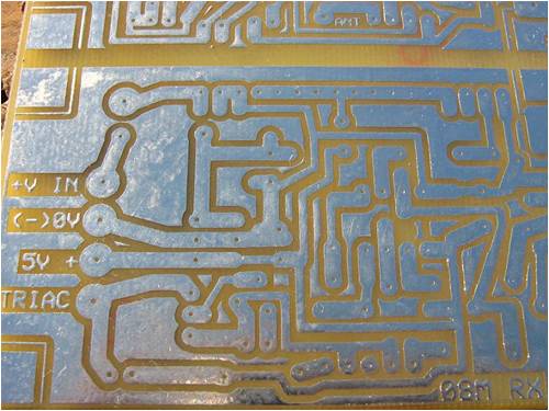

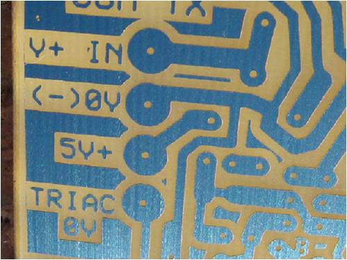

After developing the board should look something like this.
Check the board for any defects and correct them.
If you have a bridge between tracks then put a scratch in the green coating, as it will then etch there. If you need to repair a track, I find a CD marker pen works well.

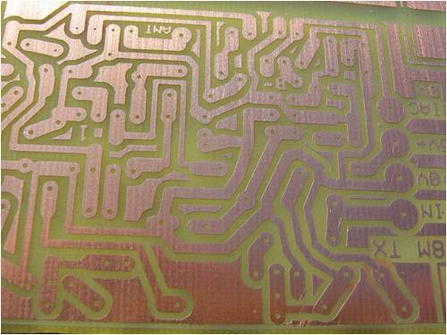

Next etch the board and afterwards it should look like this
It is easy to see the quality of detail that can be achieved
Once the board is etched the green protective film can be removed with methylated spirits on some paper towel.
The board cleaned off.

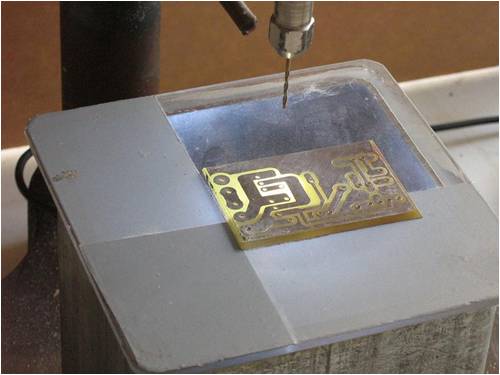

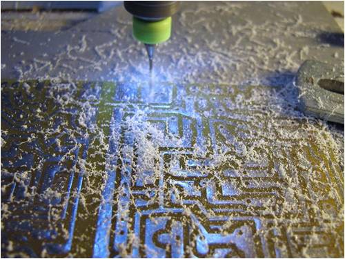

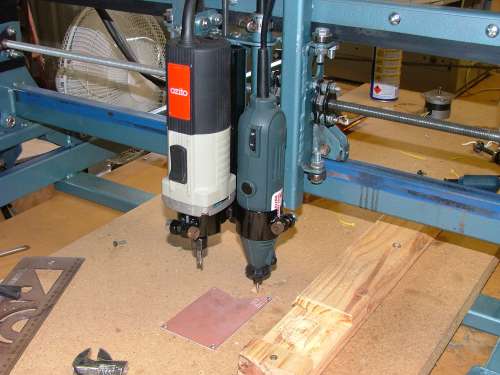

Drilling holes.
The part we all love to hate.
The better you set up for this the easier it gets.

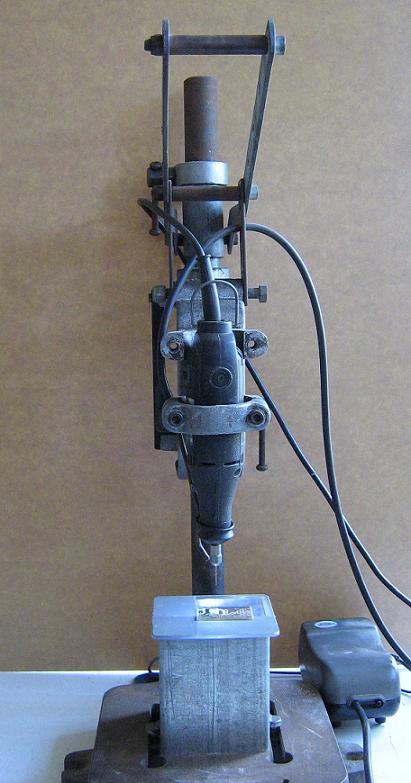

Old method used.
I had a dremel tool mounted in an old hand drill press I had found in council rubbish that served me well for many years.
A fish aquarium air pump was used to blow the dust away from each hole during drilling
The addition of a ultra bright white led in a under table position shining upwards makes it much easier to see the holes in the pads for drilling. One was mounted in a piece of steel tube with a acrylic clear top attached. Powered from a plug pac off a discarded nokia phone. (note the anti-glare tape. Bright little blighters)
New method.

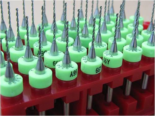

As I loathed the though of drilling another board and with eyesight deteriorating with age alone, and a desire not to have to drill little bloody holes, I built a small desk top cnc router out of junk to do the job for me. Best thing I ever did!!!!
Tungsten carbide 0.85mm drill bits.
Well worth the cost for how well they drill. They drill so clean and leave no burs around the holes.
Good life to if you don’t break them.
Drilling in process.

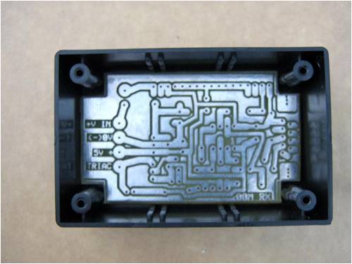

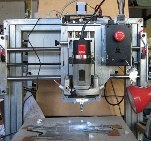

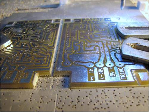

Once drilling is complete I route the board out to the shape required.
A rather well used, blunt looking pcb router bit
Check if all fits within the intended box. It did.

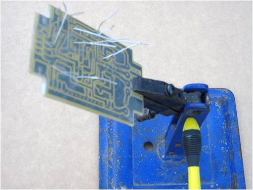

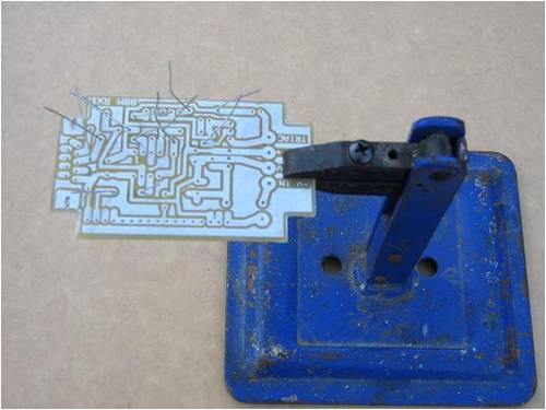

Board assembly

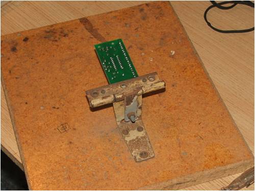

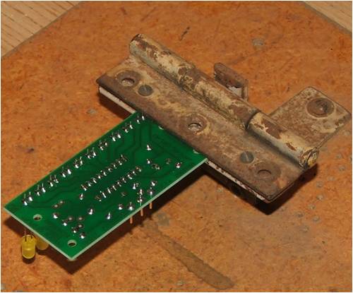

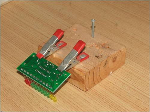

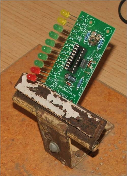

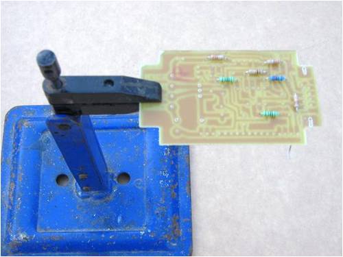

As you will all know, one of the awkward things about assembling a board is holding the little bugger while inserting components and soldering.
The little helping hands gator clips thingies are more than useless in my experience.
There had to be a better way!
I fabricated a pivoting clamp that can flip over one way to insert the components and flip back the other way to solder thing in place.
It was another project that was well worth the effort and has given many years of service.
Have since made several for others and now include a edge around the base to form a tray, as when you unsolder a component for an alteration all those used little bits end up in the tray and ready to be reused again. (or at least found)

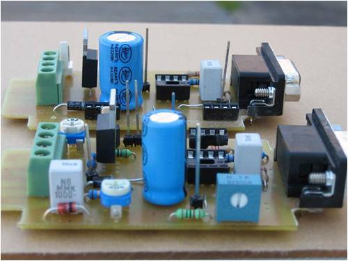

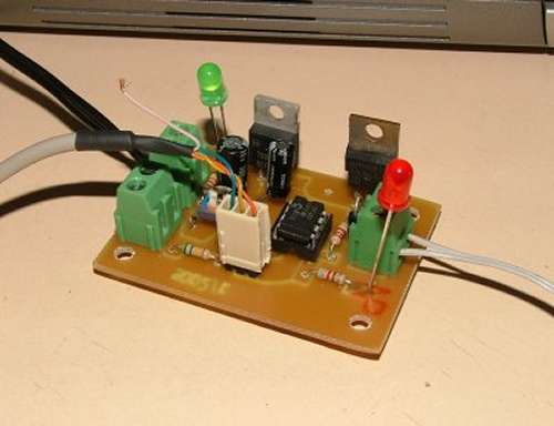

The finished boards
The whole process is a bit rough but it works for me and gives a workable board at the end for minimal effort and cost.
The process allows me to produce a reasonable board in less than an hour from printer to assembly and if doing several boards together than this time is reduced greatly per board.

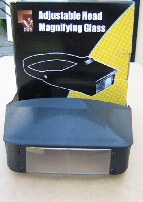

A good investment is a head set magnifier and once you have one, you will ask yourself how did you made do without it.
The local $2.00 shop “Cheap as Chips” had these out recently for $5.00 . They have a second flip down lense for double magnification ( maybe needed in future years)
Well worth the money. ( I bought a $30.00 set a few weeks before these came out and now prefer using the cheap ones.)
I can now read those tiny printed part numbers.
I am told they work well if you wear glasses, as there is no need to remove your glasses.
Funny how fast the soldering becomes when you can see what you are doing.
Best get two sets or the misses will steal them for needle threading or whatever?? or the kids may nic them to burn bugs with. (if kids still do that)

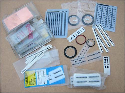

Your first picture showing the black Bishop tapes and pads brought back memories, I used to lay out PCB artworks for a living back in the seventies. Great fun, double sided boards laid out on a gridded light box with targets for alignment. One track between IC pins was as complex as it got back then and plated thru holes became only standard in my last years working in that field.

Have you considered modifying an old flatbed scanner with an UV light source? Seems like an easy solution, with all the mechanical bits already present; just tap in to the board that drives the stepper motor and add your own pulses/signals to control the motor.

+1 on the carbide drills. Just don't use them when drilling by hand, they're guaranteed to break. Very hard and durable drills when drilling glass (FR4 board), but also very brittle.

I was wondering if the carbide bits would work OK in a drill press or would they be to brittle - where do you buy them from?

I did consider the flat bed option but would rather have the print on top as it is easier to align and to see it is all correct before exposure.
Besides old printers are always out in council rubbish everywhere here.

The drill bits i buy off eBay out of china for around $20.00 for 10.
If you search ebay for "Dremel bits" it should give a vast range of suppliers and lots of different sizes.
If i was only to buy one size than it would be 0.9mm as i find almost every thing will fit this size hole, including header pins and v-regs etc. snuggly.
If you have trouble finding them that ask again and i will track down the supplier i uses.
I have used them in the dremel press ok but you need high speed or they will screw into the board like a screw and snap off.
Did you notice in the photo the cuttings from the drill are like little squiggly worms and not so much the fine ground powder the normal bit produce.
I still use the normal bits to oversize a hole as they are more forgiving in a cordless drill and its normally only one or two holes a board anyway.
The cnc project is well worth having a go at and you will thank yourself for doing it for a long time.

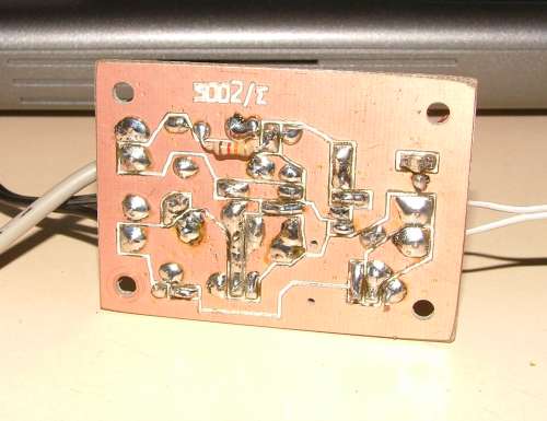

I've used my own CNC router to make a few small circuit boards, nothing fancy. Below is a test run.
And this is my PicAxe based pump controller. Its not pretty but it worked.

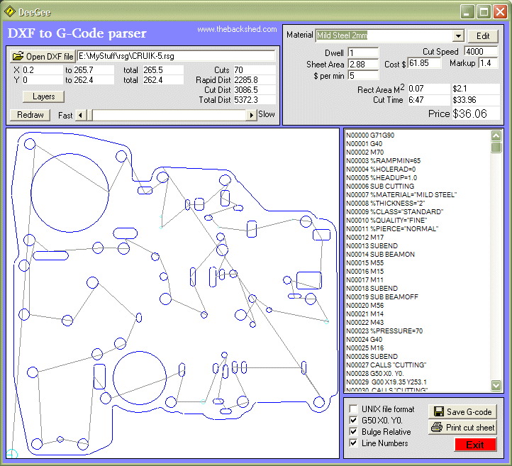

  Quote  Gizmo if you would like a dos based program to decode the Expresspcb dxf file into a drill code (G-code) for use with a cnc machine to drill the pcb holes than let me know.
Actually, I have a windows based one I wrote a couple of years ago when I was working at a laser cutting business. It takes a DXF file and creates the G-code to suit. It has a library of materials, speed and costs, and gave a pretty close cost of the job, usefull for quoting. I also used it on my cnc router. I plan to put it on my cnc site when I get the time. Below is a screen shot. It would be good to get these utilities in one place.

Here are some pics of quick and easy board holders.
They are certainly not in the same class as Downwind's engineered masterpiece but still beat chasing a small board around the workbench.
The first is just a block of wood with one or more cheap mini spring clamps from the two dollar shop screwed to it -
This one was made from an old hinge about 30 years ago -

Good ideas Trev. They are simple but practical which is what many are looking for.

The cnc router is the second one i have built or i should say the first one mach2 as i had rebuilt the Y axis and Z axis on this one, hence the multi layer tubing frame.
I had the intension to rebuild the X axis (table) as well but not yet got to this, so Y & Z were adapted to the old frame on the X axis.
As the previous Y, Z was kicking about on the floor i built another X axis and reworked the bits off the previous Y,Z to make a complete cnc router for a good friend of mine, so he too can drill boards with ease.
There is a mass amount of work in making one and you wont get much change out of $500.00 by the time you buy the few bits and pieces you need.
I looked at buying a bought one and prices started at around $5000.00 and jumpped to $50,000.00 real quick.
I could not justafie the cost for my needs so thought i would have a go at making one.
It felt like a never ending project but i got there.
The first run around with a broken drill bit and a paper print out of a circuit, that i could press indents into the paper and not punch through it in all the pads gave me a smile bigger than the grand canyon.
I looked at building the motor driver board, but by the time i added up all the driver chips and other components it was about the same price as a complete 4 axis board out of China for $100.00 so i took that option.
I use Mach3 as the cnc software and only have the free demo version. This will only allow me to go to 500 lines of code which is very limiting to the work you can do, as a circle cut could be 2000 lines on its own.
There is always a way to cheat this but a pain in the butt just the same.
I will try to find some time on the weekend to take some photos and put a short discription together.
It is far from a work of art as i made use of what scrap (better said without the S )i could find to do the job.
I do intend to build another one with all the good bits in it, so i can machine down to 0.01mm as at present i can get around 0.1mm accuracy or better.

I only bought a flex shaft for my dremel a few months back as found one real cheap and never thought i had a use for one before. I do find it handy for the odd thing like cutting out the box to mount a plug through and things like that but optional.
The other cnc router i made runs a super cheap autos brand tool on it (was on special for $20.00 at the time) and has little run out when routing and i think it is better than my dremel in that area, but mine is many years old and done a mass amount of work.
I did replaced the bearings in mine resently even though you are not ment to be able to, and buy a new shaft instead, but tool is to old to get a new shaft.
I still had run out so shimmed the bearings in the plastic housing and it made a world of difference.
Mine has a 2 piece shaft and a bad design as it allows movement between the two. This has been changed in the later models to a 1 piece internal shaft.
I would take the collets from the toy drill with me and the tool they fit into is the one i would buy.
It is very difficult to get the collets with a small hole for the drill bits and you already have them.
I find the little chucks that come with the dremels useless as they dont centre worth crap on fine drills an wobble to much.
If you run one of these tools on a cnc router it gets a lot of sideways thrust applied to the bearings and they are not designed to take that sort of load being a hand tool, thats why i bought the el-cheapo ozito router rather than stuff up a $100.00 handy tool.
I cut down a flex shaft from a el-cheapo rotary tool to make the adaptor for in the ozito to take the 3mm shaft cutters and drills i use.
I think you will find a range in the dremels and the $99.00 ones is in the lower watts range and the lesser quality one as when i looked last i needed to spend $150.00 or more to get something a bit more robust in the range.
Dont get lead by all the free cutters and grinding stones some kits have, it might look like a good deal but really they are useless crap you will more than likely never use much if at all.
A few good cutters that cost a bit is worth having and you will do more with them than all that other junk put together.
So conclusion buy what your heart tells you more so than me. If it was me i would buy a tool the collets fitted and was cheap with minimal slop in the shaft and bearings, then spend those dollars saved on a few good cutters of different styles.
When the tool dies in time buy another cheap one and you may still have the good cutters from the beguining.

Also dug out a drill press designed to take an electric drill which I had collecting dust in the shed (don't think I ever used it) and it will take the Dremel without too much modification. Surprisingly, it looks almost identical to the Dremel one which sells for around $90!! Just goes to show that if you keep that junk long enough it will eventually come in handy (or so I keep telling my wife when she suggests a cleanout).
