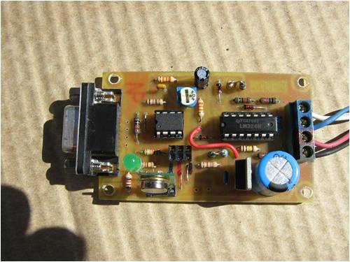

There is one draw back with what i am doing in circuit compared to how you intend to use a hall sensor.
With a hall sensor you can measure the DC amps and is better suited to the current input on a solar system.
With what i have done with the use of a current transformer (CT) is only suitable to measure from a AC source, as a DC source will produce no voltage within the CT.
The logger design was only intended to be used with a mill or off mains wiring (including inverter).
There is no need to monitor DC Amps with a mill as the AC will give better results and the mill RPM is also extracted from the mill AC.
My thoughts was to design a simple little circuit that was easy enough for a novice to electronics to be able to construct and get some real life data back from their mill or monitor their power consumption.
I never set out to build a bells and whistles logger as this makes it too complicated for a novice and requires a Cro etc to be able to set the circuit up.
All that is really needed is to be able to record the mill RPM, the AMPS to the batteries and the battery Voltage, then the Watts and Watt/Hours can be worked out in software.
This is all that this logger will do.
There is an input left to allow an aneomometer to be added for wind speed if one desires.
You might say a base model logger.
I do agree with the SD card storage or usb stick but this makes it outside the novice level.
I do have plans to design a logger of this type but it adds $$$ to the project fast and requires a much higher skill level in electronics to construct and get working.
A good example of this is Gizmo's voltage controller it is basic and simple and has been constructed by many because it is within their ability.
My intension is to offer a simple kit to make the dream of logging ones mill a reality.
In the long run it will help to make for a better forum with realistic data taken over a period of time and not just peaks and troughs of data.
At this point it is still a prototype and the guru Gordon is testing the unit out and is compiling the computer software to go with it.
I must add a Thankyou to Gordon for doing this and i know he to would like the rest of you to be able to enjoy looking at actual data from your own creations.
Heres a photo of the prototype board.
Pete.

powerednut
Joined: 09/12/2009
Posts: 221
Posted: 10:34pm 08 Apr 2010
Hi Pete,
Yup, currently my set up is solar only. I do plan on having a wind turbine in the near future though. The hall effect sensor will still work for AC.
The prototype certainly looks simple enough - congratulations on a very elegant design

I am toying with changing the board to take a higher quality transceiver to give stronger wireless data transfer should the option of a wireless system be choosen.
What is the thoughts of others on this as it would add an instant $50.00 to the project for the 2 transceivers alone.
Then there is still the cost of a decoder board at the PC end regardless of what wireless modules are used.
This all makes a cheap logger start to get up in price and complicates things a little more.
Should i just keep it as a simple lower cost kit that plugs direct into a computer via serial or USB or go the wireless route.
