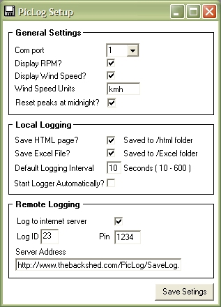

The Piclog software has a few changes. The Setup screen now has a option to reset the watt hours at midnight, the software will either reset the watt hours every night, or keep a running tally. I'll be adding RPM and Wind Speed peak recording as well. Also added is the remote logging options, where you set the PicLog ID and Pin, and server address. The ID and Pin will be provided by me when I set up the server to accept data from your PicLog.

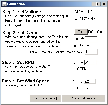

The Calibration screen now has a amp reading filter, to filter out small changes around 0 amps. These small fluctuations can cause tray watt and watthour readings, especially if you use a Allegro current sensor or current transducer to measure current.

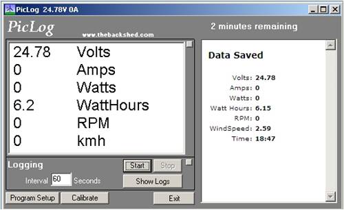

If you enable the remote logging, the PicLog screen will widen to display a extra panel. This extra panel is a mini web browser, and is used to send the data to the remote server. It also displays the web page sent back from the server, confirming the data was saved in the servers database.
I've been running the updated PicLog and server software for a couple of days now, but I have a problem, as you can see from the PicLog screen above, no wind! So I've connected up my solar panels to act as a power source for testing, you can see the rise and fall in the watts graph above, as the sun rises and falls during the day. Problem is, its not much good for comparing watts to wind speed or RPM, one of the graphs I want to add. So I'm looking for a couple of beta testers, forum members who are running a PicLog on a PC with internet access. If your interested, let me know and I'll send you the updated PicLog software, a ID and Pin to access the server.
