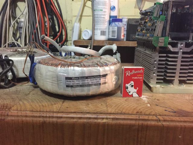

So, after a little more than 2 years the Victron 3000VA Multiplus inverter has died. Evidently the warranty is 2 years so I have to congratulate the designers for the near perfect product obsolescence. Have a few drinks on me, guys.
Anyway, time to make a replacement.

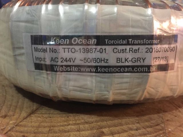

I will be using the 3000VA Aerosharp toroid and the aliexpress inverter board
I posted a "wanted" entry here, looking for another 3000VA Aerosharp toroid.
I think I need to keep experimenting with this stuff so I need a replacement for
the one I will use in the home inverter. I hope someone here can help me out.
Ebay and Gumtree have nothing at the moment.
The inverter I am building will spend a lot of time at power levels less than 1000W.
I wrote on this subject at length here
I think I will attempt a modest unit with good headroom for when fridge motors start up etc.
And so today I report I have rewound the primary to suit 48V supply and rewound the aerosharp choke core with thicker wire. I cleaned out all the welded bolts and crap from the aerosharp steel box. Tomorrow I fit the inverter board, 240V GPO and 10A contact breaker.

Oz,
the transformers are tiny. Think 2 transformers, smaller than 1000VA Aerosharp units.
The Victron starts up fine and runs for about 3-4 minutes then it dies with lots of hum, overload light and maybe if I'm lucky under voltage light. This with zero AC output load.
I suspect it's the mosfets and or gate driver boards.
Inside the box it's a wonderland of through hole discrete design.
I will give it a week or so, to wait for the disgust to abate, before I consider
hacking the be-jesus out of it with an aliexpress inverter board, it's own or some other choke and it's transformers. Kick the rest into the workshop parts heap.
Maybe I'll do a tear-down so we all can have a good laugh..
I rewound the 48V primary with 4 x 6mm2 cable. I do not have anything bigger.
This will be OK for my expected loads. I will have temp sensors on both the transformer winding and the mosfet heatsinks, leading to the Arduino to determine if things are OK or too hot.

I have only two transformers. one 1000VA and one 3000VA.
I know my power loading and I choose the 3000VA over the 1000VA.
Testing has shown to me that the 1000VA saturates at 1000W output (or input)
I will not consider using this since I have records of extended periods of time
where the Victron was supplying power levels near 1000W.
To run a transformer at saturation for minutes to hours is not going to lead to a happy ending.
Idle current during bench testing the 3000VA with 27V supply are of the order of 0.5A or 15W. I can live with this. Typical overnight power levels were 250-300W so the 15W idle is only 5% or so. I have 3 fridges, a tropical fish tank and many electronic things on standby. What is 15W idle loss to me.

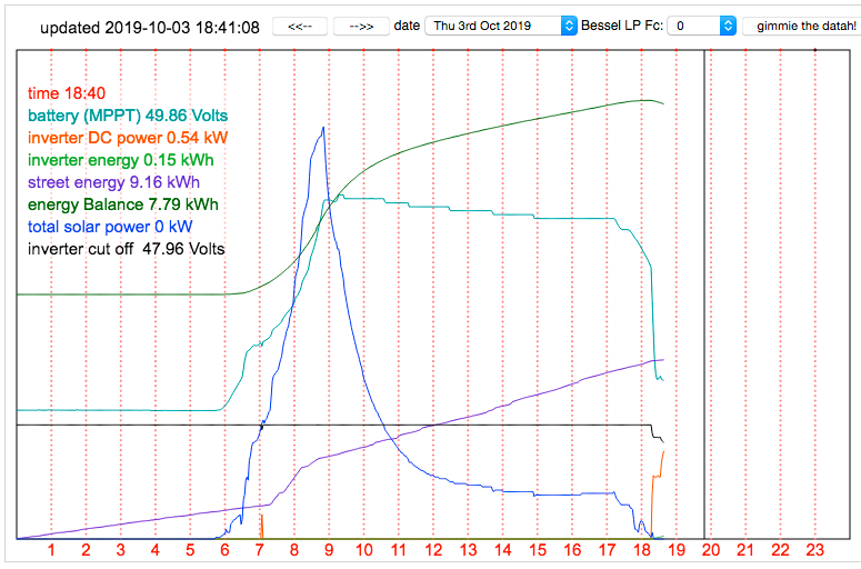

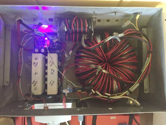

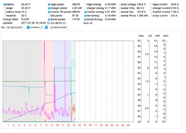

Thanks to both Warpspeed and Oztules for your comments. You clearly care enough to want to spend time and effort in helping me understand things.
I have finally got the time and enthusiasm to complete the inverter.
It does the job.
The 10A 3 core output has 3 fridges, a fish tank, modem and router, imac and UPS, 2 laser printers, 2 macbooks, 3 monitors and more hanging off it.
As at the time of writing the inverter DC input current is 7.3A @ 55V so that's 400W
The heat sinks are still at ambient temp, the inductor winding the same as is the toriod's primary. The primary is 4 x 6mm2 copper. The inductor is 3 x 6mm2.
I2R losses at 400W would be small enough to accept.

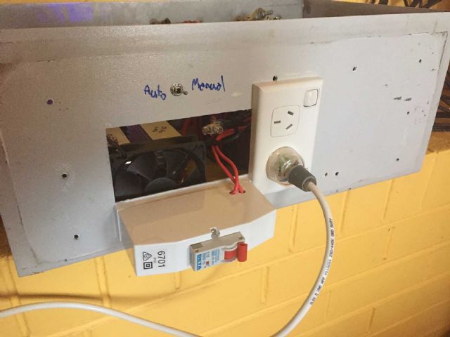

I use a Latronics Automatic Transfer Switch (ATS 40Amp) to automatically switch over the above detailed loads from inverter to street power when the battery voltage drops to a set point. And once the battery gets enough charge, the inverter is switched on again and the ATS senses this and changes over the AC source from street to inverter.
Possible failure scenario:
Should the street AC phase be inverted compared to the Victron AC output , the switch over even may be putting large current or voltage pulses into the Victron inverter.
This might have damaged the mosfets or their gate drives. The Victron did not have any street AC phase sense connected, and I think it has no facility for this anyway.
I will find out soon enough when I re-install the ATS and either see magic smoke or not from the inverter board. At least the inverter board is repairable.

I use a transfer switch from england, but which is in fact 4 normal breaker box switches from a normal AC power board,, stitched together.... so they switch very fast when over the center point. That switches hard grid to hard inverter and has done for a long time now.
How it would go with 20ms I don't know, as this switch is very very fast. Lights hardly flicker, and it may be as low as 20ms or even less... don't know.
This has been done with loads up in the 5kw range, and the inverter has never flinched... so thats as much as I can tell you about the 8010 in that situation.
It works, and thats a good thing.
.........oztules

I have tried to trip the 40Amp latronics transfer switch up going back and forth from an inverter to generator under load but it seems to always sort it out and work just fine.

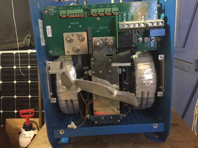

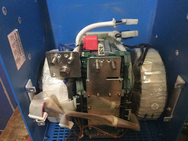

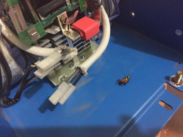

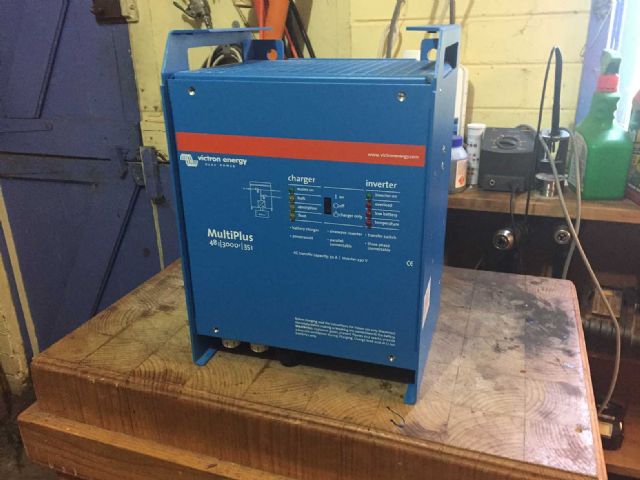

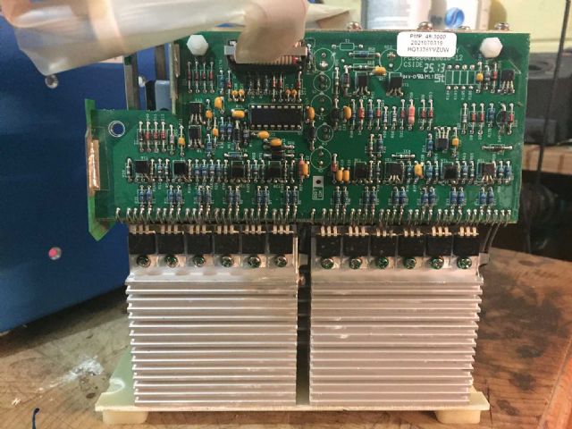

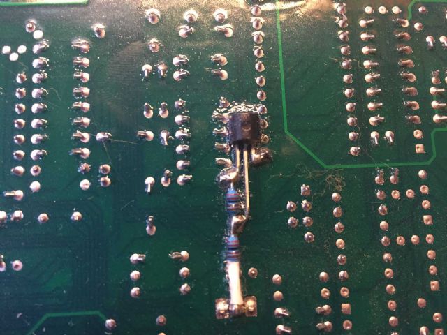

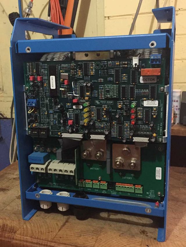

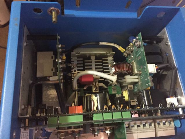

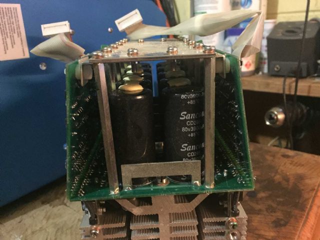

I pulled apart the Victron Multiplus 3000 inverter/charger.
Let's see how many photos I can post...
The useless Blue box.

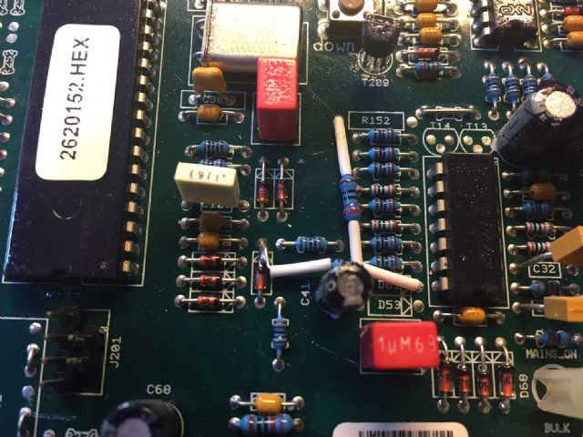

main control board. All through-hole.
some bodge jobs, front and back of board.
after control board removal, unit upside down.
view from top, yet more discrete stuff.
The view of the back side of it. This is the AC switching and charger switching control

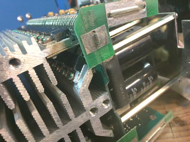

At last we get to the mosfet full bridge and transformers
I don't recall subletting the inverter to this guy..
one half of the full bridge gate drive. Oh my God.
(we now achieve great gate drive via $7 chips and a few components.)
10 big DC bus caps all in a row.
4 rows of 12 mosfets. Fairchild (OnSemi) F75646p mosfets datasheet
The star of the show, at last. The transformer(s)
only wound 1/2 of circumference, I wonder why. Probably a lesson there.
size comparison to a box of Hansons. In the real world these toroids are 1/2 as high and a bit smaller in diameter than the 1000VA Aerosharp.
The inverter used one only transformer for low loads and switched in the second one
for higher loads.
There is no way I will spend any time looking at why it failed.
Also, I don't have the skills to understand let alone repair
this complex lump of rubbish. To my eyes it looks 15 years old obsolete.
The transformers might be worth keeping.
Time to get back to working on the important things in life.Edited by poida 2017-07-30

I was wondering about the 1/2 circumference wound primary on the two transformers.
the reason is here
http://ieeexplore.ieee.org/document/6473895/
"Toroidal transformers are commonly used in power electronics applications when the volume or weight of a component is at a premium. There are many applications that require toroidal transformers with a specific leakage inductance value. A transformer with a large (or tuned) leakage inductance can be used to eliminate a (series) filter inductor. In this paper, a procedure to control the leakage inductance of toroidal transformers by leaving unwound sectors in the winding is presented."
you can read it here
And that 'splains why I did not see any primary inductor. It's not needed.
My LCR meter shows about 204uH at 100Hz into the primary with the secondary shorted.
I hooked it up to the prototype inverter board and it runs fine (and very quiet) without a primary choke. At 48V DC it needs 0.2A at idle and 230VAC output. 9.6W not bad. With a 166W load, I find 93% efficiency but given the small primary wire area I think things will go downhill fast with +1000W loads.
There are 2 x 2.3mm diameter single copper wires for the primary.
This is 8.3mm2. When both transformers are running it's 16.6mm2
Not a lot where we come from.
Edited by poida 2017-07-31
