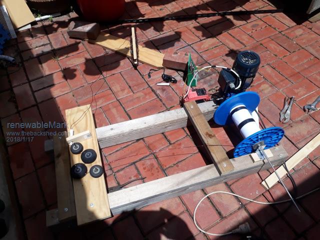

So far have 1 unwound and had some issues straitening the wire, so I came up with this from some old parts lying around.
Seems to work pretty well and is run by a frequency inverter so it can be slowed down to a manageable level.

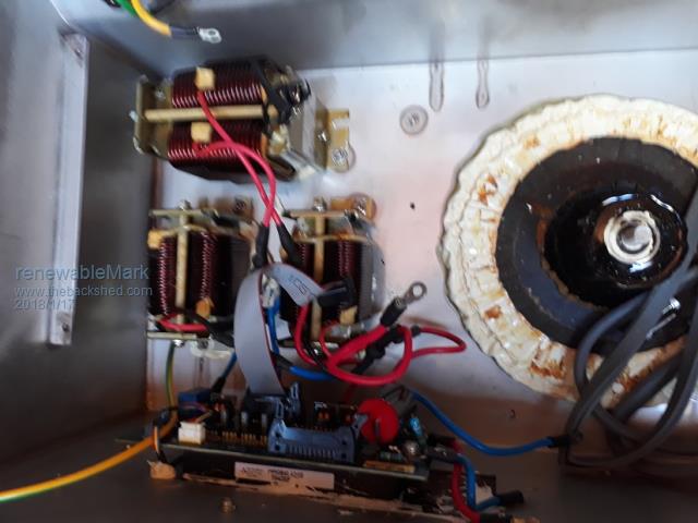

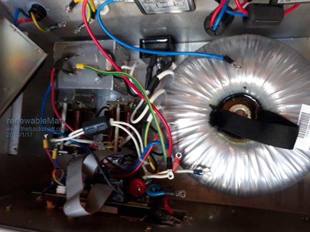

The second aero sharp I opened up looked different inside, one had one of the small transformers potted up with grey epoxy and the torroid had a cloth strap attached to it. The date was only a month apart from the other one that appears to be different.
So I'll unwind the second one and hopefully it's the same size.

Thanks Madness for the tip on removing the torroid it worked a treat.
Simply cut away all attached wires, turn the unit upside down, lift the heavy end 45deg and drop it and it will fall out.
The only thing I would add is to have a foam matt for it to fall onto.

I would avoid winding on that small spool as each time the wire bends it gets stiffer, that is one step you can avoid. I use push bike rim and roll it on to it as I pull the wire through the bearings. Then it comes off the bike rim very easily and you store it in neat coils.

I now just stretch the wire after attaching it to the car tow ball..... pull it very tight until the bends disappear and done. Seems to be less work hardening. Any micro cracks in the enamel will be fixed with the epoxy.

  oztules said   I now just stretch the wire after attaching it to the car tow ball..... pull it very tight until the bends disappear and done. Seems to be less work hardening. Any micro cracks in the enamel will be fixed with the epoxy.
........oztules
I do it that way too.
Secure one end in my workshop vice and run the length of wire right down the driveway sometimes right into the street.
With about fifty feet of wire, it can be stretched quite easily about an extra foot.
The wrinkles come right out.
Every time you bend that copper it further work hardens, and you get into deeper and deeper poo.
Going back and forth around a bunch of pulleys may not be such a good idea. It will certainly straighten out the wrinkles, but it is also going to stiffen up the wire.
I really like the bike rim idea for the same reason.

Ok dumb question, why does it matter if it gets harder? Still should be easy enough to get wound around the toroid.
Reckon ill do the stretch method though, sounds easier and faster too.
Cheers Caveman Mark
Off grid eastern Melb
Posted: 09:05am 18 Jan 2018
If the wire goes really hard on you, it ends up as lumpy crooked ugly winding. Thats bad enough on one single layer.
Try to wind another layer over the top of that, and you are really in for some fun.

OK stretch it is, low range 4x4 and streeeeeeeeeeeeeetch.
Cheers Caveman Mark
Posted: 10:29am 18 Jan 2018
Just a pair of vise grips and a bit of heave will be all that is needed.
About half the stretch will be all the wrinkles coming out.
You can actually feel it stretch, and it does not spring back.
It will end up dead straight and look brand new.
Try cutting off a 100mm length.
Bend it once to judge how stiff it is.
Bend it three or four more times in the exact same spot and note the difference.
You might be surprised how quickly nice friendly wire can turn into a real bastard.

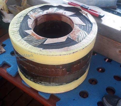

Finally got the second one unwound.
Thankfully both are exactly the same size.
