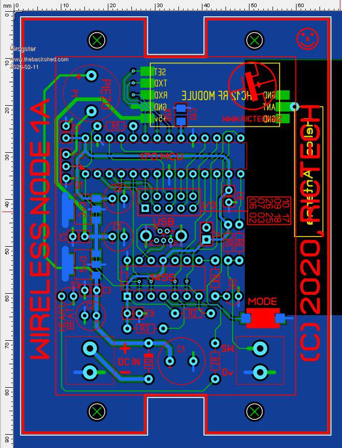

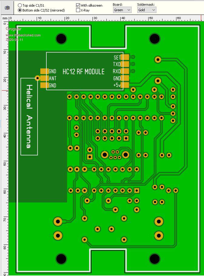

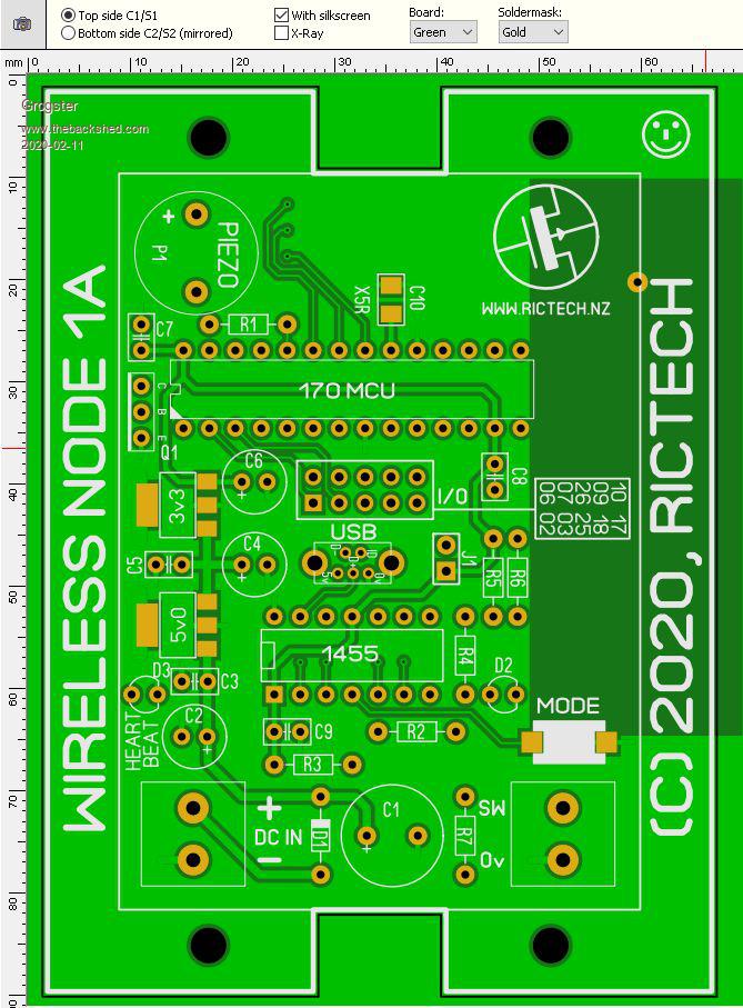

Hi all.
I needed a wireless link that would fit into a standard single wall-plate, so I came up with this:
What I needed, was a simple door-switch that would send a certain code to a base-unit, so I came up with this design, but expanded it so that not only the switch input(SW) is available, but also all of the unused I/O pins for maximum flexibility.
The PCB is designed to fit into a PDL 600-series single wall-plate(a blank one such as 650VH), as in the system I wanted to use it with, all the other call-points etc were on single wall-plates, and powered by a common 12v DC-bus via 4-core security cable.
If anyone is interested in this, I can build a constructors pack and make it available for download from my website along with demo code, BOM etc.
The PCB is still in alpha, so it might have errors, but I will discover these when I build the first few - which have been ordered.

Good timing. I put in an order for some HC-12's from you yesterday & just sat down to plan out a bit of a MM radio network to get rid of some hard wiring I have around the place.
Your board probably would suit one of my needs.
Could you confirm that the board itself is about 65-66mm wide?
Brian

@ Chopperp: Yes, 66mm x 89mm.  Designed to be a perfect fit in the rear of a PDL 600-series blank wall plate.  It will fit either the 650VH or the 650BVH.
Assuming you can get the PDL wall-plate series in Australia?  I would expect so - yes?
I think that PDL are now called Schneider Electrical, but the codes are still the same so I understand.

Groggs,
This could be very useful to receive then re-broadcast HC-12 messages around any dead spots in the house.
(but I'm not yet sure if SWMBO will allow me to put in more wall plates . . . any chance they could fit behind, say, operative light switch plates - without contravening safety/regs?? - probably not.)
I respect that you have done this for a particular need but two quick comments:
- could they (optionally) be powered by 5V (rather than 9 - 12). Is it as simple as jumpering VR1 out?
- can the 12V go as far as, say, 12.9V for battery power (if not a separate VR could be used) ?

You COULD hide the PCB in the wall-cavity behind an existing wall-plate, but as you suspect, there are electrical regulation issues there.
Two spring to mind: (1) Separation standards between 230v and low-voltage stuff, and (2) you can't install a plug-pack inside the wall-cavity, and you are also not supposed to drop a low-voltage cable down the same holes in the wall as the 230v stuff - but whatever you do is up to yourself. ;)
In my case, all the cabling is 0.5mm(well, 0.44mm) 4-core low-voltage security cable that just loops in and out anywhere it is needed, all fed from a master PSU and backup battery.  That is is the main reason for the 1000uF cap on the DC input - just to decouple the DC power a bit due to the lengths of the cable runs.  With the circuit running from 5v or so, that gives us 7v or so of headroom to play with to allow for voltage-drop on the cable - not that I have ever seen an issue with that at the currents being talked about here.
As to your other question, yes, you can just not install the 5v regulator, and feed the circuit from 5v directly.  Voltage-drop on HC12 transmit MIGHT be an issue, cos you then won't have the juicy 1000uF decoupling cap to help decouple the input voltage.
The 5v regulator is my old faithful MCP1703A-50, and it can have up to 16v applied to its input, so that becomes around 16.6v ABSOLUTE MAXIMUM input, taking the 0.6v dropped across D1.  It's never a good idea to run things right at the threshold though, so I would not push the voltage up above about 14v maximum.  The circuit will be happy at 13.8v - which is a very common single-supply voltage used in many security system installs.

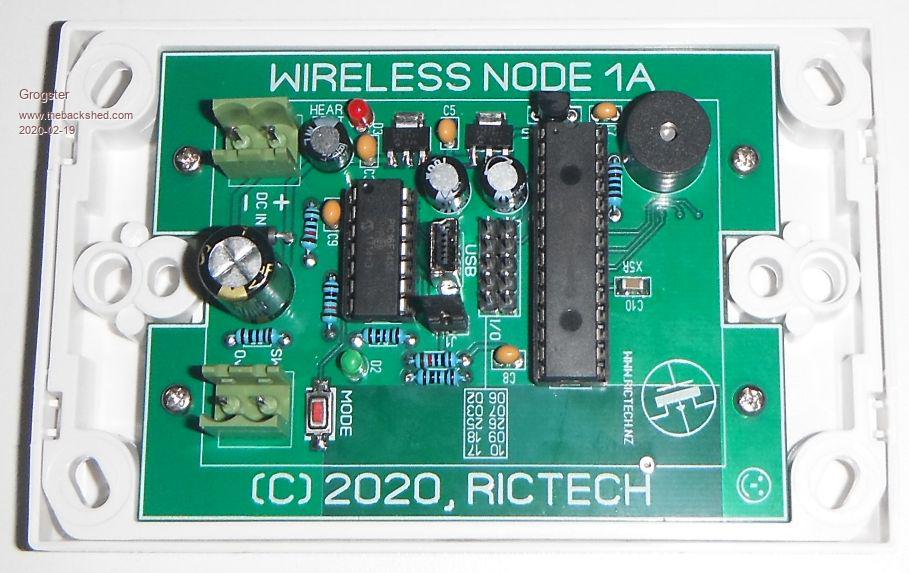

My PCB's have arrived, so I have built one into a PDL 650VH blank wall-plate:

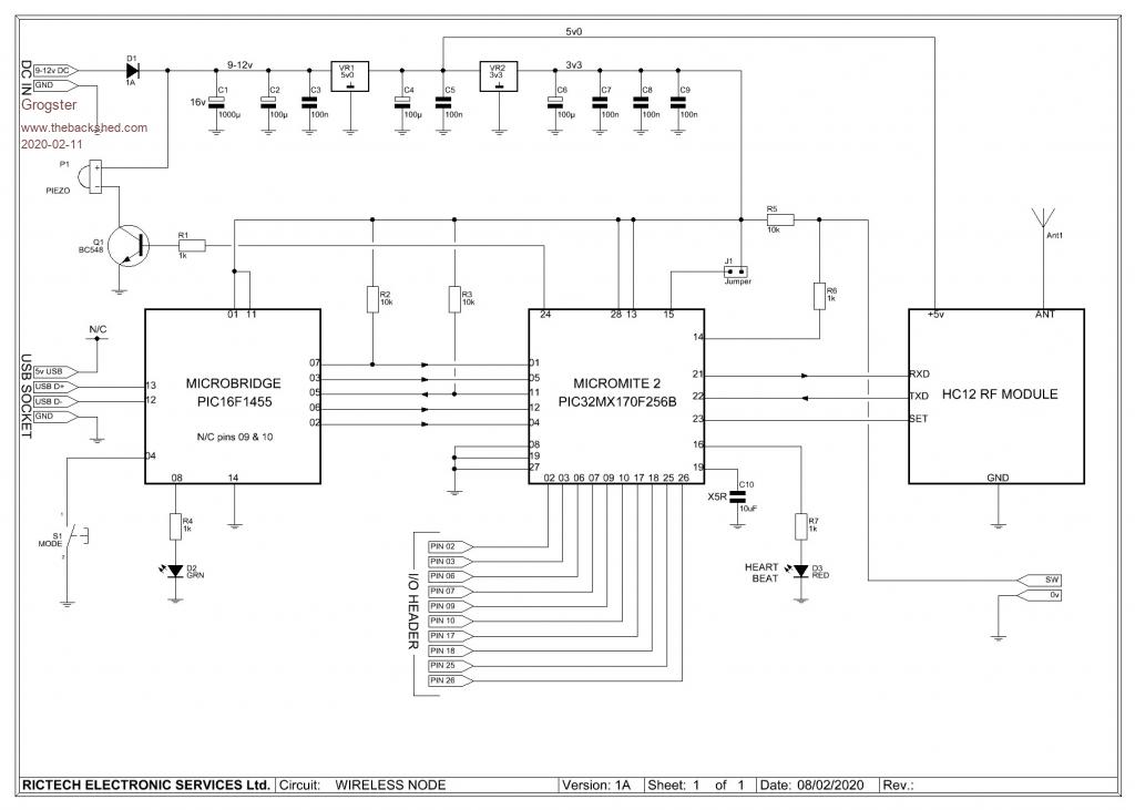

Very good. Some quick comments/questions:
- the Setup and Check subroutines are great - I use Rob's program, but this is a  great option too
- where does your switch go? I presume elsewhere? Or, you might be able to use spacers at the four screws with a switch in the outer plate? (in a subsequent version one might find space near the centre to drill a hole for one??)
- I'm assuming Jumper 1 is just for your code? One could ignore that and still "suck" and Print to the HC-12?
- I'm still struggling to get noise out of a MM - is your piezo loud enough, what ID does it have and from where? {Edit: I just noticed that it is from the 9-12V supply - that would help. I've been restricting myself to 5V }
Cheers,
Andrew
Edited 2020-02-20 10:28 by Andrew_G
Posts: 10109
Posted: 06:32am 21 Feb 2020
Howdy.
Switch is a reed-switch and magnet on a door.
J1 is just so the code knows weather this unit is a transmitter or a receiver.  You could just ignore that and do whatever you like.
Most piezo beepers with built-in drivers are designed to run from 12v.
They still work at 5v, but they are very quiet.
Most of them won't work at all at 3v3.
You need a transistor buffer, which is what I am using in this PCB.
The piezo is connected to 12v, and the 3v3 I/O pin on the MM drives the transistor buffer.  They are plenty loud enough like that.
