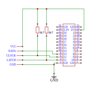

OK, so though it worked (off-spec?) at 3.3V I can't get it to work at 5V
The schematic (I think) I've constructed is:
With the connections to the Famicon/NES controller (CD4021 shift-register) on the left and the connections to the Maximite's 26-pin GPIO on the right.
My program is:

The "A" button (first-bit of data in the shift register) is being read correctly but other single button presses are not, some combination presses are coming through (partially), e.g.
"A" + "B" -> "A" + "B"
"Start" + "Select" -> "Select"
"A" + "B" + "Select" + "Start" -> "A" + "B" + "Select" + "Start"
As far as I can tell with my "toy" DSO138 and limited skills the latch and clock are all pulsing correctly, but I'm not getting the correct pulses back on the data line.
Any ideas?
Best Regards,
Posts: 4401
Posted: 07:12pm 04 Apr 2020
Three other pieces of information:
1) If I tie the controller VCC and the CLOCK & LATCH open collectors to 3.3V it shows the same symptoms as with them tied to 5V.
2) If I tie the controller VCC to 3.3V and make LATCH and CLOCK din it works fine, i.e. those pins aren't bust, at least under normal (non open-collector) operation.
3) If I detach the DATA line from the CMM and just connect it to the DSO the output is consistent with when the DATA line is attached to the CMM, i.e. I think the CMM is reading the DATA line correctly.
I am at a loss, even if the controller is not 5V compatible I would have expected (1) to work.

OK, presuming that in item 2 you mean DOUT not DIN and you don't have your LED matrix connected as well, the difference between it working and not working COULD be the impedance when the output signals are driven high. The clock and latch pulses may not be getting through properly due to long leads and capacitance. It seems that the "A" button is always correct because it does not rely on a clock pulse to be read.
I would try lengthening the clock and latch pulses and/or lowering the pullup resistor values to (say) 1K.

Posted: 11:24pm 04 Apr 2020
Hi Tom,
Assuming the directions as per your program are correct, it may be good to drop the 0-5V swing from the device to 0-3.3V required by the mite.
Can do this by
a) inserting 1.8k in-line between Device's Data Pin and Pin 3 on uM, and
b) inserting 3.3k between Pin 3 on uM and GND
Ratios are important, values may want to adjust...probably 18k and 33k will work just as well.
Assuming devices not blown, and assuming the signal directions as you've noted.
Regards Phil
