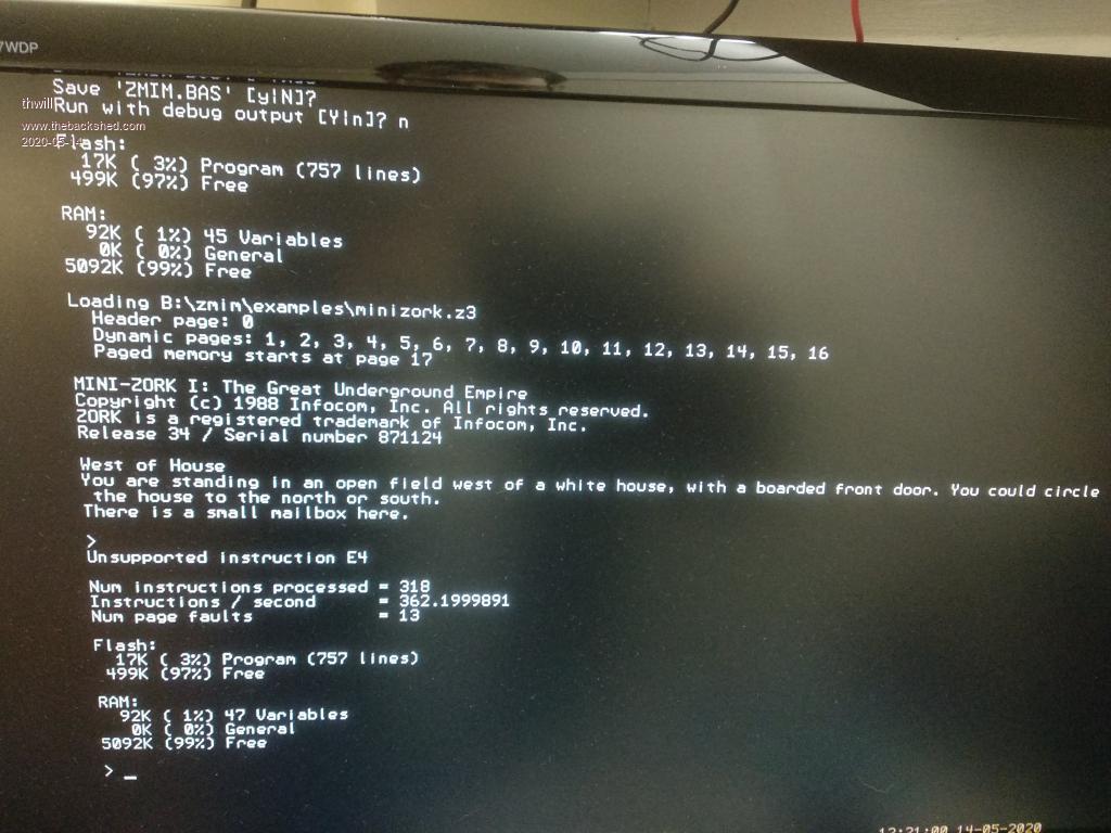

Hey folks,
My CMM2 has arrived, thanks to the WhiteWizard and micromite.org.
Under the current conditions my free time to play with it will be very limited but for the sake of a smoke test I've updated and executed my (incomplete) Z-Machine implementation:

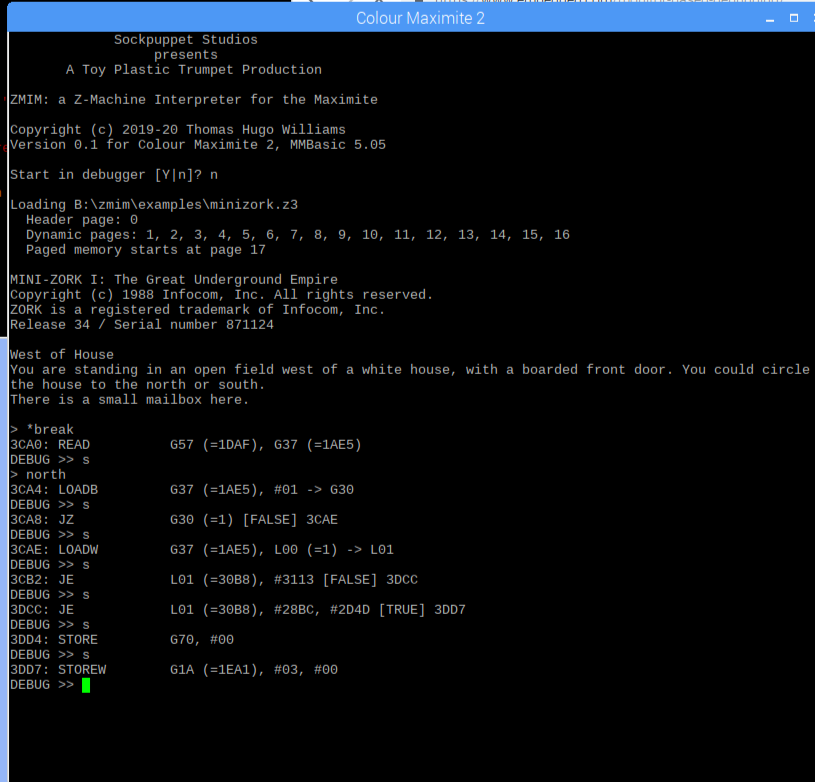

Hi folks,
Just a quick picture to show that progress is being made:
What this shows is a Z-machine monitor/debugger that I've built into the implementation to help me track down a bug in the parser that has been stymying further progress.

Posted: 07:18pm 30 May 2020
Just in case you were getting tired of looking at all the impressive graphics demos and really felt the need for some serial terminal action here is video evidence of the latest progress: Zork on Colour Maximite 2
Obviously there's a bug causing the cryptic message when I try to examine the leaflet, that's next on the TODO list.
Performance is ... adequate. Undoubtedly there is some room for optimisation but I suspect that implementing a reasonably complex virtual machine in BASIC was always going to be a stretch even on the CMM2; my understanding is that some of the more complex modern Z-machine games can cause a Z-machine VM written in "C" to creak a bit on a Raspberry Pi. I still hope to produce a version capable of running on the CMM "Classic" but I suspect it will be a bit like playing "Adventure" back in the 70's on a teletype.
