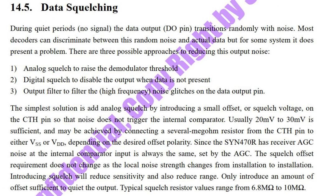

On the squelch, page 18 of the 470 receiver chip states:
My receiver modules have no connection to the CTH pin(7), so I could do as they suggest and add a 6M8 to 10M resistor from this pin to GND as a squelch experiment.
Also, pin 12(WAKEB) is defined in the manual as: "Wakeup(digital output): Active-low output that indicates detection of an incoming RF signal." - this pin is also not connected on the module I have.  I will solder a test wire to this, and analyse it along with the data signal, cos this could indeed provide the interrupt signal I need, and then I can just read the data bits somehow.

Posted: 02:26am 27 Jun 2020
Have a look at pin 12.
WAKEB
Wakeup  (Digital  Output):  Active-low  output  that  indicates  detection of an incoming RF signal
That should give you the squelch we are looking for.
After you have that working, we can start looking at decoding.

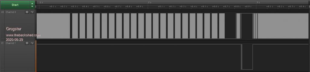

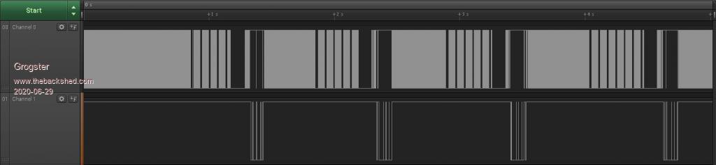

Yes, the blank chip on the module I first played with is not a genuine chip.  I get nothing at all out of pin-12 when I solder a test wire onto that pin, but I DO get an expected response from another module that has a laser-engraved SYN470R marking on it:
Data on channel-0, WAKEB pin(12) on channel-1.
I do note that the pulses we see on WAKEB are at the END of the transmission, NOT the start as I would have thought.  To me, that does not make much sense, as the data has STOPPED by the time you get the pulse on WAKEB - so you have nothing but white-noise again.  Confused by the timing of the WAKEB pulse, as the manual for the chip says this is active-low on detection of an incoming RF signal, but it would seem to be active-low on detection of the END of an incoming RF signal.  Does this make any sense to anyone else?
Here is another shot, where I have keyed the transmitter four times with a gap between presses, and you can clearly see that the WAKEB pulses DO sync up with the RF, but they appear when I RELEASE the transmitter button, so they are indicating when I am letting go of the transmitter button, but not when the RF is actually detected so you can sync to the data - which is to the left of those pulses, on channel-0.
Confusing....

 Print
 Print I1,I2,, I2-I1-1,, times(I1), times(I2),, Str$(av,0,1),Str$(tv,0,1)
 Print Hex$(code%, 16)
 Print Bin$(code%, 64)
 Print
 skip:
' check for a match to a saved code, beep if found
 For I=1 To 20
   If code%=keylist%(I) Then Print Chr$(7)
 Next I
' press space bar to add fob code to list (max 20)
 key$=Inkey$
 If key$=" " Then
   keylist%(index+1)=code%
   index=(index+1) Mod 20
 EndIf
' press '?' to print out the list of saved fob codes
 If key$="?" Then
   Print
   For I=1 To 20
     If keylist%(I)<>&hDEADC0DE Then Print Hex$(keylist%(I), 16)
   Next I
   Print
 EndIf
 If key$=Chr$(27) Then Exit Do
 key$=""
> RUN
press 'esc' to exit, space bar to add fob code, '?' to list saved codes
1 5 1 5 1 5 1 5 5 1 1 5 1 5 1 5 5 2 1 5 1 5 4 2 5 1 1 5 1 5 5 1 1 5 5 1 5 1 1 5
5 1 1 5 1 5 1 5 1
1       51              49              19      73             3.0     18.2
0000AB2xxxxxx32A
0000000000000000101010110010101100101101001011001101001100101010
Edited 2020-07-01 05:49 by robert.rozee
