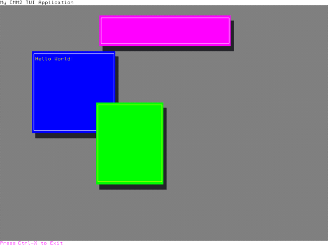

In my quest for creating a TUI library for CMM2. I have started by hacking a simple
screen using MMBasic to explore the screen, BLIT, and font capabilities. It looks like visually we can have a TUI library :)
But before I can start developing such framework I need to explore the following areas among other things:
[1] Is is possible to move and hold the cursor to a given location on screen?
[2] Is is possible to type (write) with a cursor having a for/background color?
[3] Is it in MMBasic possible to pass a Function/SUB as an argument for another Function/SUB, then being able to execute that argument within the parent Function/SUB?
[4] Possibility for having virtual pages, so we can have the functionality to open and close (multiple) windows.
[5] Possibility to write the basic TUI routines in a CSUB
I am open for ideas.

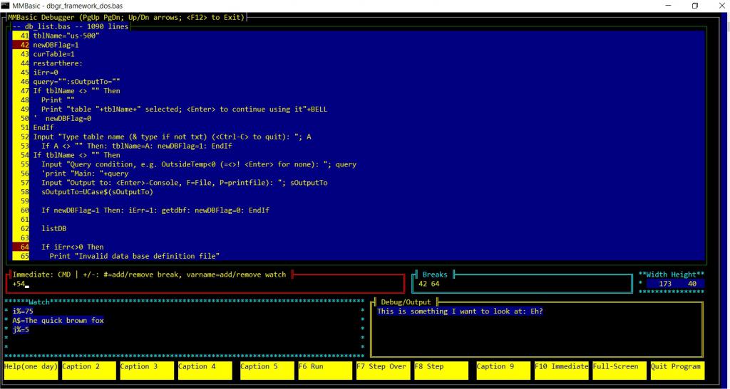

Posts: 3618
Posted: 07:46pm 05 Nov 2020
Something like this:
Using flip's framework from here: https://www.thebackshed.com/forum/ViewTopic.php?TID=9851
