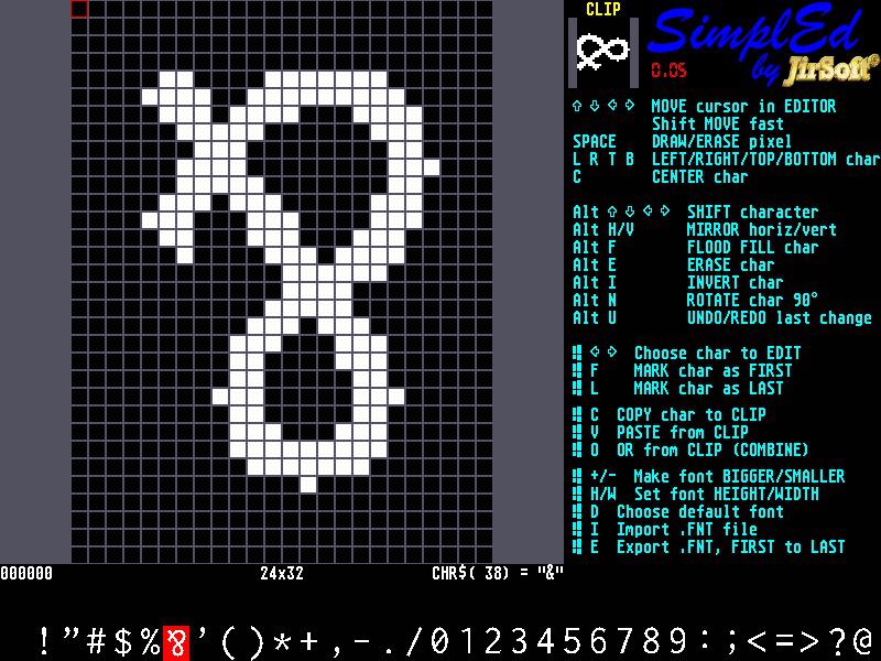

Hi,
I today put together very basic font editor for CMM2, SimplEd. Right now it hasn't too many functions, but for me, who like to do most of editing for CMM2 also on CMM2, it's at least start.
Export is somehow working (not for small fonts under 8 pixels width), import missing ( I would need good description of DefineFont format body, can somebody help me?), but you can load default fonts like template.
When you like it, put request for function extension here or just enjoy. When not, it was made for me...
Jiri

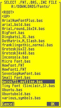

So I hope import also works, tested on some .BAS files in MMBasic Embedded Fonts directory and some .FNT files.
File selector in Import is terrible, because I bent down my info-box, but at least works...
Jiri

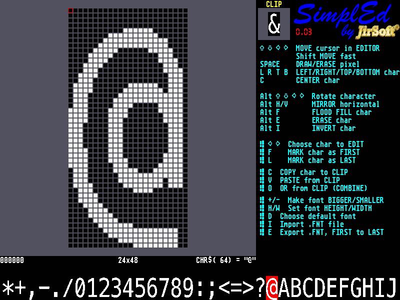

Some improvement in SimplEd:
Jiri

Posted: 08:11am 09 Dec 2020
  jirsoft said  Some improvement in SimplEd
Looks great! I wanted to try it out but the program appears to depend on CMM beta FW features, and that's a showstopper for me.
I hope we're getting a new FW release soon. I'll not only get a whole bunch of new MMBasic features to play with, but also a bunch of MMBasic programs that I can finally run.

Posted: 09:00am 09 Dec 2020
I'm happy, that at least picture looks good
I think I will try to remove the beta dependeces (it's mainly INC), because they are not needed I and I have to refactory and speedup some parts anyway...
Jiri

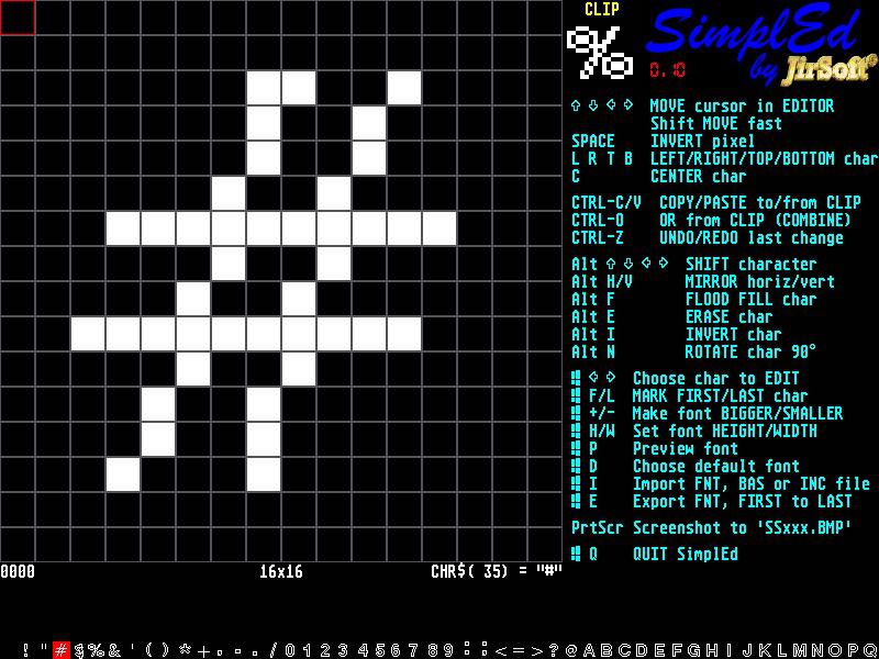

Some new screenshots:
Jiri
Posts: 4405
Posted: 07:06pm 13 Dec 2020
That is really looking impressive.

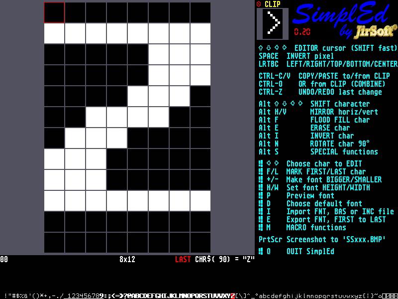

BIG news:
MACRO scripting
      you can record actions on one char and then play it to complete font, now limited to about 20 functions
      macros can be recorder, shown, played, erased
      for example record this macro:
      copy to clip, shift left, OR from clip, shift right to make char bolder
SPECIAL functions, prepared for extension
      rasterise vertical
      skew right and left
      can be included into MACRO
TUI.INC is removed from branch now, it can be downloaded from TUI.INC
(it's because of simple maintenance of  just one file...)
Enjoy!

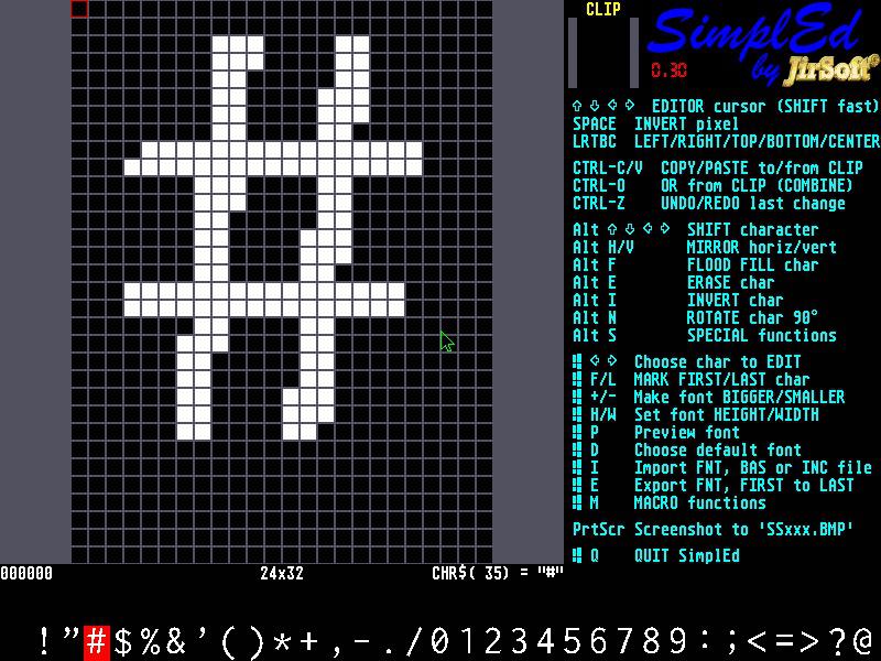

New version of SimplEd (0.30) with basic mouse support:
1. in editor: LEFT button sets pixels, RIGHT button clears pixels (both also set cursor)
2. in character set: LEFT button chooses character from set
3. in CLIP: LEFT button copy active char to clipboard, RIGHT button from clipboard, MIDDLE button OR from clipboard
Jiri

Observations:
- When I first run SimpleEd, I get a cryptic "Could not find path". Solved by adjusting comments on lines 23 and 24. (Path to TUI.INC file)
- Error in line 96: Not open. Solved by changing mouse port on line 63. The mouse port ought to be a CONST near the start if the program doesn't go looking itself.
- Mouse control is not released when I quit. (May not matter with newer firmware.) Needs something before the END on line 241
- Mouse doesn't move. All calls to MOUSE should specify the mouse port. (Default = 2) Check around line 63 and 95.
- If I use Alt-Right arrow and scroll the characters at the bottom of the screen sideways, characters do not reappear when I scroll back to the left again. (Depends on the font?)
- Ctrl-Z Undo doesn't always work as expected.
- The bottom row of pixels is missing from the font displayed along the bottom of the screen.
- Could Alt-N Rotate Char hold the effective square pixel region so than Alt-Arrows shift the otherwise cropped sections back into view?
Pretty awesome program! It works quite nicely!
Neat trick for extracting built-in fonts!

big thanks for very constructive reaction (and for nice words on end...)! I check most of the issues at evening (in Czech   ), but few responses:
  Quote  When I first run SimpleEd, I get a cryptic "Could not find path". Solved by adjusting comments on lines 23 and 24. (Path to TUI.INC file)
Here is problem, that you can not trap preprocessor errors, I will try to link the file on GitHub of SimplEd from TUI repository...
  Quote  Error in line 96: Not open. Solved by changing mouse port on line 63. The mouse port ought to be a CONST near the start if the program doesn't go looking itself.
First experience with mouse, maybe I will let user to switch port in config or test all ports. With the release it's clear my fault...
  Quote  If I use Alt-Right arrow and scroll the characters at the bottom of the screen sideways, characters do not reappear when I scroll back to the left again. (Depends on the font?)
It's combination of mouse (select char)/cursor (move) control? I need to check it...
  Quote  Ctrl-Z Undo doesn't always work as expected.
I use UNDO just for more pixels operation that can't be taken back otherwise. So not supported operations are for example:
SHIFT (ROTATE) - can be taken back with counteroperations
PIXEL ON/OFF - now with mouse need I think about it, but with SPACE it was just one pixel...
  Quote  The bottom row of pixels is missing from the font displayed along the bottom of the screen.
Need to check
  Quote  Could Alt-N Rotate Char hold the effective square pixel region so than Alt-Arrows shift the otherwise cropped sections back into view?
I don't understand, what you need. The rotation is taken from the center and is just rotate, not squeezing, so if you are rotating for example 8x16 char, you will loose upper 4 und bottom 4 rows...
Jiri
