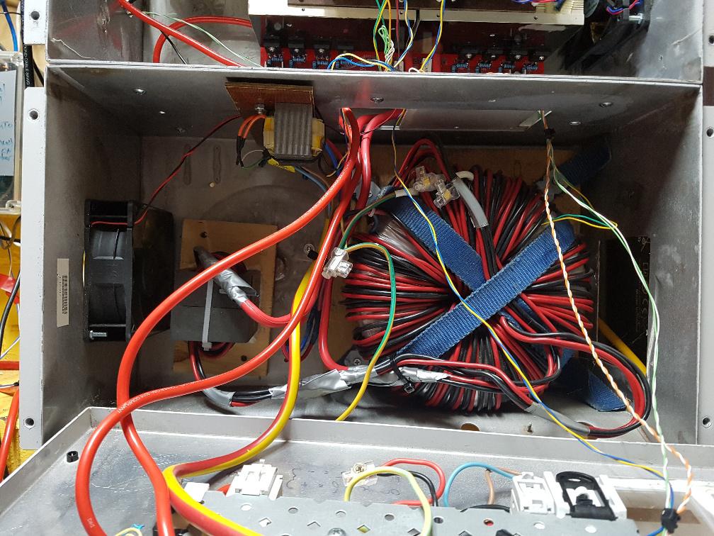

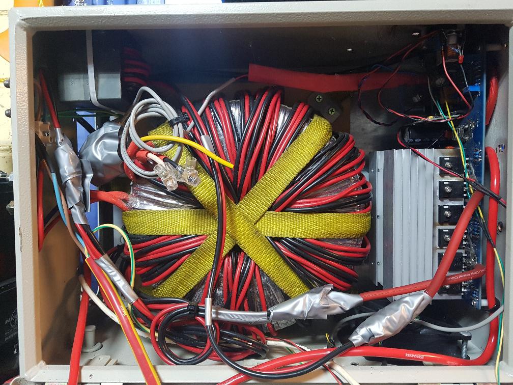

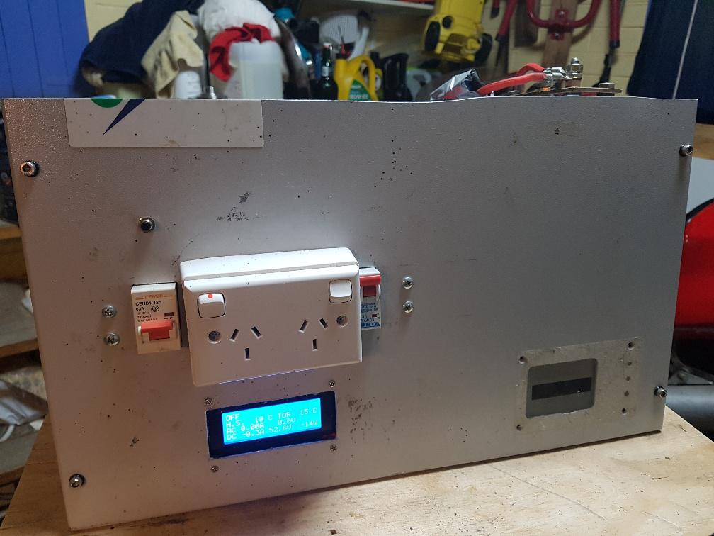

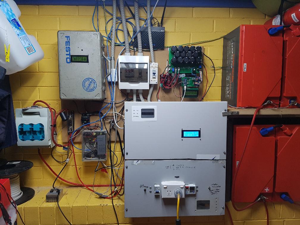

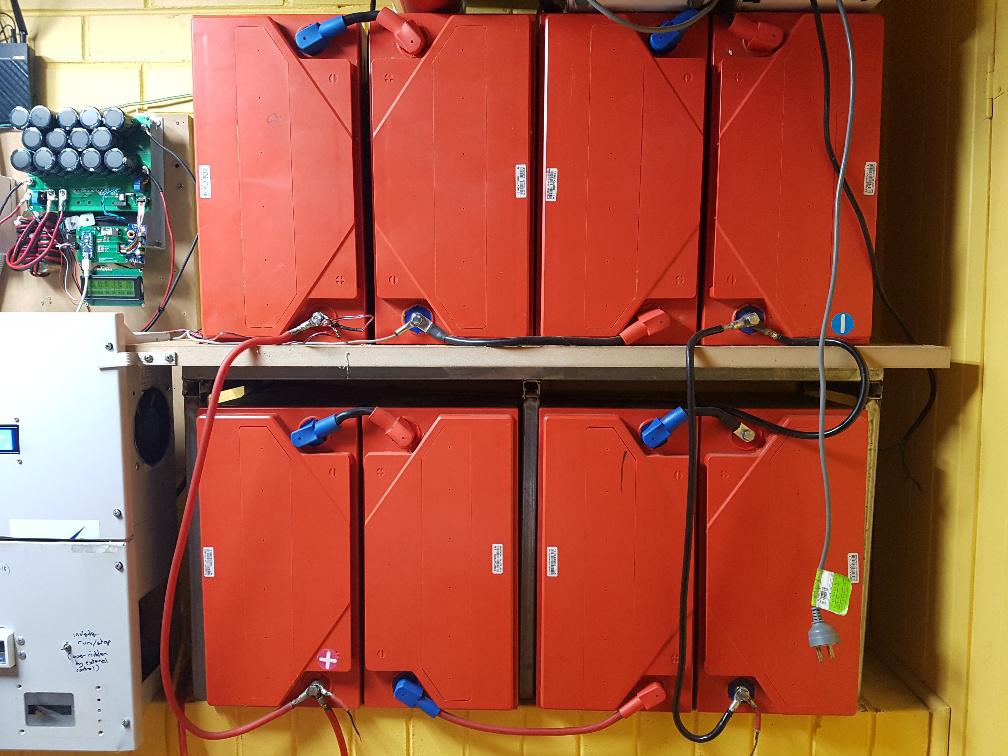

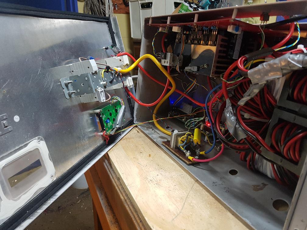

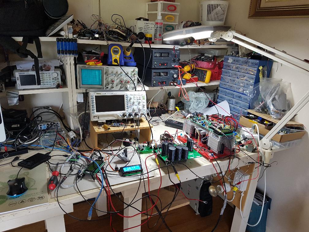

OK, I've finally grown up.
No more proprietary equipment used or needed.
Job done.

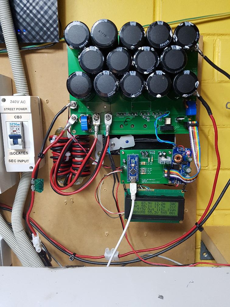

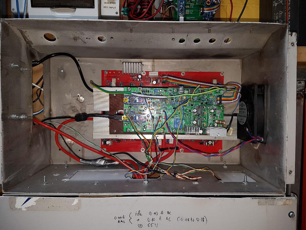

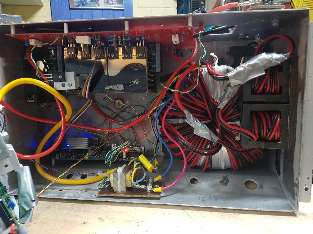

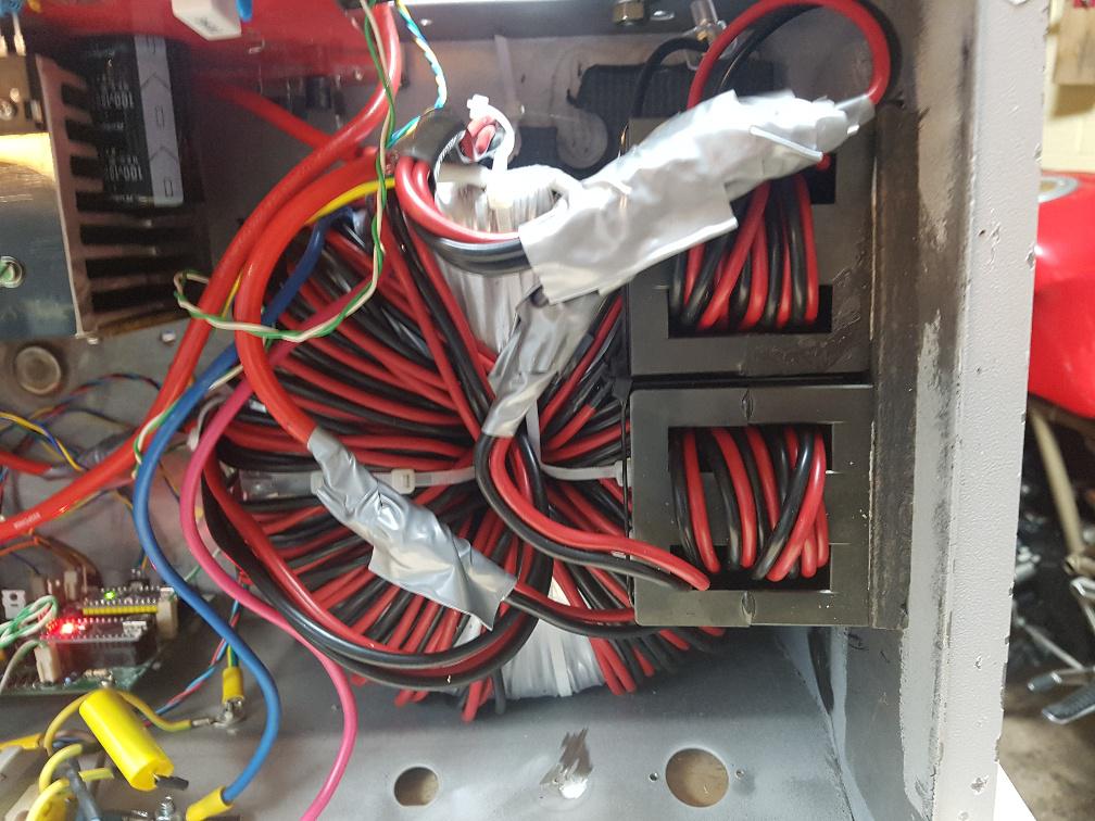

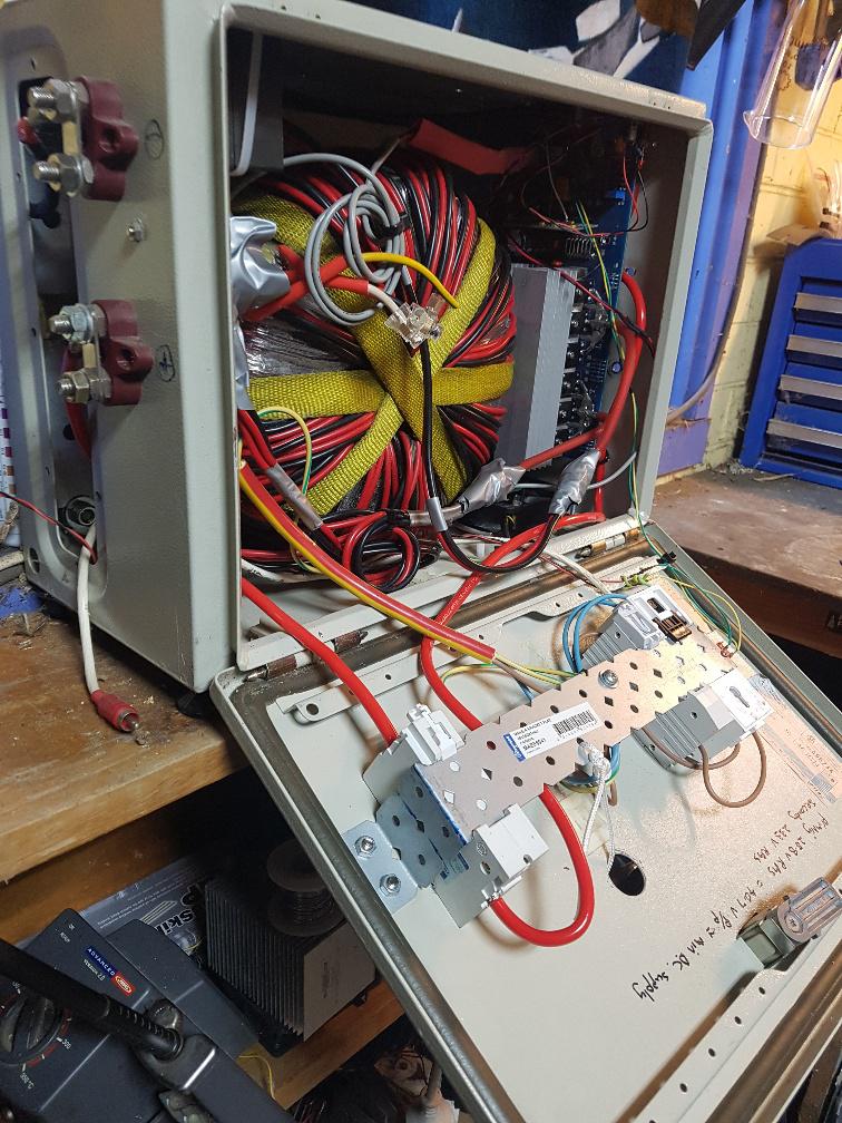

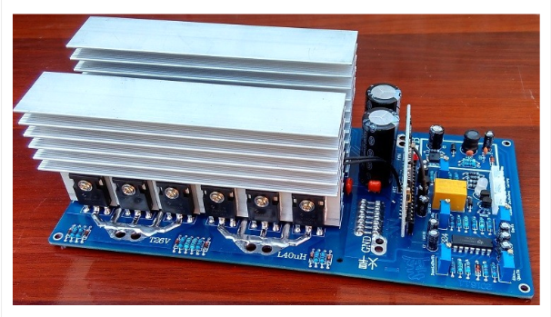

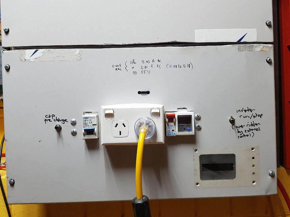

1 x home built inverter, 3kW, based on the nanoverter controller and Madness's 6kW power board.
(and I have designed a compatible PCB for the 6kW board. Yet to be built and tested to destruction....that could be fun)

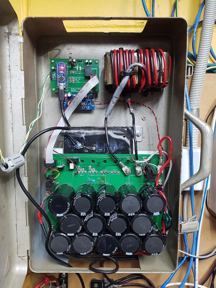

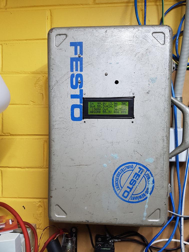

2 x home built MPPT charge controllers. These have calibrated thermistors on the battery terminals, to trim the charge voltage exactly as they warm up or cool down.
I saw no need for the inductor temp sensor but I could use a battery temp...
I can rebuild and repair the lot now. Don't even need schematics, it's all
too easy.
No more $2,700 AU inverters that last 2 years but not one month longer.
No more MPPT controllers that if you send a "Reset" command via the MODBUS interface
while the unit is connected to battery and solar, the unit will blow.
No more expensive components that provide zero support such as schematics and
product assembeld/designed to be user repairable.
(In the old days, Tektronix built oscilloscopes that were user repairable
by design and they give excellent repair information including schematics.)

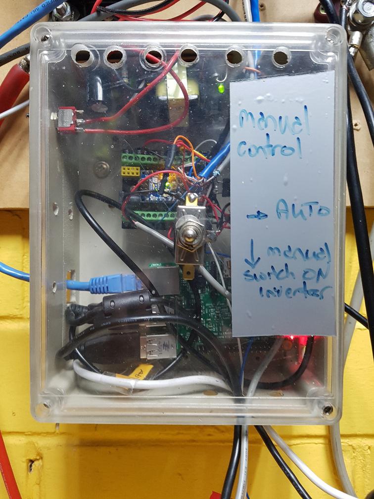

The control of the 2 MPPT and the inverter is done with a Raspberry Pi.
In addition to this, there is another Arduino Nano giving the controller
the DC Load current data, streep power, inverter real power,
and a few digital I/O pins that can drive 20mA at 5V
one which is used to run the pool pump.

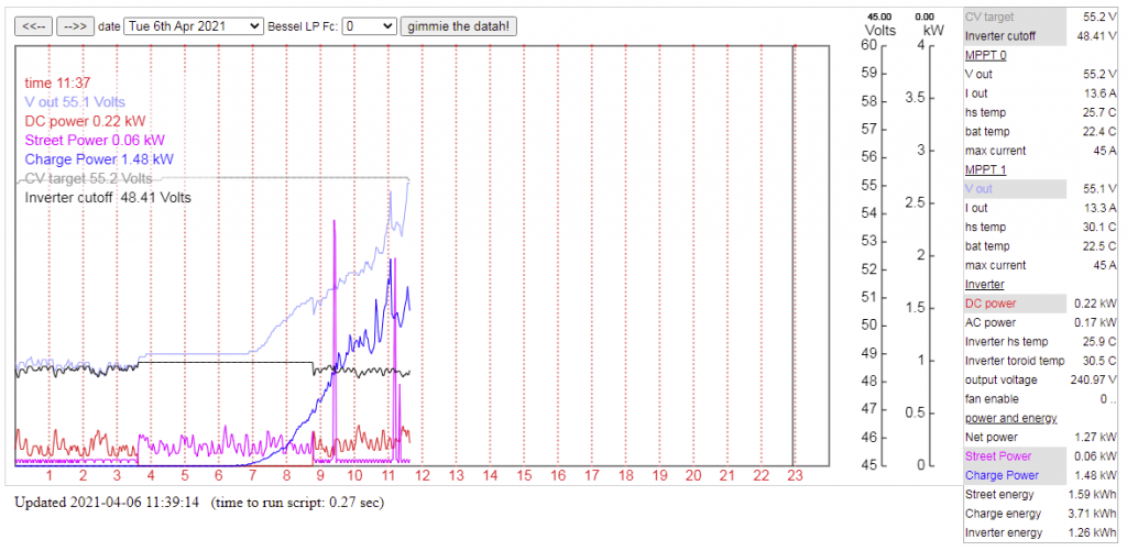

every 2 minutes send web requests to a few database servers to insert
a new row of data.
One local at home, one at work and one located in Sydney
Here is the monitor web page now. It looks the same but it's different.
Maybe a bit simpler.

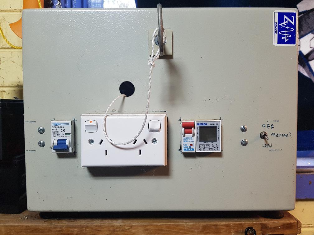

poida
Joined: 02/02/2017
Posts: 1515
Posted: 04:31am 10 Apr 2021
photos
the whole malarkey:
mppt0:
mppt1:
inverter:
the battery 48V 400Ah SLA:
the brains of the operation:
the workbench:
Edited 2021-04-10 14:35 by poida
rogerdw
Joined: 22/10/2019
Posts: 957
Posted: 07:00am 10 Apr 2021
That is awesome Poida, a picture is worth a thousand words  ...  and answers a lot of questions.
Cheers,  Roger

Is that an unmodified 3kw aerosharp with primary windings added on top?
poida
Joined: 02/02/2017
Posts: 1515
Posted: 12:39pm 10 Apr 2021
Haxby:
yes.
Haxby
Joined: 07/07/2008
Posts: 427
Posted: 08:28pm 10 Apr 2021
  poida said  Haxby:
yes.
Nice! I was thinking of doing that for the Pre-made Chinese inverter board I bought.

I think the combination of the 3kW with external windings is a good
way to go for moderate power builds.
You save a huge amount of time and effort.
The toroid is not 6kW for all day capable.
It's more 1kW all day with peaks to 6kW when starting motors.
My home inverter (seen above) provides for the house.
It supplies the 2.5kW heater in the dishwasher and the pool pump
(1kW) easily.
Here are the other two spare inverters. Both working.
First is the one that powered the house for a year while I built
a Madness powerboard based unit.
It uses 4 x 3 HY4008 FETS, without on-board totem pole gate drives.
(i.e. a board from Aliexpress.)
This means the IR2110 gate drive chips have their output stages exposed to
what I think are damaging voltage transients from EMI and capacitive coupling
of the FET gates. It works fine. But it's not close to how robust
the Mad board/nanoverter combo is.
next is the test victim inverter. It has 4 x 3 HY4008 FETs on a Madness 6kW
totem pole gate drive powerboard, driven by a nanoverter. This time a 2kW toroid is used.
I have had this driving a 2.5kW hot water urn and then started the 1hp compressor.
This is a solid inverter.
But it has weaknesses that have taught me a bit about builds.
e.g. the air flow is poor when I put it face UP and run it. It gets too hot too quickly. But sit it as shown and the ventilation hole is now at the top, taking warm air from the toroid away. It needs 1/2 the time running the fan when upright.
This inverter is used to try things such as one fan for both heatsink and toroid

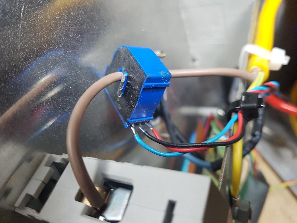

cooling, a proper current sensor on the AC output, the serial data LCD,
how small a toroid is possible, and detail changes to nanoverter code.

Poida, what kind of batteries are these on your sideways mounting system?
poida
Joined: 02/02/2017
Posts: 1515
Posted: 12:51pm 11 Apr 2021
Narada rex-c 12V 200 Ah
Carbon SLA, supposed to be good for partial state of charge applications.
I like lead acid since it's hard to blow them up and burn the house down.
Lithium on the other hand...
But if I buy another battery it might be Lithium.
Put it in a steel box, 10 meters from the house.
Maybe OK.

Murphy's friend
Joined: 04/10/2019
Posts: 678
Posted: 08:53am 12 Apr 2021
  poida said  Narada rex-c 12V 200 Ah
Maybe OK.
Yes, whatever you are happy with. The Lithium type (LYP) I originally bought does supposedly not burn, it has not in the 8 years since I got them but I had two internally shorted cells - and no fire at all - by now.
The new bank is the Lion type EV power sells, so far no problems either.
Batteries are inside my games room/workshop and not yet in a box (future project).
