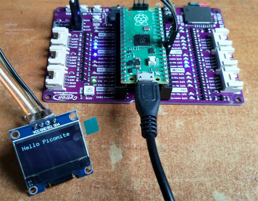

This version starts the process of implementing display support. This is based in the ArmmiteL4 but with a PicoMite twist.
The first display implemented is an I2C SSD1306. This should be set to the default address (0x78/0x3C)
In order to use the display we need to allocate the I2C pins. This works the same as the pins for the SDcard
OPTION SYSTEM I2C sdapin, sclpin
These pins must be valid I2C0 or I2C1 pins and will be configured to run at 400KHz. In future the SYSTEM I2C will also support a DS3231 RTC. Other devices can be connected to the I2C bus and accessed as usual with I2C READ and I2C WRITE. The I2C port does not need to be opened in this case.
The display is then enabled with
OPTION LCDPANEL SSD1306I2C, orientation
or
OPTION LCDPANEL SSD1306I2C32, orienation
for the 128x32 version of the display
If you can find a 1.3" version that works in I2C mode you can add a parameter offset to locate the image correctly
Typically this would be:
OPTION LCDPANEL SSD1306I2C, l, 2
All the usual graphics command should be there but testing is limited

Hope someone (and I know that probably means Peter) can tell me the idiot mistake I'm making.
I'm using the same Maker Pi Pico pictured above and had the SD card working with a25, but both a26 and a27 have failed for me:
> option list
OPTION COLOURCODE ON
OPTION CPUSPEED (KHz) 250000
OPTION SDCARD GP15, 10
> files
Error : A hard error occurred in the low level disk I/O layer
> Warning: SDcard Removed
- I have tried CPUSPEEDs of 200000 and 225000 with the same result
- the ", 10" on the SDCARD line is new for a27, what does it mean ?
- when I boot the GP12 and GP15 leds are lit
- when I type "files" GP10 and 11 briefly pulse (11 *may* be pulsing twice), GP15 briefly extinguishes

Posts: 9286
Posted: 06:58pm 20 Jun 2021
Update to my little help file:
Picomite doc a28.zip
Posts: 9286
Posted: 07:29am 21 Jun 2021
Using a28
OPTION SDCARD GP1,10 is working fine for me, Tom.
OPTION SYSTEM I2C GP20, GP21 (I2C0) is accepted
RTC GETTIME and RTC SETTIME both give a RTC not responding error.
The RTC is one of the blue DS3231 modules with a memory chip on board.
RTC address is 0x68 R/W (I don't think this can be changed)
EEPROM address is 0xA0 write and 0xA1 read by default
It works fine at 400kHz using the Micromite library.
OPTION SYSTEM I2C DISABLE doesn't seem to free off the pins. After a reset, without setting SYSTEM I2C, the library uses the pins and works fine.

Posted: 07:39am 21 Jun 2021
  Mixtel90 said  Using a28
Same for me. Tried a couple of different ones.Added 4.7K pullups.
SSD1306I2C32 on same pins seems OK

Please try RTC on a pair of I2C1 pins

Note you can't use pins GP18, GP19, GP20, GP21 or GP22 for I2C on the Maker board as these are wired to switches and/or the audio port in an incompatible way

  matherp said  Please try RTC on a pair of I2C1 pins
I moved from GP20 and GP21 (I2C) where RTC did not respond
to GP18 and GP19 (I2C1)  and RTC seems to be OK now.
LCD was OK on both.
