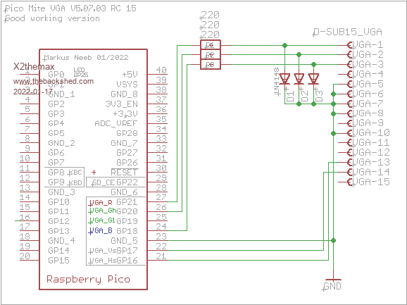

hitsware2
Joined: 03/08/2019
Posts: 738
Posted: 11:44pm 09 Jan 2022
VGA5.07.03R-C10.UF2
O.K........ got a gender bender
Is this :
GP16 connect to VGA socket pin 13
GP17 connect to VGA socket pin 14
GP22 connect to VGA Socket 1, 2, or 3 via 220ohm resistor
Connect 1n4148 diode anode to VGA socket pin 1,2,or 3.
Connect 1N4148 cathode (bar end) to GND
Connect GND to VGA socket pins 5,6,7,8,10
Still correct wiring ?
Do not have to have PS2 keyboard , right ?
VGA monitor should work in same fashion as OLED or ?
I am getting a signal ( screen goes dark ) , but no
picture ...... ?????

Posts: 3393
Posted: 01:06am 10 Jan 2022
GP20 supplies the luminance signal for monochrome not GP22, all else is ok.
The keyboard is optional, as console is normal USB. Works fine with TeraTerm, have not tried Minicom. Most PS/2 keyboards will run off 3.3V so can connect straight to the Pico. Usually no pullup resistors are needed, so it is a piece of cake if you have one of them.
From Addendum to PicoMite Manual
VGA Wiring
pin GP16 to VGA pin 13 (HSYNCH)
pin GP17 to VGA pin 14 (VSYNCH)
pin GP18 220R to VGA pin3 (BLUE). 1n4148 from pin 3 , cathode to GND
pin GP19   R5 - see diagram below  (GREEN LSB)
pin GP20  R6  - see diagram below  (GREEN MSB / mono VGA out)<<<<<<<<<<<<<<<<<<<<<<<
pin GP21  220R to VGA pin2  (RED). 1n4148 from pin 1, cathode to GND

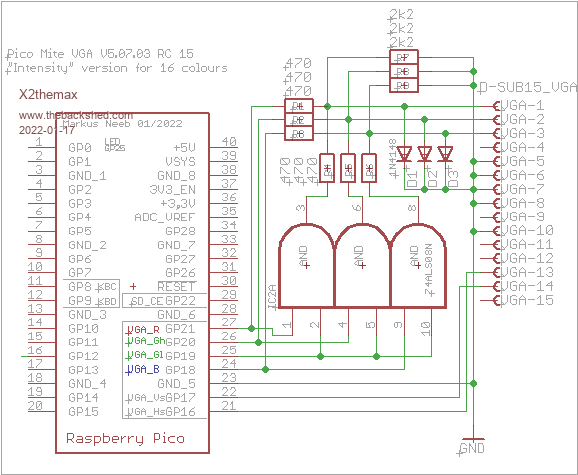

X2themax
Joined: 10/12/2021
Posts: 11
Posted: 05:50pm 16 Jan 2022
Hi there !
First of all, thank you for this great project!
The work that you all put into the Pico Mite is really enormous.
I think it's great to have a 5Euro BASIC interpreter computer with MM-Basic.

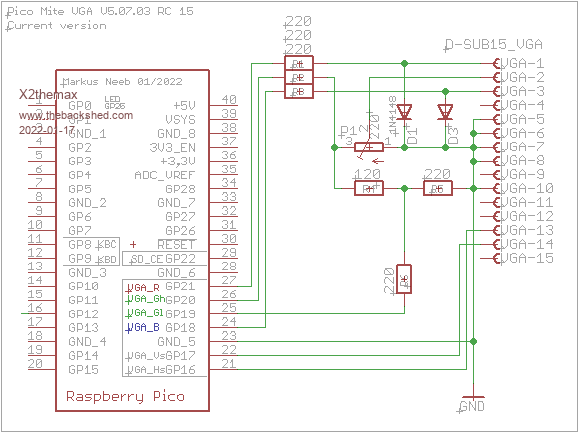

I have already built both versions of the Pico and have a few questions about the VGA version. (...and possibly a few ideas)
I do not understand the current structure with the colour correction.
Why do we need a green LSB and MSB signal ?
Is it right that we have only 8 colours ?
I figured out, that regular 220 ohm resisors and diodes are working very well for an acceptable VGA output with a good white balance:
Now my idea based on an intensity signal like the VDC of a commodore 128 with 16 colours:
In this version 3 AND gates are combining a intensity signal with each colour signal go get 2 shades of the same colour.
What are you thinking about it ?
Best regards form germany and sorry for my poor english language.
Markus
Posts: 11929
Posted: 06:04pm 16 Jan 2022
Markus
The VGA code uses 4-bits for each pixel. I have called this RGB121 and it gives 16 colours if wired correctly. However, each "bit" could be connected in any way you like e.g 16-level greyscale using a 4-bit R2R DAC.
The firmware provides named colours that can be used for all 16 possible outputs and these represent the actual colours if wired RGB121.

Posts: 4386
Posted: 06:52pm 16 Jan 2022
Yes.
Other names would make sense with your idea.

Posts: 3393
Posted: 07:26am 18 Jan 2022
One possible way to map RGIB(1,1,1,1) (untested)
Re-map RGB(1,2,1) VGA to RGIB(1,1,1,1)
Colour to       Intensity       Mapped
Display         pin(GP19)      Colour
white           0               lilac
yellow          0               brown
magenta         0               magenta
red             0               red
cyan            0               cerulean
green           0               midgreen
blue            0               blue
black           0               black
white           1               white
yellow          1               yellow
magenta         1               fuchsia
red             1               rust
cyan            1               cyan
green           1               green
blue            1               cobalt
black           1               myrtle
DIM integer WhiteD(1) : WhiteD(0) = RGB(lilac) : WhiteD(1) = RGB(white)
DIM integer yellowD(1) : yellowD(0) = RGB(brown) : yellowD(1) = RGB(yellow)
DIM integer magentaD(1) : magentaD(0) = RGB(magenta) : magentaD(1) = RGB(fuchsia)
DIM integer redD(1) : redD(0) = RGB(red) : redD(1) = RGB(rust)
DIM integer cyanD(1) : cyanD(0) = RGB(cerulean) : cyanD(1) = RGB(cyan)
DIM integer greenD(1) : greenD(0) = RGB(midgreen) : greenD(1) = RGB(green)
DIM integer blueD(1) : blueD(0) = RGB(blue) : blueD(1) = RGB(cobalt)
DIM integer blackD(1) : blackD(0) = RGB(black) : blackD(1) = RGB(myrtle)
' usage: ColourD(Intensity) where Colour to Display = ColourD & Intensity = 0 or 1 = GP19

X2themax
Joined: 10/12/2021
Posts: 11
Posted: 03:40pm 18 Jan 2022
Hi,
it works perfectly.

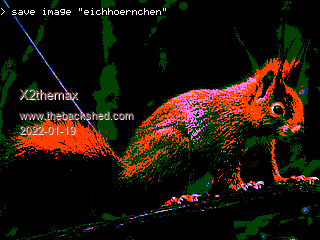

I have loaded this little Image:
RGB-Test.zip
...and it works !
I find it interesting how the image routine quantizes the image.
I guess Phil's idea of a RGIB() command is not bad.

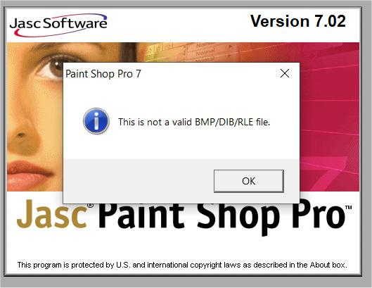

Posts: 3884
Posted: 04:16pm 18 Jan 2022
  X2themax said  ...and it works !
Great, but why not just show us the image rather than make us download the file, unzip it, and then, when I double-click on it, get "rgb.bmp It appears that we don't support this file format", or when I try to open it with PaintShopPro, get
Posts: 9163
Posted: 04:29pm 18 Jan 2022
Irfanview has no problem in opening either image, even direct from the zip file.
Posts: 3393
Posted: 09:35pm 18 Jan 2022
Loading an image directly into the Pico won't give the correct RGIB rendering as the built in image viewer is still decoding it as RGB(1,2,1). It will be necessary to pre process images in a suitable image editor to change the colour palate to make them decode correctly on the Pico despite it not having the correct decoder for RGIB hardware.
I think the re-mapping, in a previous post, of colours only works for graphics and text generated by the Pico not loaded images.
Edit. The mapping in my previous post was done whilst half asleep. Though correct it is poorly thought out.
Here it is again.
DIM integer whiteD(1) = (&HFF80FF,&HFFFFFF)
DIM integer yellowD(1) = (&HFF8000,&HFFFF00)
DIM integer magentaD(1) = (&HFF00FF,&HFF40FF)
DIM integer redD(1) = (&HFF0000,&HFF4000)
DIM integer cyanD(1) = (&H0080FF,&H00FFFF)
DIM integer greenD(1) = (&H008000,&H00FF00)
DIM integer blueD(1) = (&H0000FF,&H0040FF)
DIM integer blackD(1) = (&H000000,&H004000)
Edited 2022-01-19 15:54 by phil99

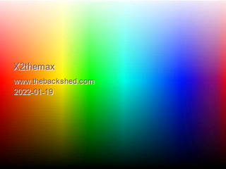

OK -sorry- I will check it !
Here is the test image rgb.bmp:
Ok...
XnView opens the picture without any problems.
It is a reguar RGB-Bitmap and the Pico load this picture correct.
If you have any problems I try to post it again.
X2themax
Joined: 10/12/2021
Posts: 11
Posted: 11:13am 19 Jan 2022
You should now see the following on the Pico Mite:
Now all 16 colours are displayed.

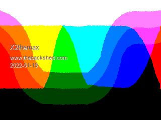

X2themax
Joined: 10/12/2021
Posts: 11
Posted: 11:21am 19 Jan 2022
I forgot the following:
If you assign the GPIOs wrong, the two shades of green are reversed and the picture makes no sense!
It should work as above if you coose the right GPIOs.
The Second Image shoult be displayed like this:
