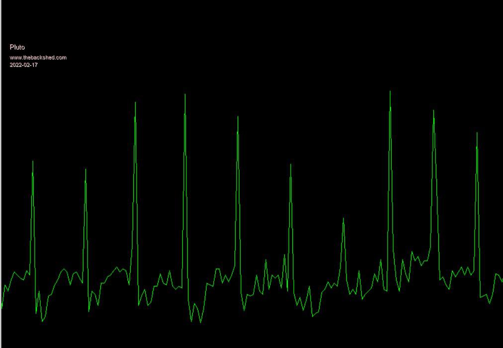

Serial communication works well up to 230400 Baud (with a Microbridge). For higher speed, do you think an other type of USB-TTL like CP2102 would help? Any ideas where the bottleneck could be?
Tested with an old DIY ECG. Faster datastream would be needed for diagnosis; but at least i can see that the patient is alive.
Regards Fred
