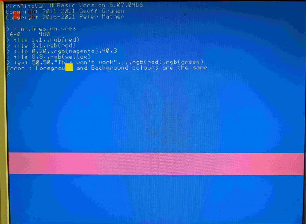

This test version implements some basic colour handling in the "mono" 640x480 mode (previously green on black). Please excuse the poor picture.
As in the 320x240 mode it uses 4 I/O lines to drive the display + the HSYNC and VSYNC lines and these are not available for any other use.
This version will clear the flash and all options so backup anything important.
The VGA screen is split up into 40x30 tiles each 16x16 pixels. Each tile can have a different foreground and background colour assigned to it out of the 16 available.
Use:
OPTION DEFAULT COLOURS foreground [,background]
to set the display. Valid colours are white, yellow, lilac, brown, fuchsia, rust, magenta, red, cyan, green, cerulean, midgreen, cobalt, myrtle, blue and black. If background is omitted it defaults to black
e.g. as is set in the picture
OPTION DEFAULT COLOURS WHITE,BLUE
There is a new command TILE that can be used to set the foreground and background color of each 16x16 area
TILE x, y [,foreground]  [,background] [,no_tiles_wide] [,no_tiles_high]
When used any data in the area defined by the tile will immediately change colour. See the red changes in the copyright text.
It is important to realise that the changes are happening in the driver. Writing to the display is still inherently "mono" i.e. the foreground colour can only be 0 or not-zero and the background not-zero or 0
Note how using the TEXT command with non-zero colours for both foreground and background will give an error as the text would be invisible. I've made this an error for text to highlight that the display is still "mono". Using border and fill colours for any of the other drawing commands won't error but non zero colours will all be the same (as defined in the tiles on which the drawing element is written).
The basic reason for this change was to allow the user to select colours for the mono display rather than having to use green on black. The tiles structure was a "nice-to-have" that may allow you to use colour in your programs in the full VGA mode. In addition it means that the link on the PCB to select between mono and colour becomes redundant - just leave it on colour. The only downside is locking up the three extra I/O ports but if the 320x240 mode was ever to be used these must be connected to the display so are of limited use.

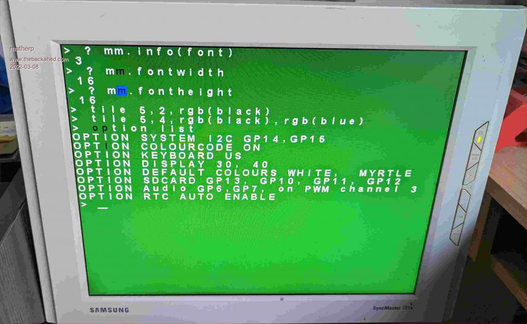

V5.07.04b7
PicoMiteVGA.zip
This version tries to finalise the changes made in this thread which will become a permanent part of the PicoMiteVGA
OPTION COLOUR VGA ON/OFF is removed
Use OPTION DEFAULT MODE 1 to boot in 640x480 mode
Use OPTION DEFAULT MODE 2 to boot in 320x240 mode
This option is permanently stored
To switch modes in a program use the new MODE command
MODE 1 sets to 640x480
MODE 2 sets to 320x240
As before Use:
to set the display colours. This is a permanent option and applies to both modes. Valid colours are white, yellow, lilac, brown, fuchsia, rust, magenta, red, cyan, green, cerulean, midgreen, cobalt, myrtle, blue and black. If background is omitted it defaults to black
There is a new command TILE that can be used to set the foreground and background color of each 16x16 area in mode 1 (640x480)
TILE x, y [,foregroundcolour]  [,backgroundcolour] [,no_tiles_wide] [,no_tiles_high]
This command is ignored in mode 2
The other changes in this beta are to properly set the options for the keyboard after an OPTION RESET and to improve performance of blit in both modes
Font 3 is changed to Arial BOLD 16x16. This is designed to match the tile structure in mode 1 so letters can be individually coloured.
Edited 2022-03-08 03:15 by matherp
