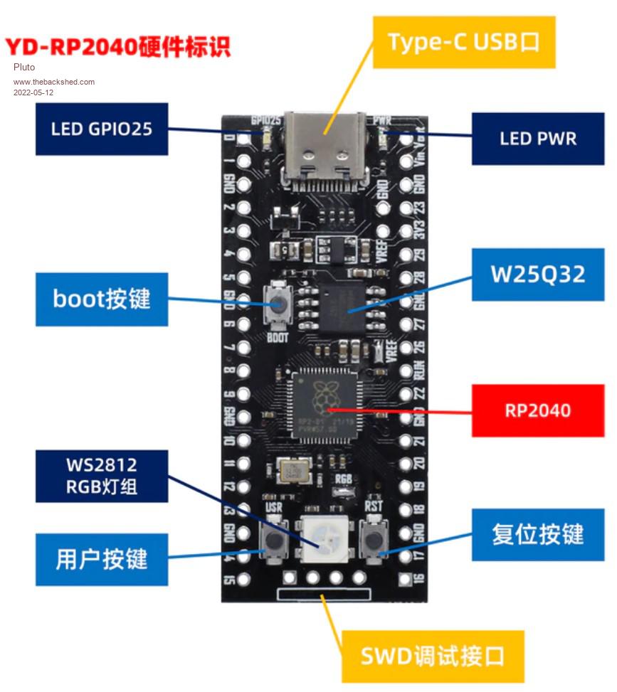

Got today YD-RP2040 made by WWW.VCC-GND.COM from Ali Express.
Notable features of the VCC-GND Studio YD-RP2040 when compared to the Raspberry Pi Pico are:
Power LED
Type-C USB connector
Reset button (GP24)
User button
WS2812 RGB LED (GP23)
4MB of flash

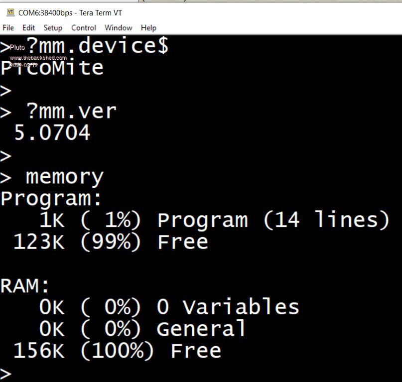

Tested very briefly. At least I got the WS2814 RGB LED working as expected.
I do not remember that I have seen it on the forum earlier. Price US$5.55 from AliExpress
SZ Aitexm Store. (Price very similar to the cheapest "normal" Picos on Ali E).
Does anyone have experience of this type? Drawbacks compared to "normal" Pico?

  Quote  Drawbacks compared to "normal" Pico?
Not pin compatible - beware

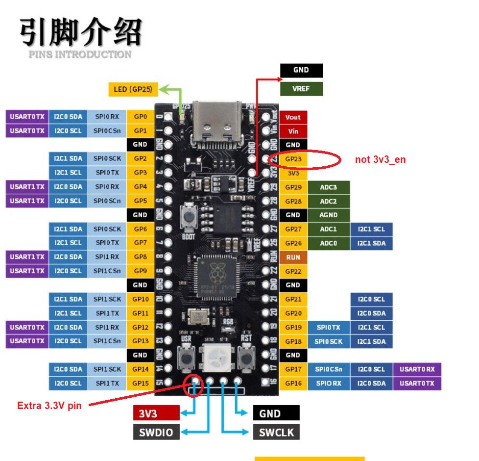

The only difference is pin 37 is GP23 instead of 3v3_en
and an extra 3.3v pin on the bottom edge of the board next to the SDIO pin

I've used the YD-RP2040 for a while. It seems to be a pretty well thought out alternative but you have to be aware of several points:
The WS2812 needs to be enabled via a solder blob link. If you don't enable it then GP23 can be used as an IO pin.
VREF also needs to be enabled via a link. By default the ADC pins are all digital. Alternatively you can also inject your own VREF via a flying lead.
The maximum speed I've managed to clock them is 252MHz. They work fine for VGA.
As the regulator is analogue there is no 3V3EN. That pin is used by GP29.
The supply pins are different. The VBUS diode is always in circuit and VBUS isn't available. This makes it unsuitable for USB systems. The diode goes from the USB VBUS to VOUT'
VIN has another diode to VOUT. It's very good as a standby supply pin.
The USB D+ and D- connections are not available, which also makes it unsuitable for USB systems.
I think that's about it. There is a circuit diagram available.

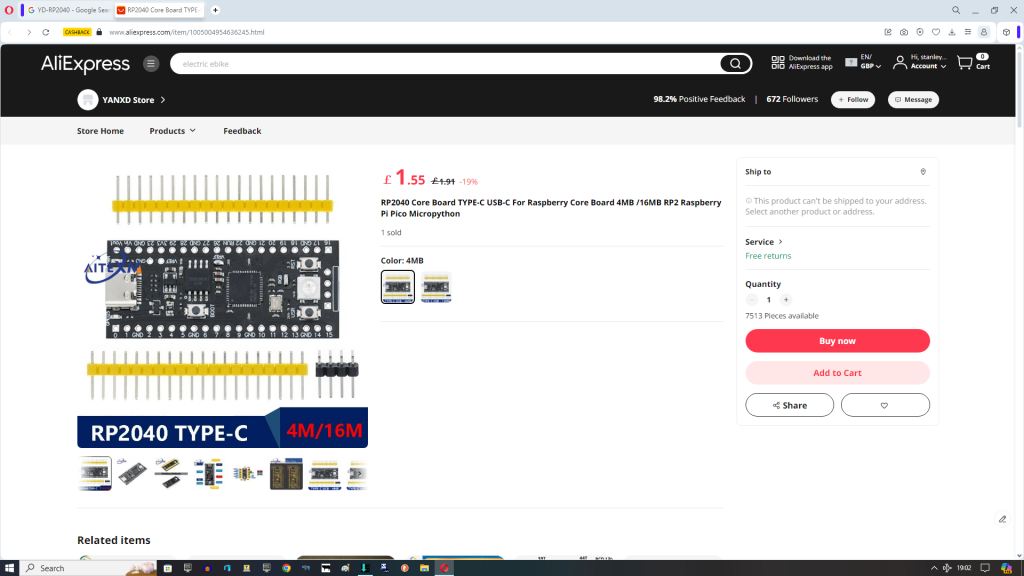

if I plug a usb hub powered 5V into this rpi and usb kb into hub be able to use pico usb?
Posts: 2807
Posted: 06:09pm 01 Apr 2024
ordered 5, £11.28 total
Posts: 2807
