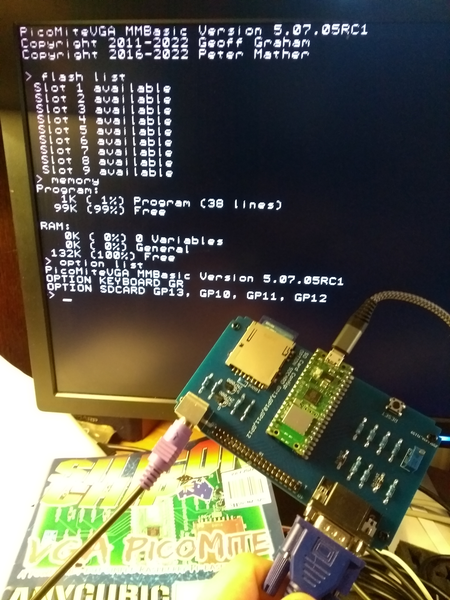

V5.07.05RC1
OPTION LIST now shows version number and which firmware
Fixes issue where connecting a USB CDC cable would cause the VGA version to Hardfault

Thanks very much for the enhancements.
VGA version does indeed return with everything intact after a Windows power off and reboot while USB is connected.

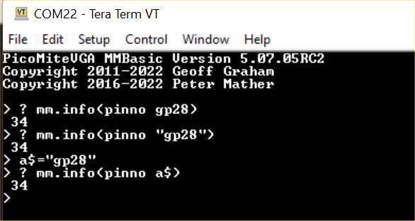

V5.07.05RC2
MM.INFO(PINNO n) now accepts a string literal, a string variable or an unquoted GPn designation
Edited 2022-09-24 19:56 by matherp

V5.07.05RC3
Improved error messaging for incorrect pin usage.
Fixed MM.INFO(pinno when OPTION EXPLICIT specified.

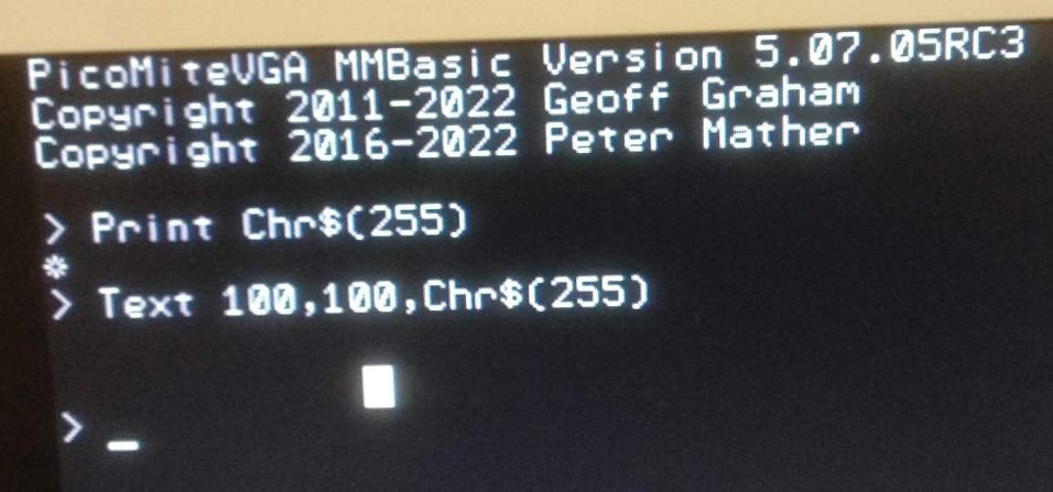

Could you take a look at this issue using TEXT and CHR$(255) for me please:

Posts: 12306
Posted: 12:58pm 25 Sep 2022
This is the code for the text issue - something Geoff has put in the MM+ and I've just copied
   while(*str) {
       if(*str == 0xff) {
//            fc = rgb(0, 0, 255);                                // this is specially for GUI FORMATBOX
           str++;
           GUIPrintChar(fnt, bc, fc, *str++, jo);
       } else
           GUIPrintChar(fnt, fc, bc, *str++, jo);
Mode 7:For i=1 To 10:Text i*Mm.Info(FontWidth),"A","CT",1,1:Next
This is missing the Y coordinate
Edited 2022-09-25 23:01 by matherp
