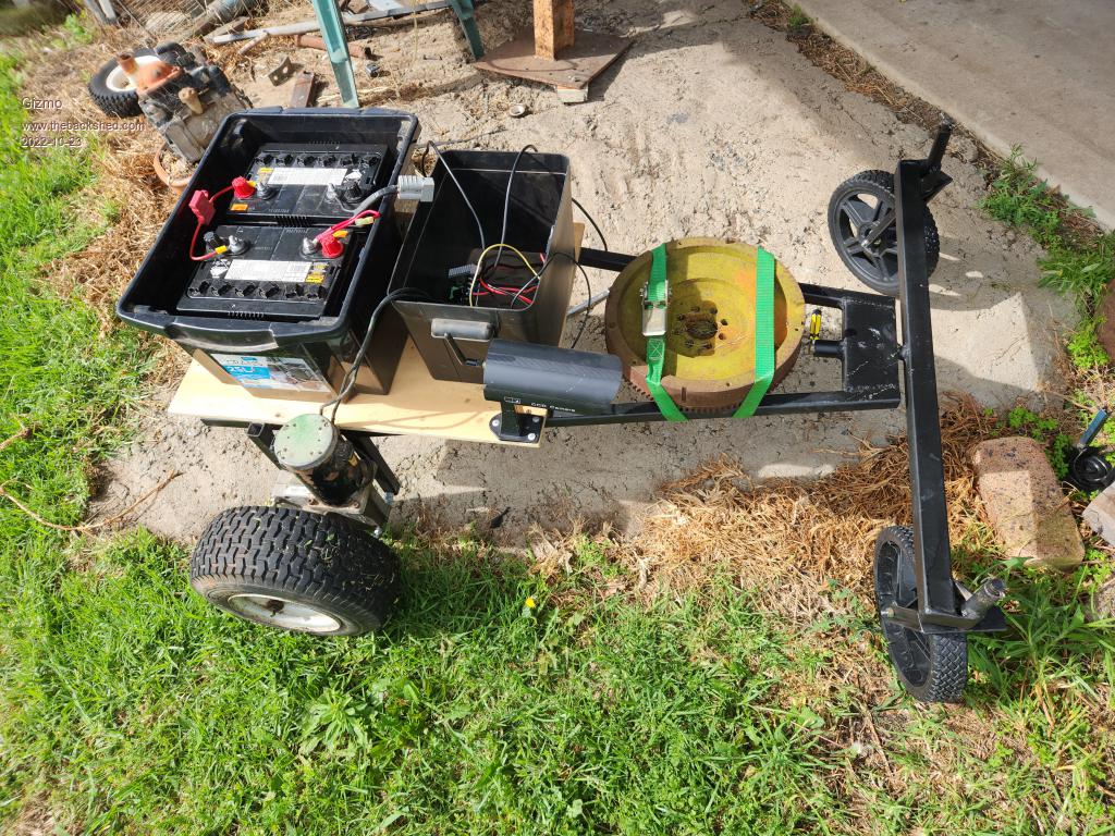

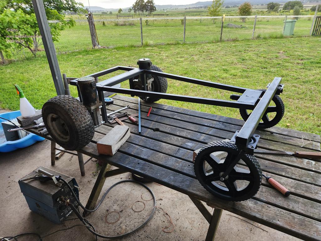

About 12 years ago I picked up a little electric golf buggy for $60, minus batteries. It would be good for a future project I though at the time. Last week I took off the twin DC motor drives, the rest will make a good platform for a IC powered buggy.
Bought/found some steel and built the frame. The front wheels are castors, it will be steered by the back two motors.
The motors are rated at 24v 12 amp, so next I ordered a 25amp twin drive motor controller from robotgear.com.au, arrived today. The controller has forward and reverse, and several input options, including generic RC ( Remote Control ).
Found a couple 24v pancake motors, something I would have picked up at a clearing sale years ago. I tend to accumulate stuff like this. To get a 1000mm wide cutting width, I need two blades at 505mm diameter, one offset forward of the other to give a overlap without hitting each other. Bolted a 505mm piece of 40x3mm flat to one motor for a test, scary, but it spins up quickly and though not sharpened yet, its cuts grass easily. Each motor draws about 1 amp no load.
Next up I'll wire in the motor controller and use a RC unit to drive it around the yard.

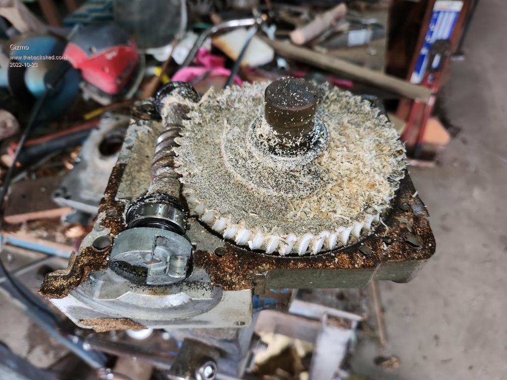

Had a set back
The motor controller had arrived, and I purchased a couple new 60Ah deep cycle batteries for a good price. Rigged it all together with a remote control and wifi camera, and took it for a drive.
They motors had a lot of torque and it wanted to wheel stand, so added a big old flywheel to the front to put some weight in the nose. Fixed.
Then all of a sudden one motor was slipping. It was a noisy gearbox from scratch, and I had intended to pull it apart and replace what I though would be a noisy bearing. Removed the motor and pulled the gearbox apart. Its stuffed, nylon gear is stripped.
The model number returns nothing, its a EMD GB225-3002B. Made in the UK.
So looks like I'm taking a few steps backwards. The motors were rated at about 300 watts, and this was way more power than it needed. Most of the time it will be going at a nice casual walking speed. Oatley electronics used to sell a 250W geared down motor, but looks like they got out of scoota stuff. I'll keep looking.

That looks like a job for a 3D printer...

  TassyJim said  That looks like a job for a 3D printer...
That 3D printer plastic might be too soft. I made similar gears om my lathe out of aluminium, to be used in my solar tracker. Worm gear cutting on a lathe can be done if an indexing head is bolted to the cross slide and the indexer is driven from the screw cutting shaft. One is limited to the number of teeth possible by the available lathe gear ratios but it was quite a few as I remember.

Yeah I tend to agree, the 3D printer option wouldn't last very long, but it did have me thinking about it.
Looks like I can probably get another gear box and retrofit it for around $200. But looking into other options as well, like a chain drive. No rush.

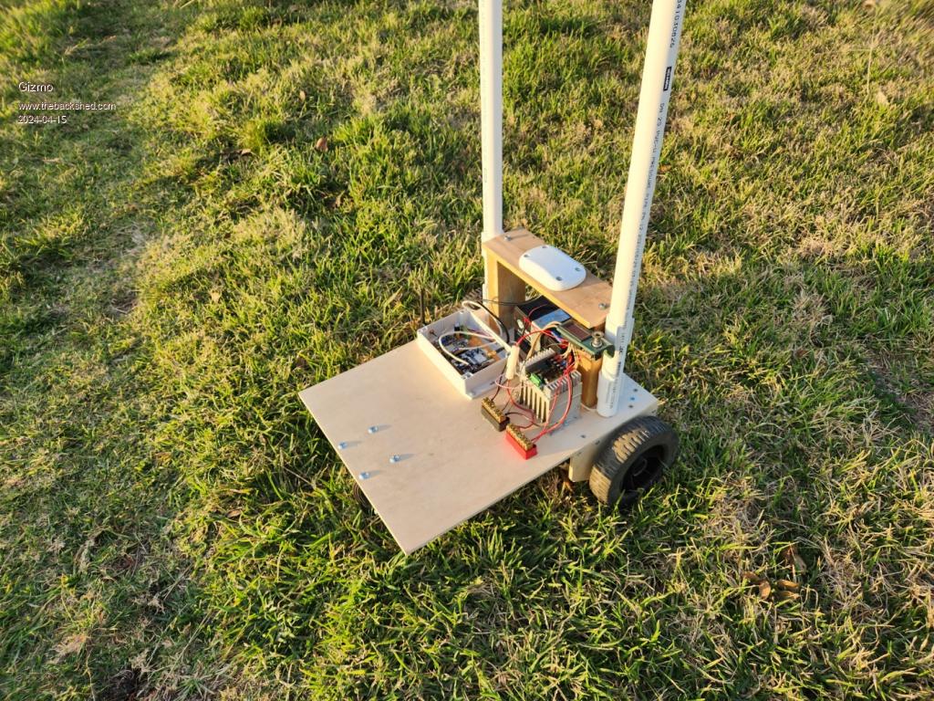

Posts: 5203
Posted: 05:05am 15 Apr 2024
OK, about time I updated this thread.
Lots of changes.

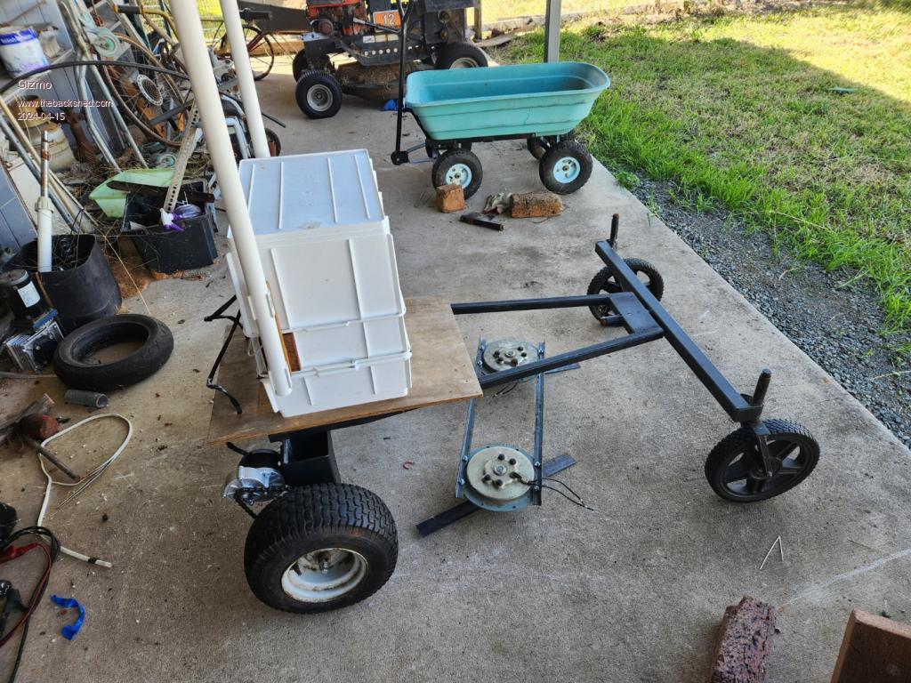

Built a little rover using a pair of windscreen motors to drive the wheels. Got the ESP32 code to a point where I could give it a list of waypoints and it would drive from one to the other. But I did have a issue where it would move in a curve instead of a straight line. I knew what was going on, and how to fix it, but I decided to go down a different path, unfortunately.
Bought a flight computer ( $170 ) and installing Ardurover firmware, using Mission Planner on the laptop to program missions, etc. This is a common solution and a lot of the rover/mower builders go down this path.
Problem is, it was a hell of a learning curve. Very complicated, hundreds of settings to play with, documentation a bit useless. But after 6 weeks, its now working, fingers crossed.
In hindsight, I should have stuck with the ESP32 and my own code, it was so close, and it would have been easy to add features as I needed them. I may still do this, see how things go.
Moved the smarts to the bigger rover. The worm drives were terrible, 10 amps just to free wheel. Bought a pair or gear reduction scoota motors and some bike sprockets and chain. Much better.
Next I'll mount the cutting deck and see how it goes cutting grass.
I have a question. Which way should it go, drive wheels at the back or front? I can see merits for putting the drive at the front, including a longer wheel base and the caster wheels have less authority when they hib a bump. Any thoughts?
Edited 2024-04-15 15:07 by Gizmo
Murphy's friend
Joined: 04/10/2019
Posts: 678
Posted: 06:12am 15 Apr 2024
Interesting project Glenn.
Regarding drive choice, assuming the cutter is as wide than the wheel track then rear wheel drive would mean the wheels run on mowed grass. It might make a difference if the grass is wet.
Just some idle thought.
