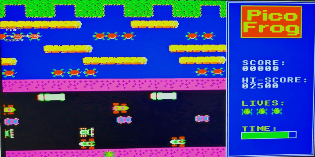

Something I ve been working on last year:
'Pico Frog
' by Martin Herhaus 2022
' This is a Frogger game that is similar to the original arcade version
' released by Konami (c) in 1981, but completely rewritten in MMBasic for the
' Raspberry PicoVGA
' This code has an open source license, you can copy it, change it,
' for any purpose for commercial use or not. But these comments
' should be in you main file.
' The graphics and Music are based upon but not the original
' developed on PicoMite Version 5.07.05RC...
' runs on PicoMite Version 5.07.06
' would not run on lower Versions due to the use of
' Framebuffer, Layer and Sprites. For this, the Pico also has to run
' at 252000 KHz or higher
'Use OPTION CPUSPEED 252000 or OPTION CPUSPEED 378000
It is playable but surly can be enhanced..
I have trouble with 5.07.07RC/Beta with the Game-Controller Routines but maybe Tom can fix it
PicoFrog.zip
Edited 2023-04-18 16:26 by Martin H.
'no comment
Posts: 6227
Posted: 06:50am 18 Apr 2023
Wauw Martin, this is great !!! So near to the actual game. A marvel !!

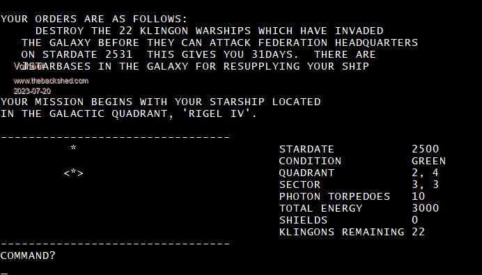

I'm currently attempting a port of Super Star Trek and it's looking promising, although rather buggy at the moment. Might do something a bit graphical with it later.

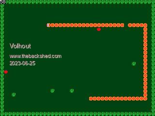

Comming to this theater soon .....

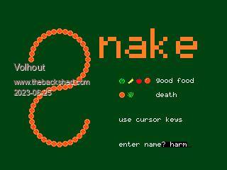

SNAKE for Picomite VGA
In this game you control a snake (more a caterpillar with uncontrolled appetite) through a grass field, where fruit falls from the trees. The snake, ever hungry, eats all there is. Also thorny bushes, or even itself. Needless to say that these last 2 hurt him to death.
The game is progressive, as is the music. At scores of 50 and higher it comes to its full potential... so practise a lot...
There is a high score list that registers your achievements. But in this version it only remains as long as you keep this game in memory (VAR SAVE).
The game design is driven from a similar game I wrote 40 years ago for the ORIC-1.
Initially I thought of using it as an entry in the programming competition, but I will think of something new by that time. Or become a judge... When you crunch the game it is not even 3 kbyte in size (just remove comments).
I tried to run this on MMB4W in mode 7 but that did not run, probably because the incompatibility in the sprite file. Conversion to LCD on the pico might work, but that is not my intention. Leave that to others...
Enjoy the game, and give feedback.
En list your highscore here !!!

 'intro screen
 CLS u                              'empty grass field
 'game title
 j=3*Pi/2
 For i=0 To 3*Pi Step Pi/16        'print S as a series of snake sprites
   Sprite write 1,80-40*Cos(i),(1+(i>j))*80-40*Sin(i+Pi*(i>j))
   Pause 100
 Next
 Sprite write 3,120,160            'append head
 Text 140,40,"nake",,,6,RGB(orange),u
 'legend and enter player name
 For i=4 To 7
   Sprite write i,120+i*12,110
 Next
 Sprite write 1,168,130:Sprite write 8,180,130
 Text 220,110,"good food",,,,,u
 Text 220,130,"death",,,,,u
 Text 168,165,"use cursor keys",,,,,u
 Text 168,200,"enter name  ......",,,,,u
 n$(0)=""
   a$=Inkey$
   If a$<>"" Then
     n$(0)=n$(0)+a$
     Text 240,200,n$(0),,,,,u
   EndIf
 Loop Until a$=Chr$(13)

P.S. if you press <ESC> during the game, it saves the screen to a file "game.bmp" as proof that you achieved what you claim....
P.P.S. For Tom and Martin: the music compression is very simple: the lowest frequency is 147Hz, the highest 698Hz, all notes in between are calculated from an index that is derived from the ASCII value of each character. The Bass is 1/2 tempe, the Metrum is 1/4 tempo, and the melody is 1/16 tempo. All in one ASCII string.

This is a version of the classic "STARTREK" text adventure game from 1978 that is adapted for picomite.
super_startrek_pico.zip
Enjoy...
