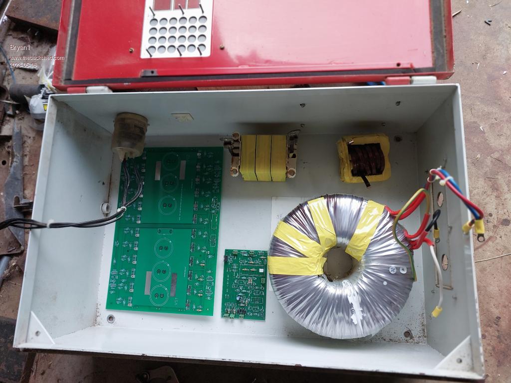

G'Day Guy's,
           Mike (Wiseguy) came up on Friday with a nice present namely a Aerosharp inverter for me to play with   When I said this will be for 24 volts Mike worked out 15 turns should do the job. Then I showed him that 6.5mmX4mm copper wire and asked if it would be suitable for the primary and for the size inverter I'm building it will do the job.

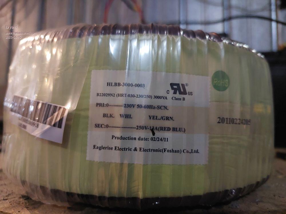

The Toroid
The name plate

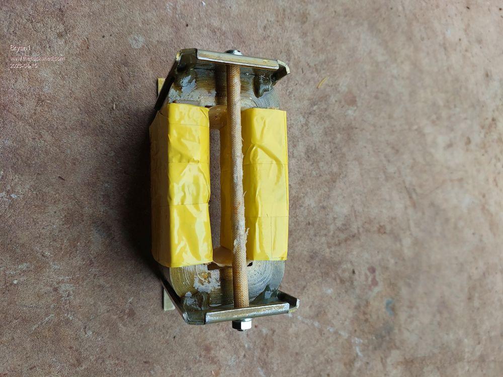

As the Aerosharp does come with 3 inductors I just had to strip the big one and put some of my tape over the insulation.
A few years ago Warpspeed (Tony) showed a sketch using this core where 4 turns each side can do both the high and low side inductors and with this wire I can get 2 in hand for the turns.

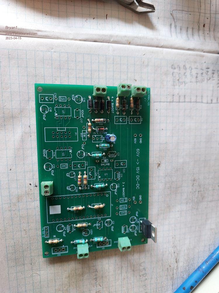

I have made a start on the Brain board and found I had every resistor bar the 51K which will need to be adjusted to suit the 24 volts so full resolution for the ADC. Where the board calls for a 60 volt to 15 volt board won't be needed for my setup so I was thinking of just using a 7815 with a few dropping diodes to ensure the 7815 stays within it's voltage limits and this can be made on some veroboard putting some pinouts to suit the pcb.

i have just built an inverter using the single aerosharp toroid.
i am also 24v.     where did you get the 15 turns from?
everything i have read on this and other forums have tought me i needed to aim for a 12v wind for 24v.     i came in at 11 turns to get 12v.

Stockleys, I agree that I have probably led Bryan a bit astray yesterday. I did a few quick off the cuff calculations to arrive at I think it was ~ 14.5T. I simply took the battery voltage (24V) nominal and multiplied it by .7071 to get the max RMS voltage capability which was 16.9V.  The 230V winding on the toroid had 197T or 1.1675 V/Turn.  Now dividing that into 16.9 gives ~ 14.5T.
But as I was considering it later the EG8010 from my experiments a few years ago could only achieve ~ 90% of max PWM modulation depth I think from memory so the result should have been closer to 13T, which I had intended to tell Brian about but your post beat me.  Also in my simple calculations I was using 230VAC as the final voltage for the 197T secondary not 240V.
I am happy for others to advise Bryan as to the best primary turns to use - I have no first hand experience at 24V.  If I was building it for myself I would be quite comfortable to start off with a 13T primary and see how it performs before reducing the primary further.

13 volts sounds about right Mike. The 8010 boards I have used specified 12 to 14 volt primary windings for 24 volt operation.

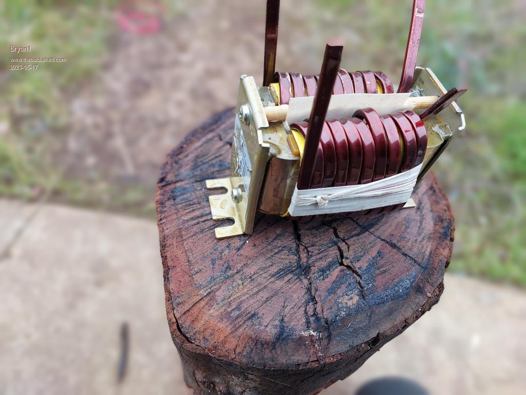

            Well been doing a lot of thinking and reading old posts particularity where the big choke out of the Aerosharp was used as the primary dual choke. The one I found was done by Tony and as I did just have enough of that enameled wire left well that first choke I made was a donor   to the cause.
So 10 turns on each side and I put some of that motor lamination sheet I had left over from my 4Kw motor conversion thru the centre to isolate each choke.
I used some of that motor tape to keep the turns nice and tight and the hunt is for some varnish as some of the wire was scored on one side giving it a sealing paint will isolate the scores
