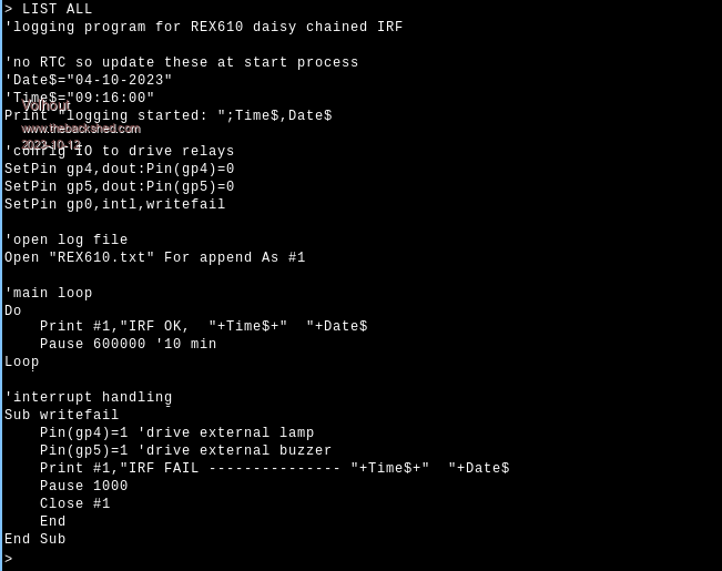

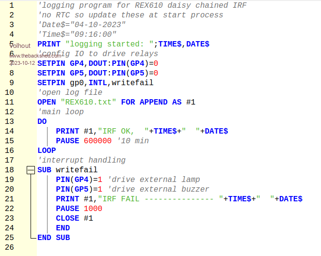

When I send a listing from a picomite to the editor (version 5.2.1) I loose the formatting. Both windows and Linux versions. The listing scrolling in the control center terminal screen looks well formatted.
Posts: 6643
Posted: 09:01pm 07 Oct 2023
  Volhout said  Jim,
That's odd.
I don't see any problems here.
Indenting is retained. Keywords will display with whatever setting you have in MMEdit but will be the same as the pico in the file.
Are you using the pico editor to modify the code before sending it to MMEdit?

Posted: 01:28pm 12 Oct 2023
Hi Jim,
Sorry for the late reply. I run Ubuntu 20.04 (same core as Mint 20.03).
1/ In direct answer to your question above. See below pictures. The listing on the MMCC screen is identical to the program as typed in the build in editor. When sending the listing to MMEdit, empty lines are lost. And (not visible in this listing) formatted comments on the same line as the command/function are loosing TAB's or <SPACE>'s between command and comment.
MMCC
MMEDIT

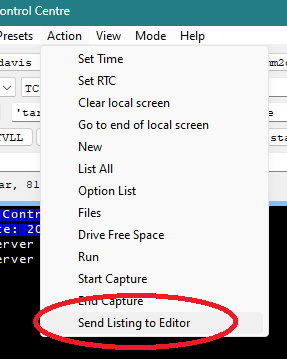

When you send from the micromite listing to the editor, a copy of the listing should be in your clipboard.
If you forget to open MMEdit before sending the listing, the copy will still be in the clipboard so you can then open the editor and a new tab then "paste" the listing. No need to go via another text editor.
Please try a "send listing to editor" and then open up your text editor and "paste" so we can see if the comment indenting is lost there.
In my image, I am using a WEBmite to connect with.
No lines or formatting are lost.
I also opened MMCC first, followed by MMEdit.
