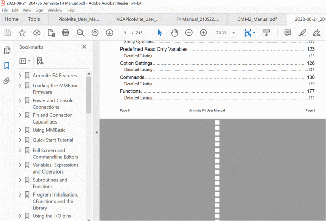

Armmite F4 User Manual
The Armmite F4 manual has been updated with details of all enhancements and contains some other improvement/corrections.(see change log section in the manual for list of changes.) The footer of each page has the page number on both the left and right margins so one will survive if the manual is printed and bound.

Firmware and Manual
The attached zip contains the 5.07.02b0 firmware, the matching Armmite F4 User Manual and the updated ARMF4CFunction.h header file.
ArmmiteF4_5.07.02betas.zip
Armmite F4 Manual.pdf
