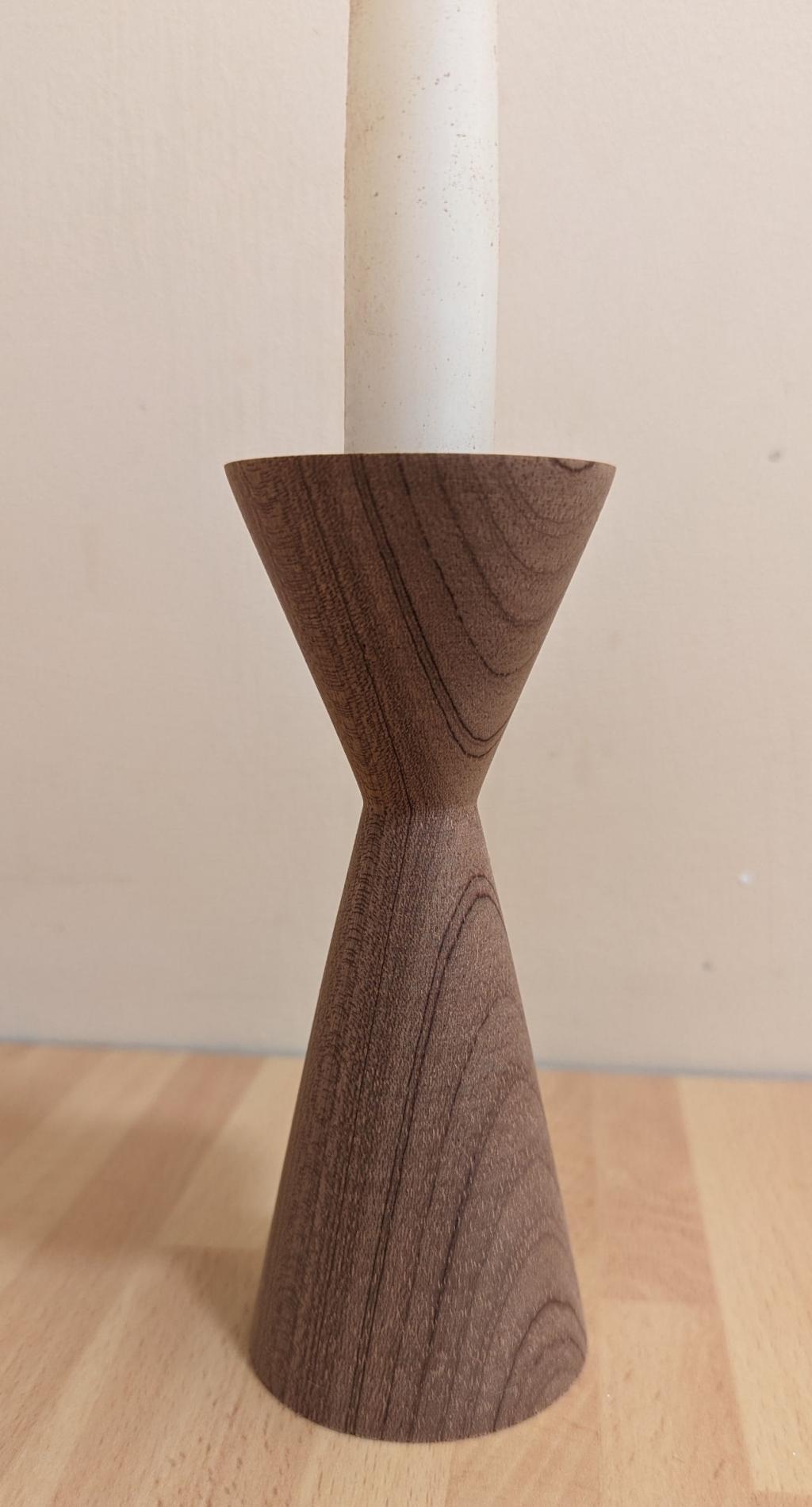

  Quote  You need to get a hobby
Got lots. Turned this earlier today (new old lathe arrived yesterday)
Posts: 4395
Posted: 07:18pm 10 Feb 2024
  matherp said
  thwill said  You need to get a hobby
Got lots. Turned this earlier today (new old lathe arrived yesterday) ...
I'm very jealous.
