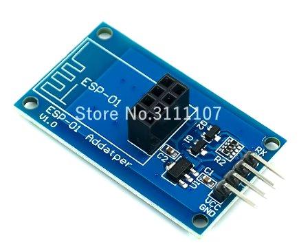

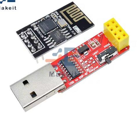

For the ESP-01S (which has no USB), I flash with this adaptor:
For Firmware Flashing
Easy to connect via serial with this adaptor:
Serial Adaptor
