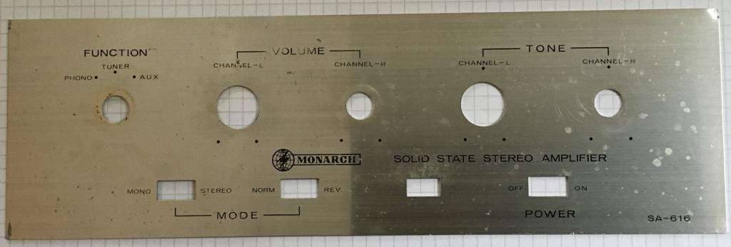

This is the old front front panel.

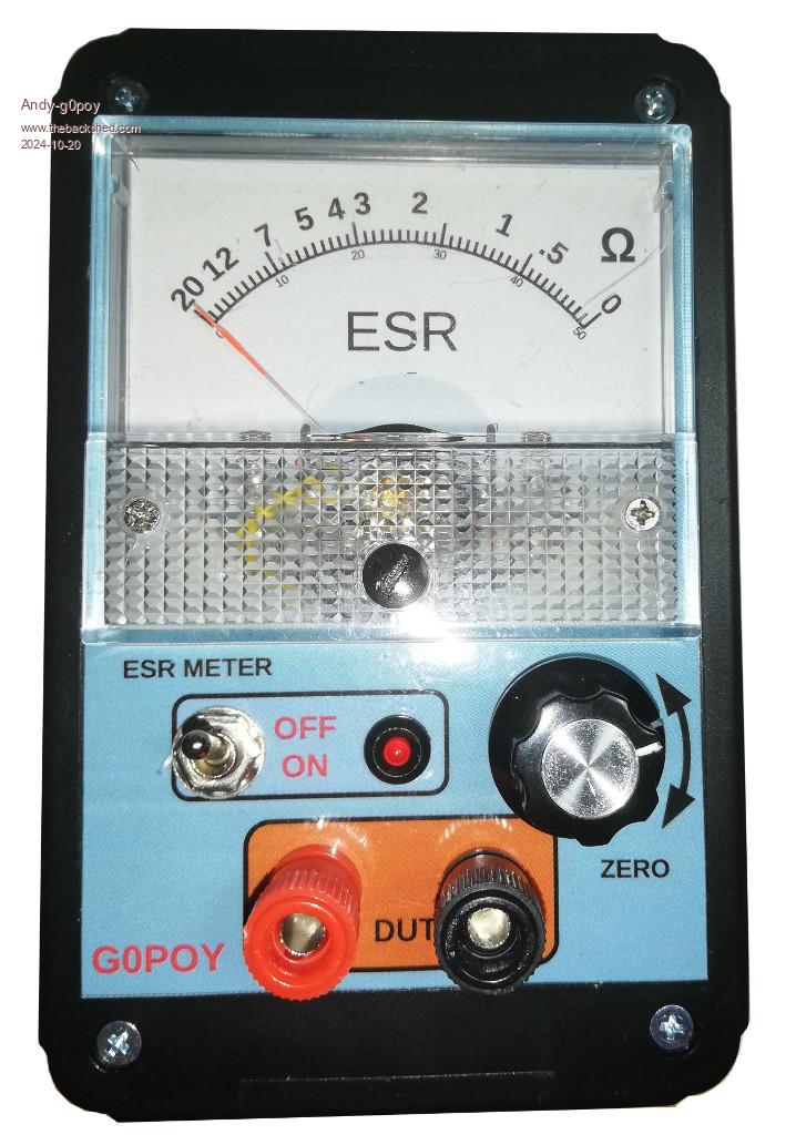

My normal method for home brew panels is to use normal printed images, and then laminate them I then glue the laminated sheet onto the panel after cutting out the holes required.
A cheap set of hollow punches does the usual holes for pots and connectors and a scalpel for the larger holes.
These is a danger of moisture getting between the laminate layers if you cut off the edge seal, which usually happens, but for internal use it's perfectly OK. If you print on a mylar sheet or OHP sheet then that is pretty much proof against moisture. Works well enough for my needs and looks OK.
The image is of a little ESR meter I built a couple of years ago. The box was a little small as usual :-)

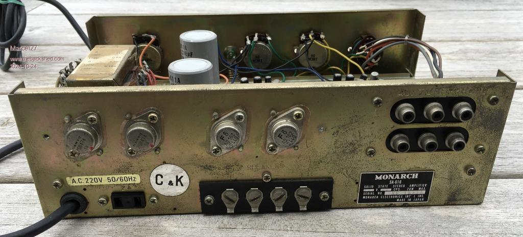

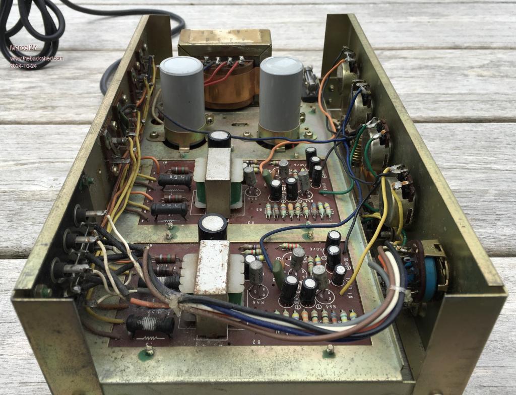

Yes, I have seen these pages. Mine looks like this before I cleaned it and protected the black resistors with new black protective lacquer. It is also possible to clean the steel case but then I have to disassemble the amplifier and soak it in BioTex soap and that is a no go for me to unsolder all the wires.

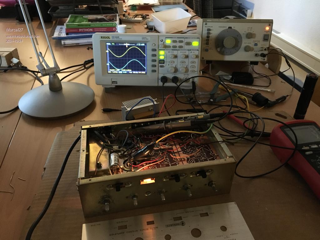

After cleaning with a damp cloth with cleaning agent, brushes and vacuum cleaner. Here for testing the output power of both channels. Sound is very good for such and old amplifier. Real "Germanium" sound. [edit]All wet capacitors measuring ESR and values within tolerance after 50 years. At that time they produced better capacitors than they do nowadays. I love it the way they handle the "stereo" volume. Just use two single potentiometers for L and R and you have also a balance.[edit]

Remarkable that the one audio channel has the 0.5 ohm resistors okay, and the other channel seems they are burned. Maybe you should check the burned channel if all resistors are okay, maybe it has a high bias current.
I love this way of construction. You remove the bottom, and have access to the whole PCB. All for service. Our government talks and talks about sustainability, durability, and we produce only consumer goods (throw away, not repair). I also have (slightly more modern) radio's that are full functioning, only potmeters needs some maintenance. And now the government decides to drop FM broadcast in 2027. I can throw this good equipment away and buy consumer goods... DAB++ radio (that probably dies in 5 years).
It is good you bring this SA-616 back alive....

Yes, that's right. One channel is indeed burned out and the previous owner/repairman put in two new germanium transistors. The photo shows two AD162 transistors next to the Japanese transistors. All resistors and capacitors have been re-measured, including the composite resistors, and everything is within tolerance. I love tolerances and they are easy to work with.    I don't do recapping because in many cases it is not necessary. Only defective components are replaced. If you are a stickler for detail with this old stuff, you make it extra difficult for yourself. This amplifier has driven my ASW Genius 300 ($$$$) speakers. After thorough inspection, I have complete confidence in this amplifier.
Yes, I think it is important to give this old stuff an extended life. It is funny that you mention about the restoration of the 1957 Phillips power supply that the potentiometer does not crackle after so many years. I also noticed the same phenomenon with this Monarch amplifier. All potentiometers were reasonably free of cracking and I could not detect any Deoxit residues that predecessors might have used. What I do with these old potentiometers is powder a small amount of silver graphite over the resistance track. That helps miraculously very well.
