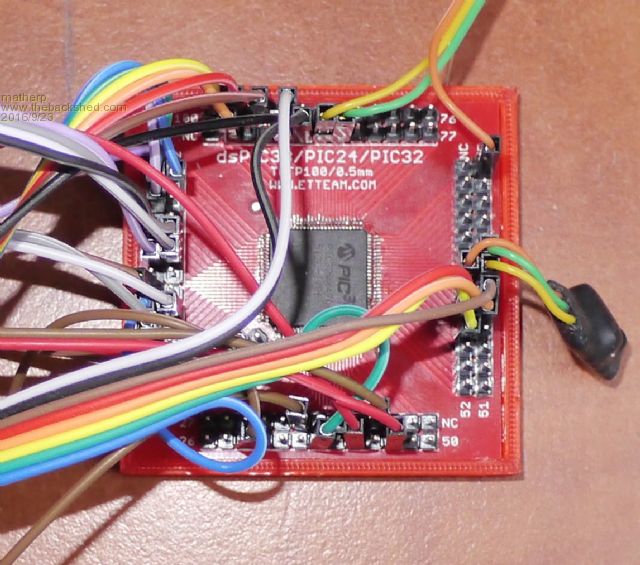

Phil23
Joined: 27/03/2016
Posts: 1667
Posted: 09:46pm 23 Sep 2016
Pure curiosity...
What's that?
Phil.

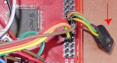

Posts: 10076
Posted: 09:53pm 23 Sep 2016
Yeah, I was eyeing that thing up myself!
I expect it is an encapsulated USB-serial converter thing that matherp may have baked at home.....
EDIT: On second thought, it is probably the 20MHz oscillator for the PIC32. I think I see what looks like a crystal outline under that heatshrink. Edited by Grogster 2016-09-25
Posts: 6632
Posted: 10:08pm 23 Sep 2016
Especially when it's connected to the oscillator pins of the MCU (RC12 and RC15).
Phil23
Joined: 27/03/2016
Posts: 1667
Posted: 10:15pm 23 Sep 2016
  Grogster said   Yeah, I was eyeing that thing up myself!
You're right!
Pins 63, 64 & 65.
Probably the oscillator & a couple of Caps going of the E100 schematic.
Phil.

Posts: 12083
Posted: 10:33pm 23 Sep 2016
  Quote  Probably the oscillator & a couple of Caps going of the E100 schematic.
Correct. The other thing needed to get the ETTEAM board going is a wire from pin-37 (AVCC) to VCC as this isn't included in the layout.

paceman
Joined: 07/10/2011
Posts: 1329
Posted: 03:06am 25 Sep 2016
Another option using the ETTEAM board, but which makes it a bit more stand-alone is shown in this old thread - see particularly photos 3&4 and the mod list after photo 4 which includes Peter's comment above. It takes a bit of fiddling but it works. Note though that this was using an MX795 Maximite chip not the MX470 so make sure if you do it that you use the correct MX470 pins Peter gives.

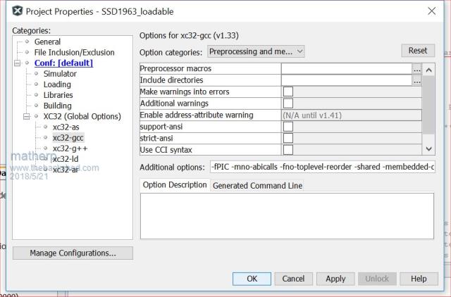

I am trying to compile 2016-09-24_082157_SSD1963_loadable.zip source C file using MPlabx following the CFunctions tutorials given by matherp.
The pre-compiled version works without fault as expected, but MY compiled version doesn't give the console message correctly when processor rebooted. It puts to the console many CHR$(156) 'a "Y" with 2 dots above it' in a row , any Ideas???
I wonder if I missed a setting or something or as it is fairly old code has there been some changes I don't know about?
Trevor

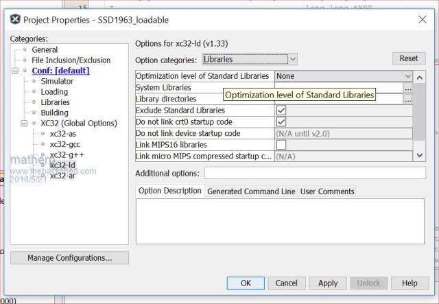

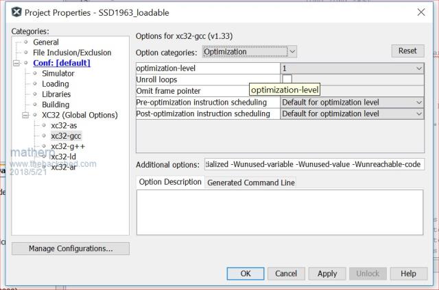

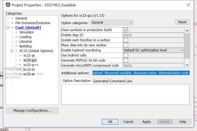

Posts: 12083
Posted: 01:31pm 21 May 2018
  Quote  I wonder if I missed a setting or something
Things to check
You must use XC32 V1.33
Additional compile options must be:
-fPIC -mno-abicalls -fno-toplevel-reorder -shared -membedded-data -mno-long-calls -fno-jump-tables -mno-jals -mgpopt -Wuninitialized -Wunused-variable -Wunused-value -Wunreachable-code
Optimisation set to 1
All other setting as below - check loader options carefully
TrevorH
Joined: 06/04/2018
Posts: 145
Posted: 03:17pm 21 May 2018
  Quote  You must use XC32 V1.33
I am using these versions but only using "-fPIC -mno-abicalls" in options and optimization set to 1.
Will try extra settings, many Thanks in advance.
