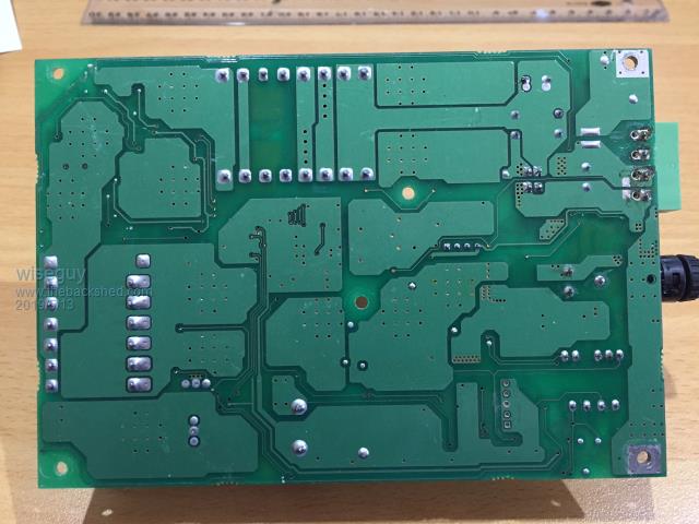

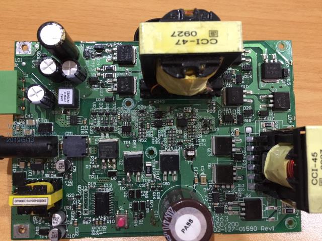

I bit the bullet a long while ago, below is a picture of one of my last power design before I semi-retired.
It was a rail 200W power supply input range 53 - 140VDC with no heat sinking required at all, efficiency worst case ~ 93% at full load. Galvanically isolated, uC supervised, output current overload shutdown auto restart.
Can I have my training wheels removed now
My latest stuff uses 0603 & 0402s - and I really hate it when I have to build the prototypes! I was considering other home constructors as well as myself in my design approach, I do have hot air gear at home - but I might try Marks frying pan trick.....
PS last week I picked up an "empty" plastic bag to put some parts in - a closer inspection revealed ~ 50 x 0402 resistors held by static electricity at random places across the internals - they were near as dammit invisible to my old eyes.Edited by wiseguy 2019-05-14

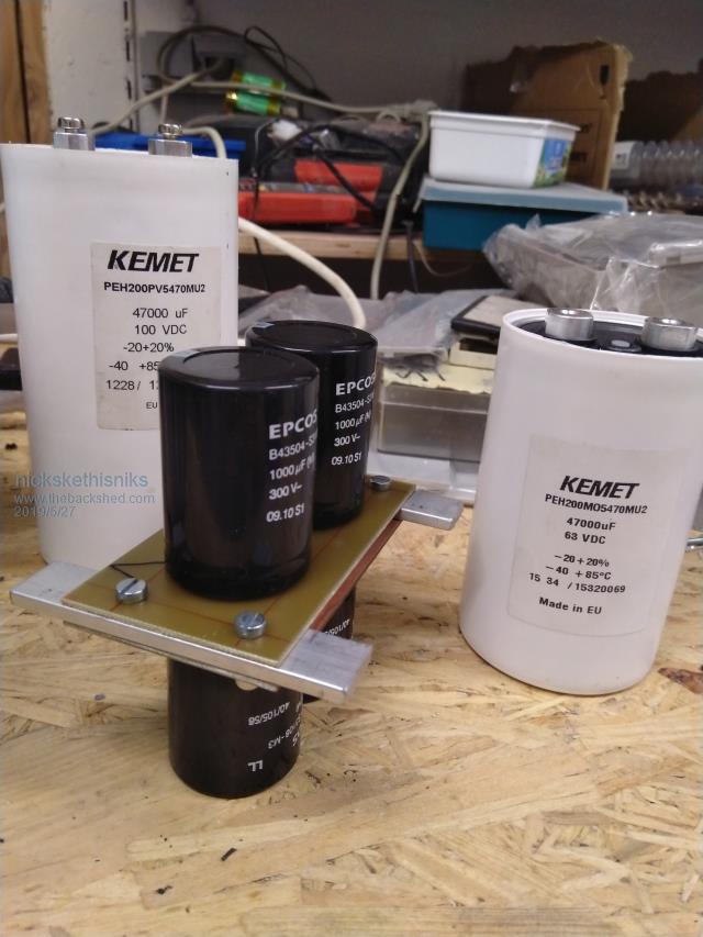

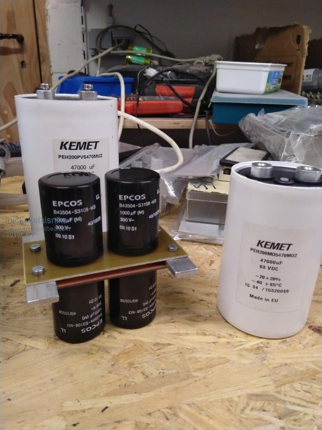

Another idea for those that can't use the big elco's and maybe want to use a lot of cheaper smaller elco's. It's easy to use small pcb's like 10cm*10cm that are verry cheap at the moment. Or use the pcb's with a copper layer and carve the tracks, there are just 2.
You can cascade this verry easily to have a big bufferbank.
The aluminium bar could be a 90° angle profile, so you can make a lot of easy connections. It's more difficult with a flat bar to make tap the current. You need a good thickness to avoid the elco pins touching.
Posted: 09:28am 27 May 2019
Clever idea but it would require a lot more room for the 47 capacitors to make up the same capacity as the one single Kemet cap shown in the picture
Perhaps OK for a test rig that requires a big capacitor and heaps of smaller ones clutter up the junk box, waiting to be used .
But for a warpinverter even more space for the 100,000+ uF capacitor is required.
All considered, the $AU38.50 I paid for each of my 33,000uf/100V caps is not too bad. These are big (75mm x 200mm) but a lot easier to fit into the inverter enclosure.
A warpinverter with its 4 transformers, up to a dozen PCB's, 32 HY4008's (for mine) and lots of other parts could hardly be considered a budget project. Especially if one was to do a 'proper job' to make something that works reliably for many years.

  Tinker said   Clever idea but it would require a lot more room for the 47 capacitors to make up the same capacity as the one single Kemet cap shown in the picture
I agree with Klaus. At least start out with a couple of decent quality low ESR capacitors and see how that goes. Its not going to blow up on the launch pad if the electrolytics wimp out!
Same with the mosfets. You can start with four very basic low power bridges to get it working initially. Then build a bigger one for the large #1 inverter. That can eventually become #2 when you build a real monster inverter for the final #1.
It can be built in stages and upgraded. Only the four transformers need to be full size right from the start.
If the dc supply ends up all noisy and horrible, its a problem that can be fixed with a capacitor upgrade. Get it up and running first, and see if the sine wave and dc supply both remain clean. The stiffer you can make the dc supply, the more immune to waveform distortion the Warpverter is going to be with really nasty loads.
