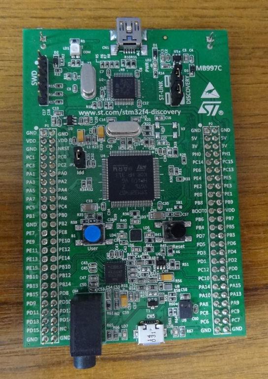

I've have this discovery board sitting idle: it has the -VGT6 version of the chip rather than the -VET6 one - as far as I can see it's the same chip except that it has 1024kb of on-chip Flash rather than 512kb.
Any chance this would work with Armmite F4?

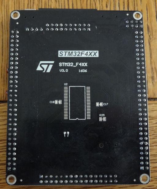

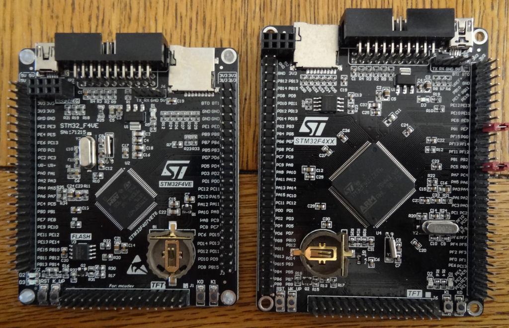

I ordered two of the same board from Banggood and they arrived today, but as you can see, they messed up and sent me two different boards.
The header pins were badly bent in shipping, but I straightened most of them out before taking the photo.
The larger board also has pads for a chip (RAM ?) to be soldered on the back.
I also ordered a couple of the displays to go with them (they're both the same).  I was looking for some displays with female connectors to dock straight onto the STM board, but the cheap ones on Banggood and Ebay all seem to come with male headers, so I'll need a female-to-female ribbon cable or similar to connect them.  Maybe an old IDE hard disk connecting ribbon would work?
I shall experiment with the boards and let you know if I can get either/neither/both of them to run Peter's firmware.
Edit to add: Both boards accepted the firmware.  Thanks to Peter for his very clear instructions in the O.P. of this thread.  Both boards report the same memory (144K Flash, 114K RAM).
The larger board has BT1 and BT0 swapped side-to-side and "moved up" one pin (there are only two 3.3V pins above them not four).  Also, although there is a GND adjacent to BT0, the pin on the side adjacent to BT1 is now VREF+, so you have to use a jumper lead rather than a link to connect it to GND for the first stage of flashing.
I've equipped them both with CR 1220 batteries and set the time/date.  Next I'll add the displays.
I'm thinking of designing and 3D-printing some kind of case/mount to hold the smaller (standard) board and standard small display.  I'll upload the design here once I've tested it.
Edited 2019-10-02 02:24 by ceptimus
Posts: 11971
Posted: 06:04pm 01 Oct 2019
  Quote  Next I'll add the displays.
The smaller PCB is the ciorrect version and should work fine. However for the bigger.....
The MMbasic firmware uses physical pin numbers to protect reserved pins from normal MMbasic operations like initialising the pins state on boot. I'm pretty sure the display won't work on the bigger screen and you may find things like SDcard don't work either. Pin mappings will be all over the place and even using SETPIN PB6 etc won't work as that also maps through the pin number table.
Edited 2019-10-02 04:05 by matherp
ceptimus
Joined: 05/07/2019
Posts: 130
Posted: 10:43pm 01 Oct 2019
Thanks.  My displays are both ILI9341 3.2-inch 320x240 with 34 pins and a (full size) SD card interface. This one:
I figured out the the connections and hooked it up to the smaller STM32 board with a bunch of 10cm female-to-female jumper wires. Calibrated the touch, and the GUI test delivers 1171 circles per second.
The backlight command works but higher numbers give a dimmer display - is that the same as with the correct pin-out display module that plugs straight on?
I'll look into the larger board and see if I can figure out how the pins are arranged.  I suppose I could complain to BangGood and see if they'll send me another small board for free to correct their mistake, but I won't be sending the bigger one back if I have to pay the shipping - that would cost me more than just buying another small board outright!
