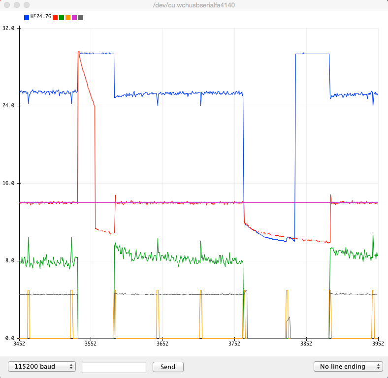

Work on the firmware progresses.
Here is the result so far:
Blue is Vin
Red is Vout
Red/Magenta/whatever is Battery setpoint
Green is power input
Grey is PWM, where max PWM is 8.0 (i.e. PWM/100)
Yellow is an indication of when max power scan occurs.
This is a nice thing to see.
Firstly, on the left there is a steady state, where the code is maintaining the required battery voltage (14V) There is a bit of up and down of the output voltage.
Probably not helped at all by the noisy inputs for the control system.
Then I disconnect the battery.
This happened to the left a bit of 3552 on the X axis.
Immediately the output rises to Vin. This might be a problem..
Then the output drops slowly due to the Vout voltage divider resistors.
I then reconnect the battry. All good.
This happens a bit after 3553.
Then the firmware starts to apply power and it tracks back to the set point.
I then disconnect Vin (i.e. solar array input) and then reconnect.
This happened just after 3752 on the X axis.
It takes one max power search cycle to have the system running back as we want, tracking the battery voltage set point.
This is the kind of robust behavior I want to see.
Marginal cases of loads causing the battery to drop a little or a bit more below the set point do not upset the steady tracking.
This is a good start point for the firmware.
Edited 2020-05-09 18:45 by poida
renewableMark
Joined: 09/12/2017
Posts: 1679
Posted: 11:54am 09 May 2020
  poida said  ..........
Nice! Almost Mark proof.

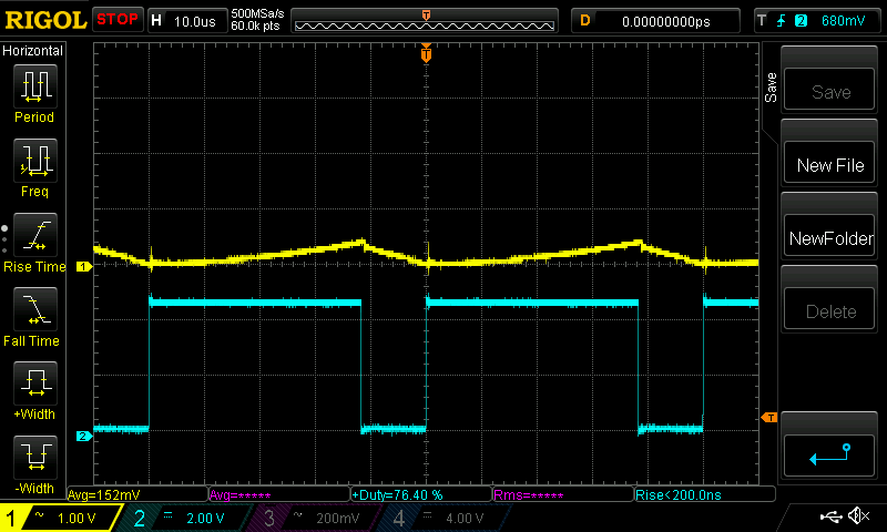

We have large capacitor arrays on both the input and the output of the controller.
These will slow down the response to any change in pwm.
I have found that the delay values in the above code work well with the capacitors I used. 9 x 450uF on the input and 5 x 450uF on the output.
Maybe some people will think "well, I can fit 9 x 10,000uF on the input. And it will be better, eh!"
I think not. The huge capacitor bank will now not change quickly enough to the new pwm setting when set within the search loop such that the search action will become meaningless.
I think I would like us to settle on capacitor bank sizes and stick with them throughout the development process. Otherwise I would end up writing and rewriting code to suit all the different cap bank sizes and probably achieve very little.
This buck converter runs at 20kHz and the cap bank size is quite adequate for the task. I have seen the output voltage ripple under 45A output and it's only about 0.3V
See the below DSO (40A out, 41V out)
Yellow is Vout
Light Blue is PWM
0.3V on 41V output is not a lot to be worried about.
Can I have agreement we stick with 5 x 450uF on the output and 9 x 450uF on the input?
Edited 2020-05-10 16:58 by poida
Solar Mike
Joined: 08/02/2015
Posts: 1255
Posted: 09:43am 10 May 2020
Looks good Poida, those caps seem ok, if you stick to 20Khz and 100 odd volts input, 48v output. Change the voltages, frequency, output ripple and inductance and they all change. You are correct in that having too much output caps versus inductance the voltage feedback time constant gets very long, especially with light loads.
On my designs I don't measure the PV input current, all I care about is adjusting the pwm for max charge current during the bulk phase, concurrently monitoring the battery voltage; 20Khz is pretty low, a higher freq means smaller inductor required, but then pcb layout and mosfet driving require tighter control.
Mike

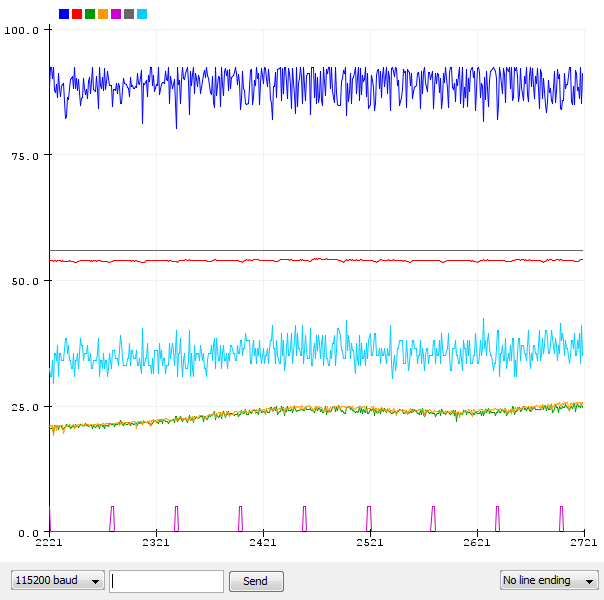

..for those who want to see data:
Blue is vin
Grey is battery setpoint
Red is vout
Light Blue is PWM
Orange is Power input
Green is power output (the difference is the loss of the dc-dc conversion process
Purple is when a max power scan occurs.
There is a large variance in the pwm and Vin (which follows of course)
I will spend some time looking at the closed loop MPPT code and how it relates to this variance.
The Morningstar does not do this. It's output is much more smoother.
