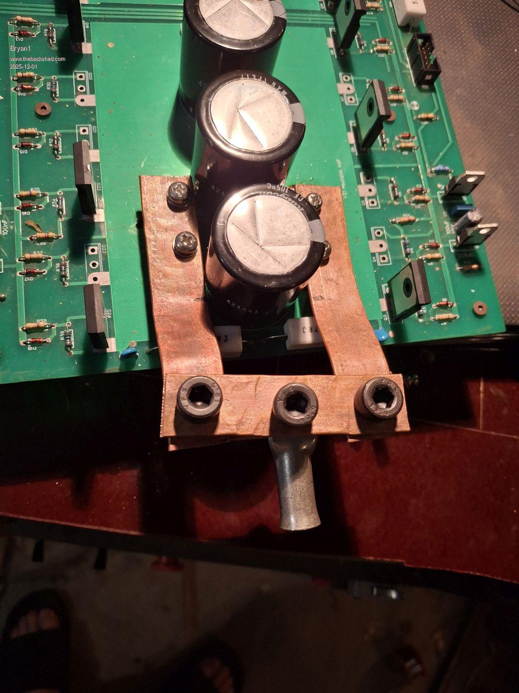

Well spent some time in the shed tonight and got the VS1 connection done
Gotta say it was a bit of fun soldering on the pads and finally worked out the best way to get a good joint now got a single 18x3 copper plate (squashed from 1/2" pipe) coming out from each pad then on plate top and bottom to clamp the choke cable.
I am going to need to flatten more 1/2" pipe for doing the battery connection as there won't be enough from what I did.
Tomorrow night I'll get VS2 done then I can size the choke cables then take then to work to get the lugs on.
So slowly getting there.
Regards Brayn

Posted: 07:44am 02 Dec 2025
Well I scrathed the idea of using those M4 seats as the last thing I need is a joint failure when drawing 4Kw or more and on talking with the sparkie at work I came home with 4 off 50sqmm 150mm long with 10mm lugs on one end.
So got the seats off the pad and my trusty solder sucker copped a beating   and used some Bakers soldering flux to help tin the end, used my fine blow torch and got a solid wire as I did use my mini hacksaw to true up the end.
Anyway my old soldering irons my dad me had seen better days so as Roger did show me his heavy duty soldering iron I do think it's best to use that. Anyway as I was told bakers soldering flux is a big NO NO and with the 50sqmm wire being 150mm long there is plenty of green as the idea when the wire comes off the board it's going down to make the connection with the choke.
So got Saturday arvo planned with Roger where all the heavy wire can get done correctly then not far away from doing the first test.
Regards Bryan
