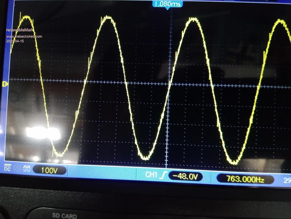

Posted: 10:43am 15 Apr 2020
This is what mine looks like with a weak DC supply.
That's not your problem, something is busted big time.

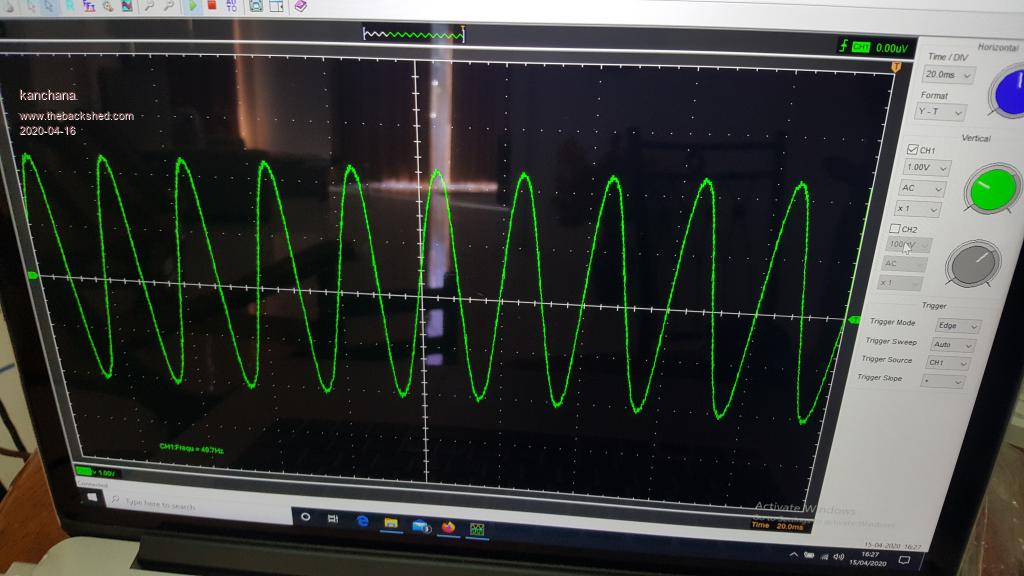

Posted: 02:31pm 15 Apr 2020
Again I found there was power negative disconnected from one module , connected it got a nice sine wave .
But now when i tried to connect some electrolytes and power with PSU , it pulses on and off trying to startup . probably 5A current from PSU is not enough to start up. Tomorrow will connect it to a large battery bank . hopefully noting will blow up
Regards kanchana
Posted: 09:01pm 15 Apr 2020
That is a very nice sine wave Kanchana, well done

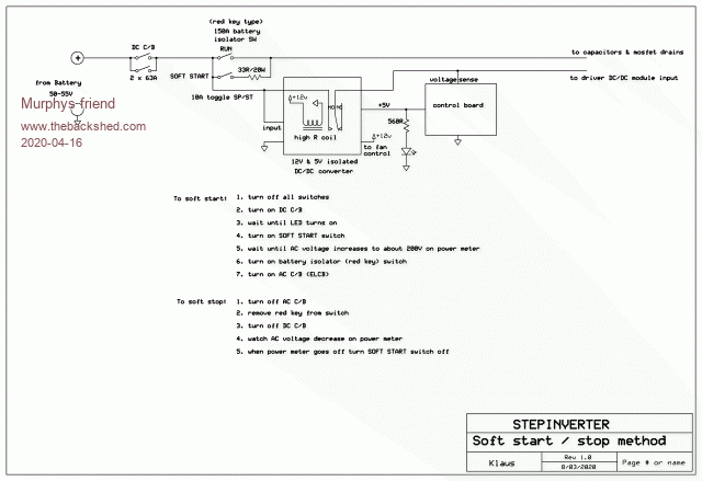

Posted: 10:15am 16 Apr 2020
Hi Kanchana, I have permission from 'klaus' to help you with the inverter startup troubles.
Wire the power to it as per attached schematic and follow instructions on it. You do *not* need a boosted driver supply if you do that.
Good luck
Murphy's friend
Joined: 04/10/2019
Posts: 678
Posted: 10:26am 16 Apr 2020
Further to the above schematic, the little 5V DC/DC converter on warps board has been removed and the 5V supply to the board are as shown above.

Posted: 01:36pm 16 Apr 2020
Thanks Murphy's friend, So I need 2 DC to Dc converters 12v and 5v 12v to drive the relay and fans and 5v to supply the controller board
Regards kanchana
Murphy's friend
Joined: 04/10/2019
Posts: 678
Posted: 02:31pm 16 Apr 2020
  kanchana said  Thanks Murphy's friend, So I need 2 DC to Dc converters 12v and 5v 12v to drive the relay and fans and 5v to supply the controller board
What klaus uses is one 50+V to 12V *isolated* DC/DC converter(~2A), supplying 12V for the fans and 12V power to another little buck converter (can be non isolated, about 30v input, output adjustable to 5V ebay special). This then provides the 5V for the control board hence the DC/DC on that board is not required.
Note, doing that separates the battery voltage sensing from the control boards 5V rail.
Patience is required after following the slow start instructions, it can take 10 seconds for the LED to  light and a further 10 or more seconds for the AC to rise to the required voltage level.
This slow starting ensures even a small power supply can start & run this inverter which has an idle current of less than 0.5A from the supply set at 55VDC.
Any AC load depends, of course, on what that power supply can offer.

Murphy's friend
Joined: 04/10/2019
Posts: 678
Posted: 10:34am 17 Apr 2020
a few more observations for kanchana.
The 5VDC could be also from an ordinary 5V regulator, it most likely would not even need a heat sink since the control board electronics consume so little power. Klaus says he used what was on hand.
The important bit is the relay, it ensures that all 16 little DC/DC driver supplies start up at once from the 50+ battery voltage. If they were to be powered from the capacitor rail they would randomly start up as the capacitor voltage rises on start  up.
Since that relay is on during the whole time the inverter is running one with very low coil power (high resistance) is a good idea.
Since the 12V relay is powered from the isolated DC/DC module it only closes after the 5V to the control board are established and that board is up and running.
So, when the  relay closes all the drivers are going with the correct wave forms present at the mosfet gates.
But nothing happens at the transformers yet as the large capacitors have no charge yet.
Initiating their charging by the 'slow start' switch ramps up the AC slowly at the capacitor charging rate, very nice to observe that on the oscilloscope.
It is therefore *very* important that there is *no* remaining charge in the big caps for a smooth soft start.
If the inverter is shut down exactly as noted on the schematic above the capacitors are discharged by the inverter's electronics.
Again, very interesting to observe this on a CRO, the AC wave form is stable and clean to well below 10VDC at the caps.
Lastly, the 'red' battery isolator switch was chosen because it can handle 150Amps when closed and it was cheap. BUT, it is only rated for 24VDC or so and switching any power at 50VDC would most likely weld the contacts together.
So, it is *very* important that this switch only switches the <0.5 Amps power for the electronics when it it opens or closes - all the AC load MUST be off to ensure that.
Never use that switch to turn off the inverter under load, that is what the DC & AC circuit breakers are there for.
