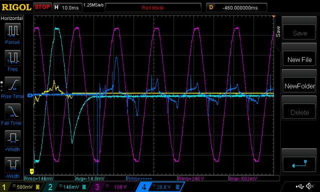

Today I show voltage and current waveforms of the change over street to inverter and inverter to street.
Some change over events occur when street AC phase is close to inverter AC phase.
Other events occurred when they were 180 deg different.
I was interested in phase matching the inverter to street AC prior to change over but my experience has shown this is not vital for inverter (&/or household equipment) health.
Yellow is inverter current
Light Blue is inverter voltage
Pink is street voltage
Dark Blue is street current
Both current and voltage scales are similar, i.e. comparable.
This is inverter -> street under light load (200W ish)
Phases are close

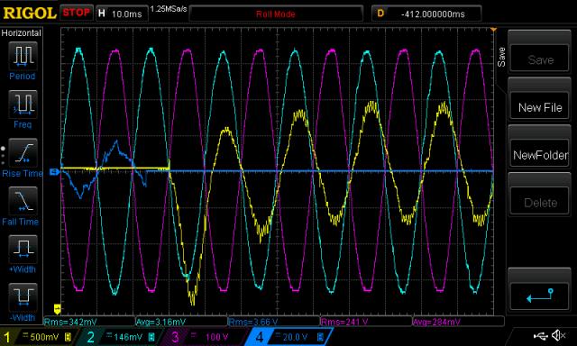

Here is a changeover, street -> inverter
180 deg phase diff.
Whoa, dude. This event was accompanied by a loud hum generated by the
inverter. This hum dies out after a minute or so.

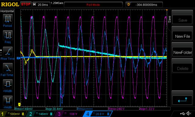

here is inverter - street, same loads as above.
Even the street current is large for a few cycles, then it reduces to
normal. Same vertical scales, note.

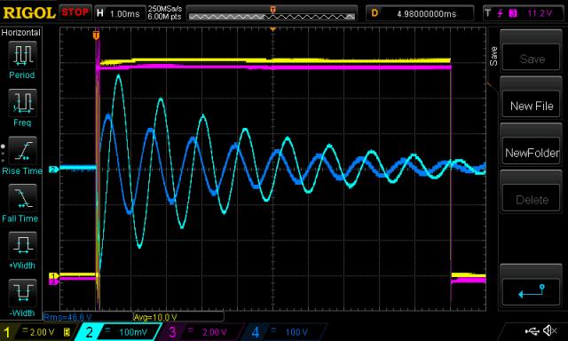

Earlier this week Tinyt was looking at the EG8010 startup. When power is applied, the chip outputs 3 pulses at the 23.4 kHz and stops with both outputs of the full bridge pulled to ground. It injects a quick pulse of energy, which excites the resonance of the LC tank circuit (also known as the toriod transformer, series inductor on the primary winding and the capacitor across the 240V output winding)
Here is an example, using the 1.95uF cap.
The dark Blue is the 240V secondary voltage. You can easily see the clean oscillation
resulting from the short pulse of energy injected into the tank.
Light Blue is primary winding current.
Yellow is SPWM gate drive.
Pink is 50 Hz gate drive.
I tried 4 different capacitors and here are the results.
6.45uF gave 461 Hz
1.95uF gave 838 Hz
0.99uf gave 1,180 Hz
0.47uF gave 1,773 Hz

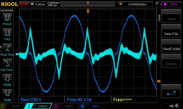

Part 23 examining output waveform shape as SPWM varies and as AC output frequency varies

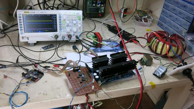

Up until now, we have built and played with inverters that use a constant
SPWM frequency. This is 23.4 kHz when we use the EG8010.
My prototype runs at a nominal 20 kHz.
Also, our inverters output AC at 50 Hz.
I modified the Arduino code to permit any SPWM frequency from about 5kHz up to 40kHz,
controlled by a potentiometer. I can change the SPWM frequency while the inverter is running under load, to examine the AC output waveform or primary winding current.
I also run code modified to allow the control of the AC output frequency, varying
anywhere from 40Hz to 100Hz.
I wanted to see how the SPWM filtering went as the frequency was varied.
I expected to find some frequency or other which made the inverter go bananas,
causing bad things to occur.
I have two versions of inverter program running on the Arduino.
Version 1 is just like that which runs on the EG8010, it produces a 50Hz fundamental output on one channel and
a 20kHz SPWM output on the other channel.
Version 2 instead makes a nominal 20kHz sine wave PWM on both channels, one being 180 degrees out of phase to the other. When you feed these two outputs into a transformer, you get the difference which is of course a sine wave.
This version has a soft start and a soft stop.
I use version 2 in these experiments since it requires twice as many PWM switch events per second compared with version 1, and so it is feeding 2x as much high frequency energy into the transformer/choke/filter system as well.
The test conditions are:
27.4 V DC supply
1.95uF filter cap on the secondary
1500VA Aerosharp toriod (0.7 VRMS /turn) with 18 turns on primary, 335 turns on secondary
46uH E core ferrite choke with an air gap (non saturating at my test currents)
no load on secondary.
— No mosfets were harmed in the production of these videos —

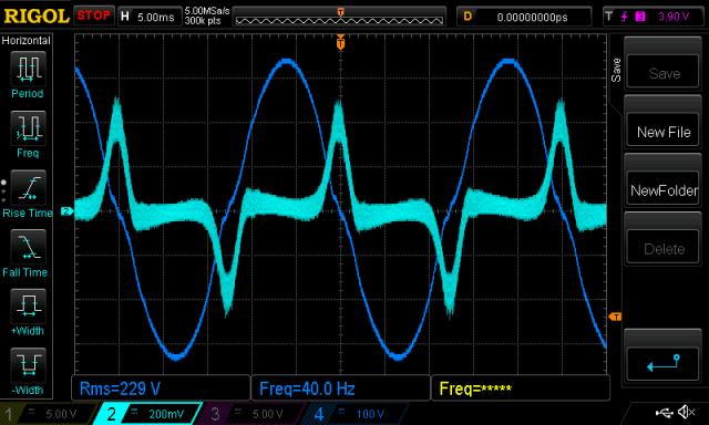

Next I vary the AC output frequency by hand via the pot.
The fat trace is primary current (“light blue” but the camera has no exposure control in movie mode..)
video 2
At around 40 Hz things are clearly unhappy. Is it due to the parallel LC resonance of the toriod?
Idle current has risen to 1.0A, 3x more than normal and you can hear that things are not running well.
40 Hz with 1.95uF cap
I change the filter cap from 1.95uF to 6.45uF and try again.
No improvement or change in this bad high current condition.
It seems it's not effected by parallel LC resonance frequency - it's due to something else.
Idle currents
40Hz (1.95uF) 1.06A (6.45uf) 1.00A
50Hz 0.37A 0.51A
60Hz 0.33A 0.52A
80Hz 0.29A 0.64A

The setup:

It sounds to me as though your toroid is beginning to head towards saturation as you lower the frequency.
The flux swing in the core will be 20% higher at 40Hz than at 50Hz.
One way to test this theory, would be to lower your dc supply voltage by 20%.
Try running it at 21.9v instead of at 27.4v.
See if you can then go down to 40Hz without the current peaking above around 0.5A.
Really, forcing it down to 40Hz is rather like performing an unnatural act on it....
But its all in the interests of the learning process.
Well done Poida !Edited by Warpspeed 2018-07-09

I posted this, then went to the pool for a swim. 500m into 1500m I realised it was saturation.
I re-did the frequency test but with AC output voltage = 200 V RMS (instead of the above test using 230 V RMS)
No ugly things at 40Hz! Of course, it was saturation. Now ugly things happen at 34 Hz @ 200 V AC RMS
It's strange though, I see beginning signs of saturation when running this toroid
at 50 Hz and 230 V RMS. Not a lot but it clearly reduces as I increase frequency to 55 Hz.
