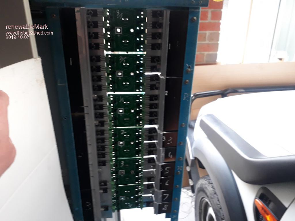

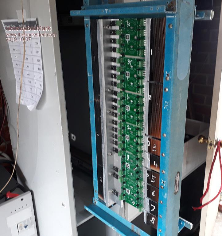

Back to this project now as the caravan inverter is all set up nicely.
Made a bit of progress.
Cheers Caveman Mark
Off grid eastern Melb
Posted: 03:22am 07 Oct 2019
That is going to be super accessible.

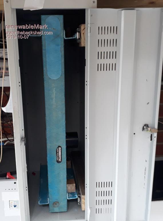

Where do the transformers go ?
renewableMark
Joined: 09/12/2017
Posts: 1679
Posted: 03:42am 07 Oct 2019
Just below, it's a 2 door locker.
I might take out the shelf between them and add some external bracing to keep it rigid.
The bottom will need some beefing up also with all the weight in there.

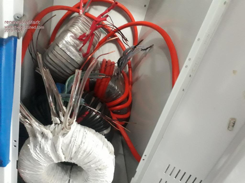

Here is is slid out, good access.
Here are the torroids just chucked in. I'll have to work out how to arrange them.
Cheers Caveman Mark
renewableMark
Joined: 09/12/2017
Posts: 1679
Posted: 07:59am 07 Oct 2019
The torroid in the front may confuse some.
I normally use black, but this one got white polyurethane (leftover from caravan repairs)
It still needs a mylar wrap.
Instead of using epoxy to glue up each layer I use polyurethane.
It sets like rubber and the final torroid is less prone to humming.
This I figure will give it a longer life as it's insulated better.
They do however hang onto a certain level of heat.
The one that runs the house in a 8kw madinverter never goes below 16c even in winter, but the heatsinks certainly do.
In winter the heatsinks in the morning may be 3c and the torroid 16c.
There is always that residual heat that gets held when using polyurethane, but once the heat does get to the outer surface, it does dissipate quite well.
Fans rarely need to come on, at least not with the loads we put on it.
Only stinker hot 40c days when both air cons are going do the fans come on.
Cheers Caveman Mark

Posted: 08:05am 07 Oct 2019
Easiest way might be a heavy steel plate with four large castors bolted underneath, and the transformers stacked vertically. That way the locker sheet metal sees none of the weight.
That is pretty much how I did mine.

Yeah, that sounds good, where it's going it will just stay put, so no need for castors, but the sub floor support seems ideal, the bottom shelf is 5cm above the ground.
The locker has held them in place fine so far, but a stronger method is wise.

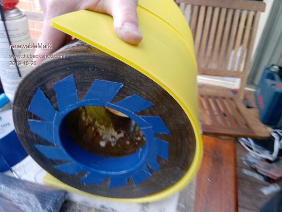

Hey Tony, with the issue of the wire being close to the torroid, could some layers of coreflute built up on the outside before winding help like this?
This stuff is meant to retain it's integrity till 85c.
Cheers Caveman Mark
Posted: 02:29am 20 Oct 2019
It should help a lot.
Try wrapping it around the outside exactly as you have in the picture, and cut out a couple of discs of similar material for top and bottom.
Nothing can be done around the inside of the hole without making the hole far too small.
I have no idea of how bad this capacitance problem actually is, Klaus seems to have vanished from the scene, and I don't really have anything here to do any realistic testing with myself.
There is no requirement for the wire to closely hug the steel toroid. Each pass through the hole counts as one full turn, no matter where in the hole it is located.
The other three quarters of each turn around the outside of the toroid, really contributes nothing except return the wire back into position for another pass through the hole.
Only slight disadvantage of doing this, is the length of each turn will increase slightly, but the effect of that is not going to be very great.

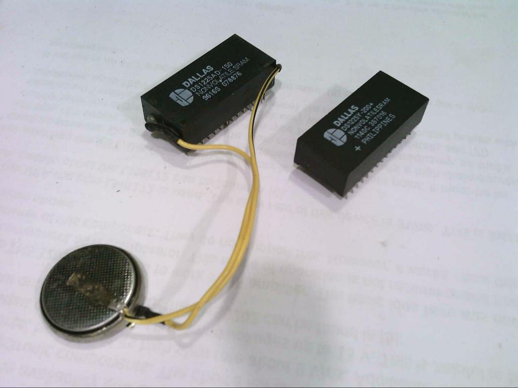

I am a bit stuck at the moment. My good Tektronix oscilloscope is not working. All of the calibration constants are held in a battery backed ram which has failed. Its not the battery that has died but the ram. I ordered another ram chip from China which did not work (bastards). So will have to order again locally before I can really do anything. Even then, I need to go through a very long and detailed re-calibration routine which looks fairly difficult as I will have to build a very accurate voltage and frequency calibration box..
In desperation I just ordered a brand new Rigol DS1054Z oscilloscope which is not going to arrive until next month. I can still see images on my cro, but have no idea of what the sweep speed or amplitude is I am looking at, as the on screen digital readouts no longer work, and the front panel knobs have no calibration marks.

Hi Tony, I have quite a few cmos ram chips floating around here, that used to be in old microbee computers with battery backed dc to hold the memory.
What is the chip, I may have some.
Mike
Posted: 02:59am 20 Oct 2019
Its one of those Dallas battery backed rams with the built in battery DS1225.
What is really interesting, is that the original Tektronix Dallas part has a large external 3v lithium cell dangling from it, which is still at fully +3v. I have never seen a Dallas chip like that before.
The Chinese replacement is the much more usual fully self contained black block, with the ten year rated battery inside. The Chinese one has some random data inside that I can read, but not write to, so its useless. Its also 200nS where the original was 150nS speed rated.
The DS1225 is 8K x 8 and the pinout equivalent of a 28C64 ram or 27C64 eprom. I will probably burn an eprom for it once I get it going again, so the battery will no longer be a problem that can ever return.

Don't know how feasible it would be, but how about wrapping the primary on first, then the secondary?
Would that help with the capacitance issue?

Its always going to be neater and much easier to wind if the thinner wire goes on first, and the lumpiest winding with fewer turns goes on last. Primary or secondary does not change that. The higher voltage winding always goes on first for the neatest result.
I cannot see that would really help us with this problem. A toroid is the very worst way to wind a high frequency transformer where there are a very large number of turns and the core is highly conductive material (like steel). Much lower capacitance will result with ferrite or something much less electrically conductive.
About the best we can do is provide some physical separation between the core and  the higher voltage winding and whatever goes on top of it. That is half the problem.
The other half of the problem is the transformer step up ratio needed to drive the secondary. The greater the voltage step up ratio, the harder the primary will be to drive, requiring a higher current.

The hole is 100mm (circumference ~314mm), and 25 turns of 1.8mm will take up at least 50mm. So fitting on 14 individual windings is going to be messy with wires poking out all over the place.
A better solution IMHO might be to wrap a bunch of 14 strands around 25 times without twisting the wires together.
Start in the middle and wrap thirteen turns around just less than 180 degrees of the toroid one way, then the other twelve turns around the other half.
That will produce a flatter winding with only two ends coming out in roughly the same place.
Sort of looking like this:
Then add a super super super thick layer of insulation.
And finally the high voltage secondary on last.
That would have the advantage of having nothing on top of the secondary, and that should reduce the capacitance significantly.
