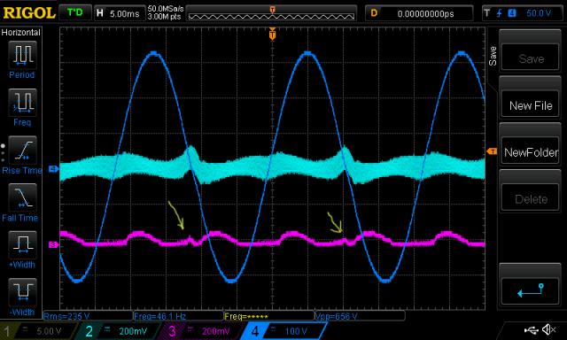

Posted: 06:45am 09 Jul 2018
Warpspeed,
the transformer is a 1500VA Aerosharp.
I measured it at 0.715 V AC RMS/turn at 230 V AC RMS on the secondary winding.
It has a label on it, with the secondary rated at 230V and 4.3A.
The primary winding is not much use to me, it's marked as
93V 50/60Hz....
So I suppose it's good for 50Hz. At about 235V RMS it shows clear signs
of saturation at 46Hz.

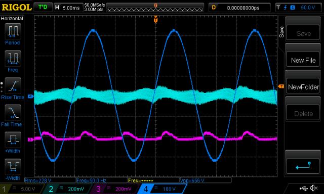

I found a good way to see when saturation is/isn't.
I place a current sensor on the DC supply and watch for the peaks
to appear that correspond to the AC voltage zero crossing.
I can get it to about 1/2 Hz.
pink trace is DC supply current
light Blue is primary current
dark Blue is AC output voltage
no saturation:
arrows show the beginnings of saturation:

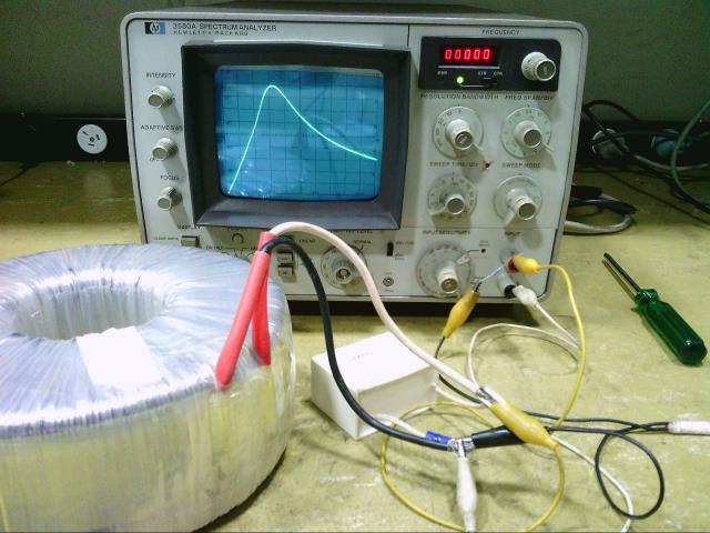

I just went out to the shed and grabbed an inspire toroid which only has the 130v primary winding on it, and a 5uF. Quickly measured it with a multimeter and a 1K series resistor at 20Hz intervals.
I had no idea where the peak was going to end up...
20Hz 258mV
40Hz 659mV
60Hz 977mV
80Hz 863mV
100Hz 706mV
120Hz 585mV
140Hz 493mV
160Hz 424mV
180Hz 368mV
200Hz 323mV
Looked at the whole thing on my brand new (thirty+ year old) antique spectrum analyser measured the same way, 1K series resistor, 20Hz per horizontal division, linear vertical scale.
There is a clearly defined peak at about 62Hz, and its reasonably sharp too.

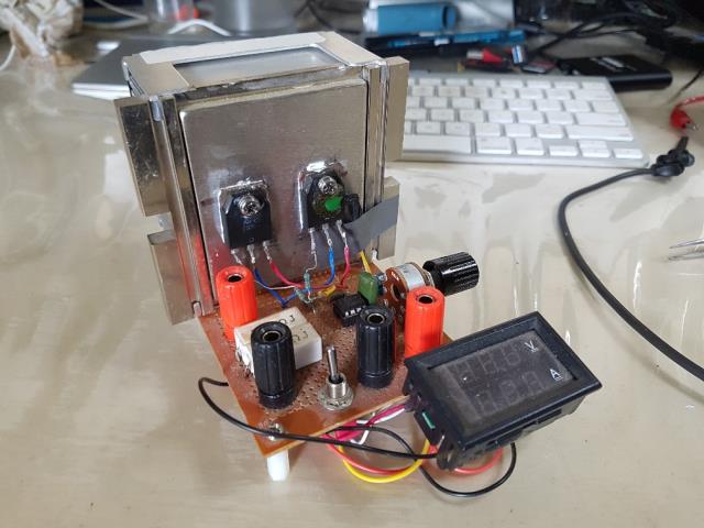

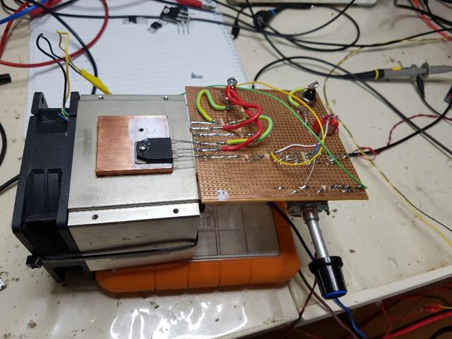

and into the heatsink.
I have built and abused, Royally, a very handy DC constant current load.
It senses drain to source current and drives the fet gates to maintain a desired DC current. 2 mosfets share the same gate drive. It works fine and I love it.
It uses NEC K3304 mosfets I pulled out of a dead plasma TV.
These are in a TO-3P package, similar to the TO-247.
This toy handles 120W continuous and 1 minute pulses over 150W with ease.
Under load the 2 K3304 fets dissipate all the heat and transfer it to the heatsink.
I have found on numerous occasions the heatsink is hotter than the front of the
TO-3P package, to my calibrated finger. Much hotter.
This is good, it shows the heat is being conducted well, away from the chip and to the back of the package.
I was wondering one day how our favourite MOSFET goes, in this situation.
So I made a test DC load, able to drive 2 mosfets with independent gate drives
that maintain the desired current.
The test load:
First, I used one gate drive for 2 mosfets but always one or the other fet would heat up and take all the load. The Gate threshold voltage is variable with these devices.
SO I built 2 current sense, gate drive circuits, to prevent one fet taking all the current.
Anyway, the Hy4008 in TO-247 package is in my experience poor at conducting heat to the heatsink. You can easily feel a hotspot appear on the front of the case, then the heat sink warms a little, then the hotspot gets hotter and hotter. Always the heatsink stayed quite a bit cooler than the front of the case.
I swapped the Hy4008 for the NEC K3304.
Immedately I could feel the heatsink get hotter BEFORE you could feel heat on the front of the case. The difference was surprising. I tested this at 30V and 2 amps in both cases.
I also have a bag of TO-220 packaged HY4008. I tried the same and got the same result
of a much hotter front of the package compared with the heatsink.
So what's all this got to do with the price of fish?
Hooyi Semiconductor provide specs for their chips and one I found interesting is
max continuous current
This is 200 A at 25Cj (at the chip junction) and
153 A at 100Cj
and max power
397W at 25Cj and
199W at 100Cj
In testing I have blown these HY4008 with as little as 5A, when attached to a heatsink. Easy, just supply 30V at 5A and that's 150W.
I did not power it for long, just 1 second, the time needed to twist the power supply current limit knob.
The TO-220 packaged HY4008 are less capable of conducting heat and break easier.
I didn't get to 5 amps before it failed.
I started it cold, with a good heat sink compound under it.
less than a second ramping it to 5 amps kills the fet with a 30V supply.
It dies well before 150W and these are rated at 173W at 100Cj.
The junction must heat up very quickly and not conduct heat to the case.
The de-rating curve shows 100W max at 130C.
I suspect Hooyi have designed these chips in a way that they have poor heat conduction from the chip junction to the case.
My views on using these in our inverters:
they are cheap.
they work.
I have no idea how they continue to work.
Do not use them unless they are fully switched ON or OFF.
When used in the saturation area, they are very weak devices.
DO NOT let them get hot.
** MOSFETS were harmed in the preparation of this article.

The front isn't conductive, would clamping a copper/aluminium bar across the front help?

Great work Poida, what gate voltage were you using?
Posted: 10:20am 21 Oct 2018
  renewableMark said   The front isn't conductive, would clamping a copper/aluminium bar across the front help?
I'm doing just that on my experimental inverter. I call it the mad bar as he came up with that idea.
Mine is 20 x 3 mm alu bar long enough to cover all the mosfets on each individual heat sink.
Perhaps Poida can try that idea with his test rig and see if it makes a difference to the front heating. It certainly does a good clamping job.
nope.
The chip is supposed to be thermally very well connected to the metal plate on the back. The idea is to use this metal plate to convey all the heat away from
the device.
I am starting to think HY4008 are not so well thermally connected to the metal plate
of the package.
