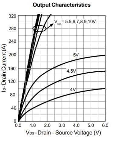

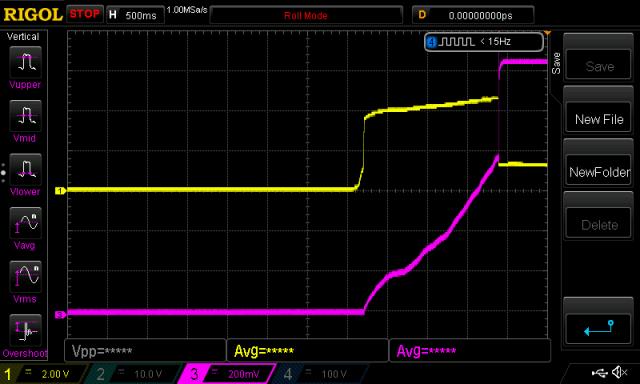

I drive the gate from an op-amp. The op-amp is taking a set point voltage, maybe 0.5V and amplifiying the difference of that with the voltage across a current sense resistor. The op-amp output is then fed to the mosfet gate.
This way you can control the current flowing through the current sense resistor and the mosfet simply from a pot.
typical gate voltages for 2 Amp with my current sense resistor and op-amp gain
are 4.2V when I am testing/breaking a HY4008 TO-220 fet.
I hooked up the DSO, to show current sense voltage and gate drive voltage.
Let's break another fet...
supply voltage is 30V, i.e. Drain - Source voltage.
Yellow is gate voltage. 2V/div
Pink is current sense voltage across a 0.22R resistor.
(0.22V = 1 amp)
The timebase is 0.5 seconds/div
You can see I drive the current from zero to about 4 amps over 3 seconds as I turn the pot.
Then the current rapidly rises to about 6 amps, the power supply max set point.
I broke the mosfet.

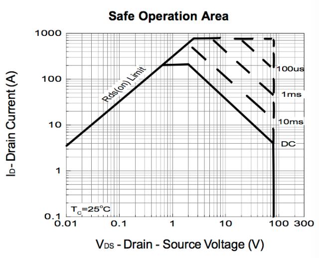

This device is specified to handle DC currents of 200A at 20Cj (junction) and 144A at 100Cj.
There is a graph showing safe operating area, which combines max volts, max amps and safe operating area.
At 30V the SOA shows I can put about 9 amps through the device.
And yet I killed it putting 3.6A through it. (0.8V / 0.22 R)

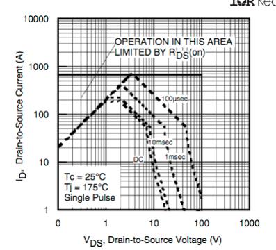

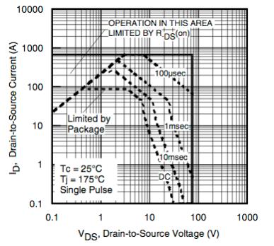

I am looking at IRFP4110 and IRFP2907 and just ordered a pair of each.
I will run both of these up to 2/3 of max current at 30V inside SOA
to see how the heat will be conducted away from the chip.
On review of the specifications - maybe I shouldn't.
4110:
2907:

I have previously thought of a fully ON test as you describe. I could hold the gate at 12V and run the house inverter supply through it, put a kettle on...
50A through 3mOhm is 7.5W (edit:whoops, not 0.15W)
I would need more current, yes?
this shows the V-I curve. Even at 260 Amps it's 1 V or 1/250 or 0.004 Ohms
At 50Amps the curve looks steeper, i.e. lower resistance.

I also understand the modern switching power MOSFET is made up of many cells on the die. And that some cells will conduct more than others during Vgs voltages in the transition zone from OFF to ON. Certainly something I need to consider.
50A through 3mOhm is 0.15W
Nearly right (V=0.15V) P = (I x I) x R so 50A & .003R = 7.5W
The 40C/W junction to ambient thermal resistance means if the MOSFET is not mounted to heatsink, the package should get about 0.15 x 40 = 6 C hotter than room temp.
I must be in error. It cant be that low. 7.5 x 40 = ~300 degrees - is that better lol
